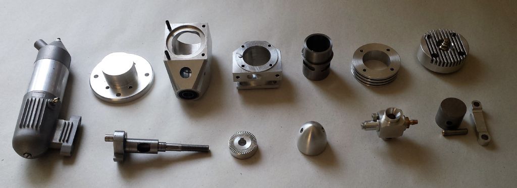

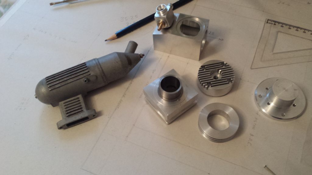

                            Hi Jason and all,
                            Returned to the firefly recently, a photo of some of the parts in the previous post. (posted before I added text, doh!!!)
                            The silencer in the photo is off an SC engine and has centre fixing hole spacings at 37mm.
                            The whittaker drawings show 35.5mm. spacing for the silencer bolt holes. I assume this is to accommodate an OS silencer which has hole spacings at 1.38" (35mm.) If so that seems odd, why 35.5 why not 35?
                            I am tempted to use the SC silencer and adjust the hole spacings in the barrel to suit although this would of course preclude the use of an OS exhaust at a later date.
                            Justengines online have wide range of silencers at reasonable prices and varying hole spaces including 35 and 37 mm. Has anybody bought a silencer from them?
                            Reading online there seem to a variety of different silencers. Silent, extra silent? I would be interested in any opinions on silencers particularly ones suitable for the firefly.
                            Posted the photo again here. I have shortened the barrel and modified the liner to accept a removable aero sleeve. The head has also been modified as can be seen in the photo.
                            thanks to all geofffirefly parts

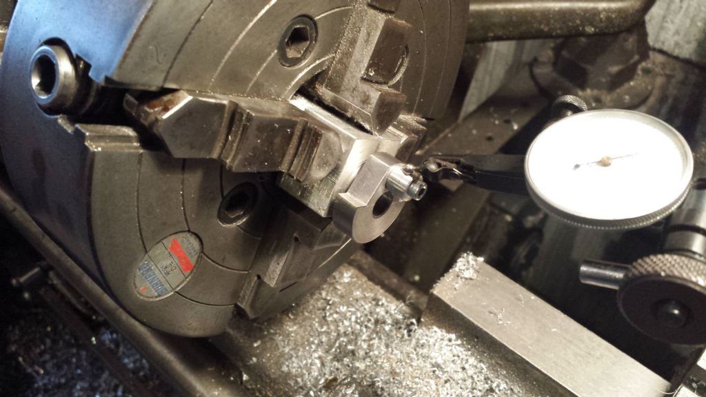

                                        I finished the crankshaft today drilling the hole for the crank pin.
                                        I read your blog build notes first, glad I did, a 5.5 hole is a good press fit for 7/32" silver steel.
                                        Photos show set up for drilling the crank pin hole using toolmakers button
                                        atb geoff

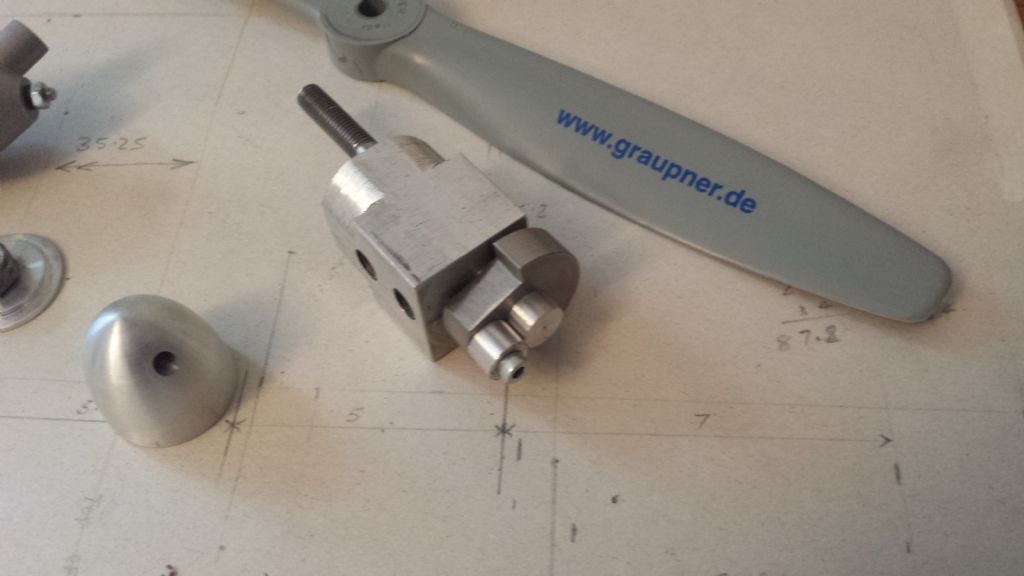

                                                      parade of partsHi Jason,
                                                      Firefly is all finished and assembled.
                                                      Once again, many thanks for your help and a superb build thread.
                                                      Pictures below. I have modified it a little with a shorter barrel and a removable aero sleeve and slimmer head. The head is slightly larger in diameter to accommodate wider hole spacings for the head bolts. This was necessary to ensure that the threaded holes in the barrel did not foul the transfer ports. The crankcase has deep groove ball bearings front (8) and (12) rear and the crankshaft has a conventional keyed drive for the prop driver.
                                                      Just a show pony at the moment, have not run it yet, that's another story.
                                                      A few final questions please. Was/is there any final consensus on the type of plug, prop, fuel etc. which is good for this engine. I have never started one before so I am now on another learning curve. big T again Geoffcomplete firefly
