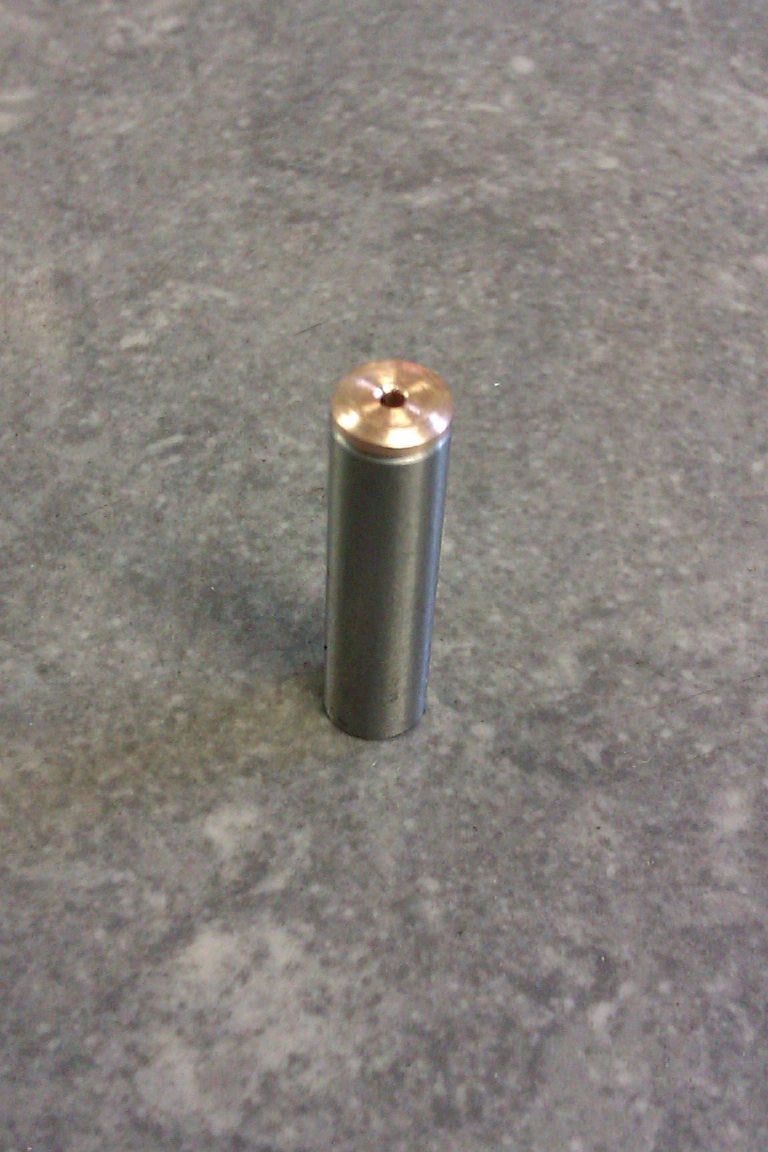

      Not much to say or show on this except to say make sure its a good fit in the piston, lap if needed.

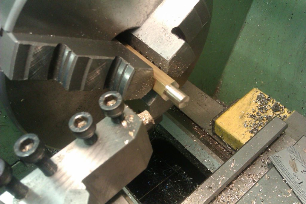

      Little End Plug
      Start with a bit of bronze, turn the spigot to a good fit in the gudgeon pin hole
      Firefly99
      Turn the OD to be a fraction less than the pin and drill the 1.0mm hole. I find a bit of cutting fluid helps when drilling bronze as it stops the drill bit getting hot and sticking. Then part off.
      Firefly100
      Hold lightly by the spigot and round over the end and thats it done.
      Firefly101
      Firefly102

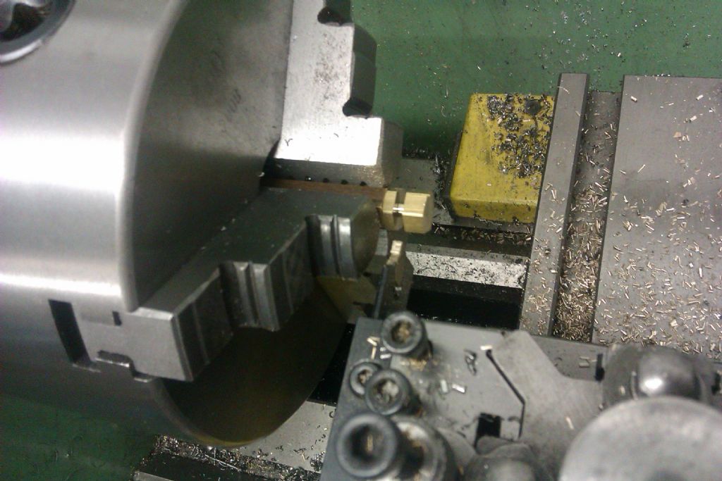

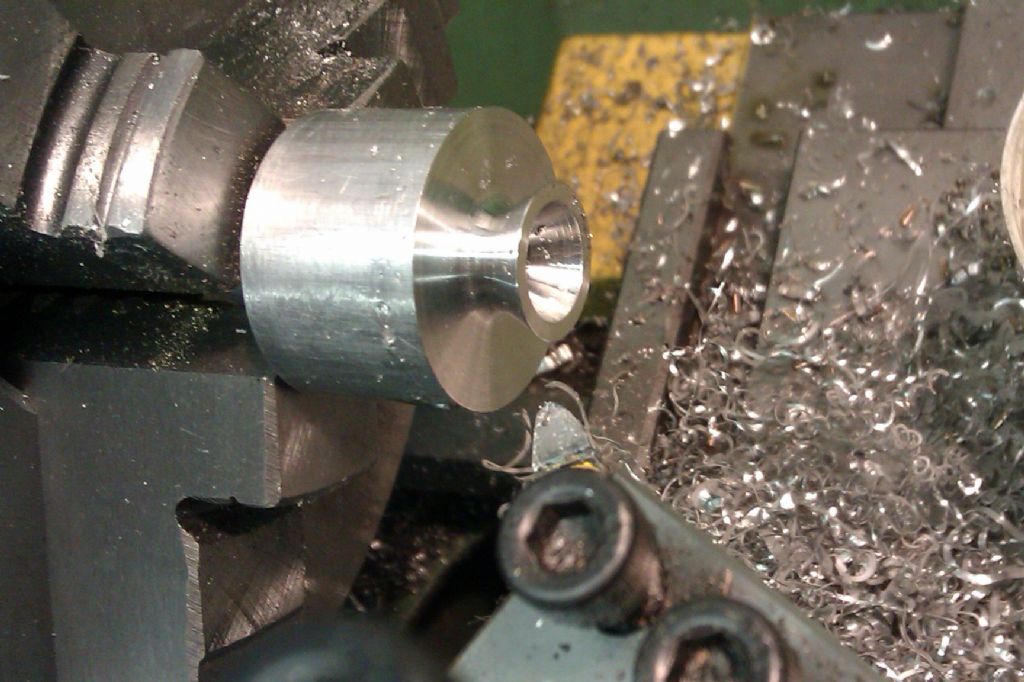

      Carb Barrel Spacer
      This is quite straight forward work, turn OD and then the smaller dia, face to length and drill the hole, ease all corners before parting off just over length.
      Frefly103
      Grip by the smaller dia and face back the flange to 1.2mm thick, ease corners.
      Firefly104

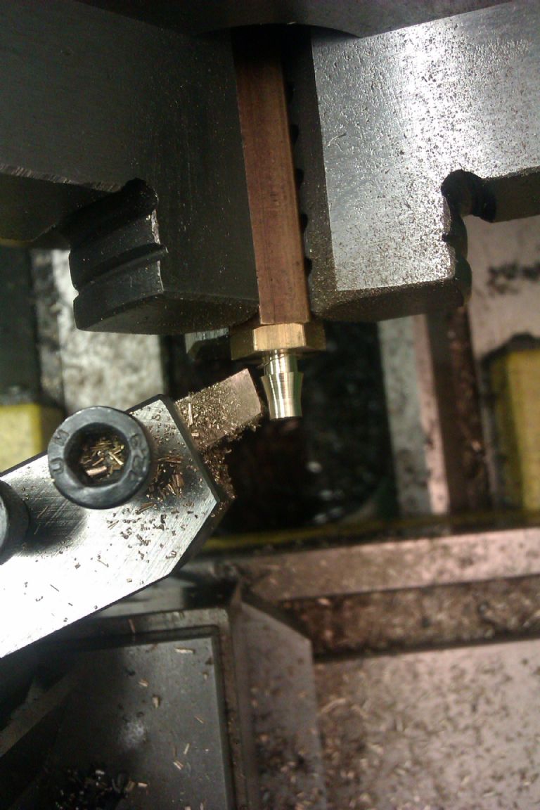

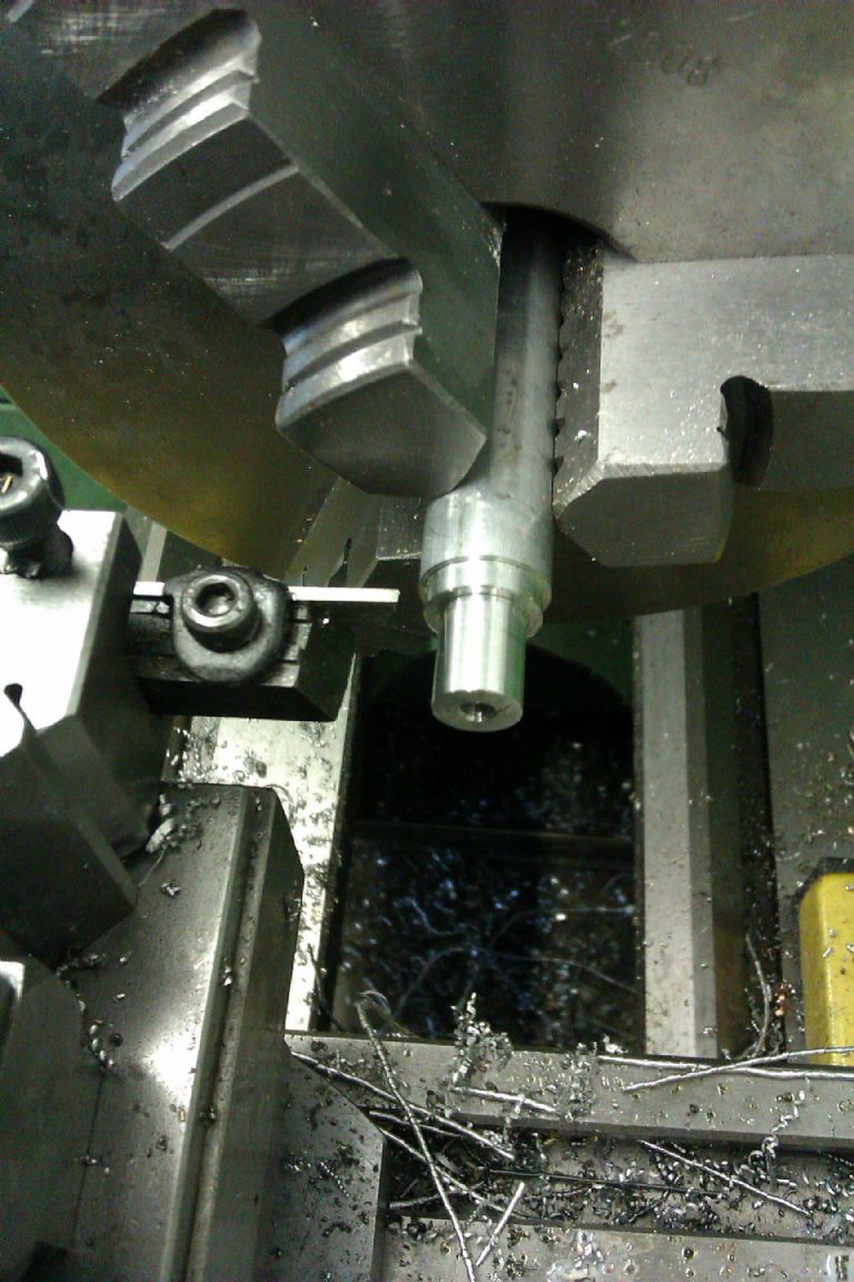

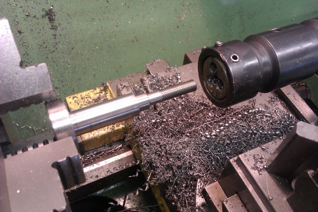

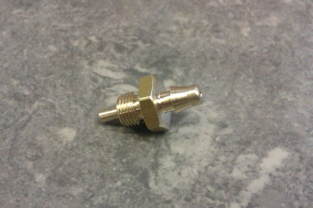

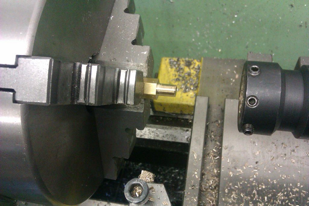

        Fuel Nipple
        I decided to use 1/4"x40ME thread on this rather than M6 so started by turning down a length to 1/4" dia.
        Firefly112

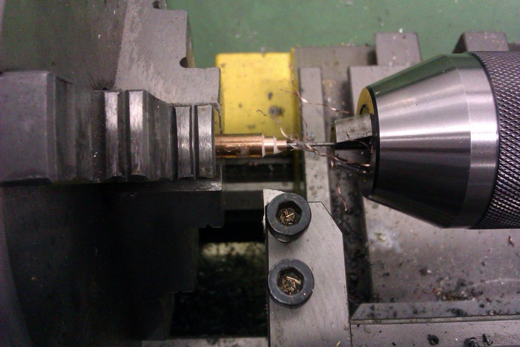

        Cut the thread using the tailstock die holder.
        Firefly113
        Use a small parting tool to cut the relief at the end of the thread, reduce the end to 2.35mm dia and then drill the hole, I went about half way from each end.
        Firefly114

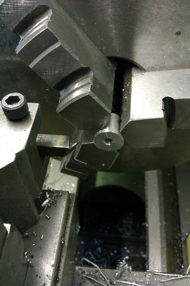

        Part off and then screw the threaded end into a suitable hole in some scrap. I actually have several lengths of brass hex with threaded holes in one end and a male thread on the other all in various ME sizes they really come in handy whan making steam and fuel fittings.
        I used a parting tool to cut the reduced dia behind the hose barb.
        Firefly115
        Turn down the remails to 4.25 and then cut the hose barb, I could not be bothered to set the topslide to 6deg so just swung the tool so the back edge was at an angle and used that.
        Firefly116
        Finish drilling the hole and round the end and the corners off the hex with a file and thats another bit out of the way.
        Firefly117
        #94492

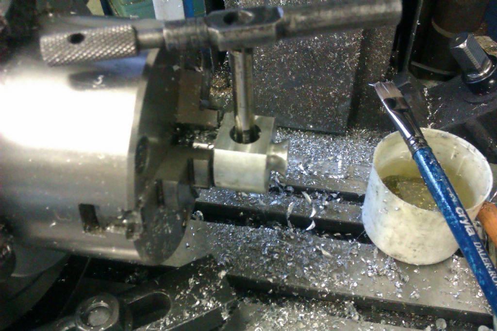

              Jason,
              I tap holes in my shop like you show – with the tap wrench in the MIDDLE of the tap. However, I find it a nuisance adjusting the drill chuck, so over the years I have turned up "bushings". The OD is just a clean-up cut for concentricity then I drill to fit the tap shank diameter (actually I relieve the tap hole till the guiding surface is one diameter long – don't know if this is required). At first I thougth I would be making one for each tap, but some do work for multiple taps.
              Bruce

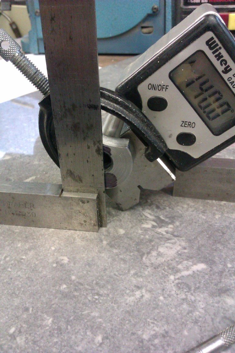

                  Bruce, sounds like a good idea particularly for the regularly used taps.

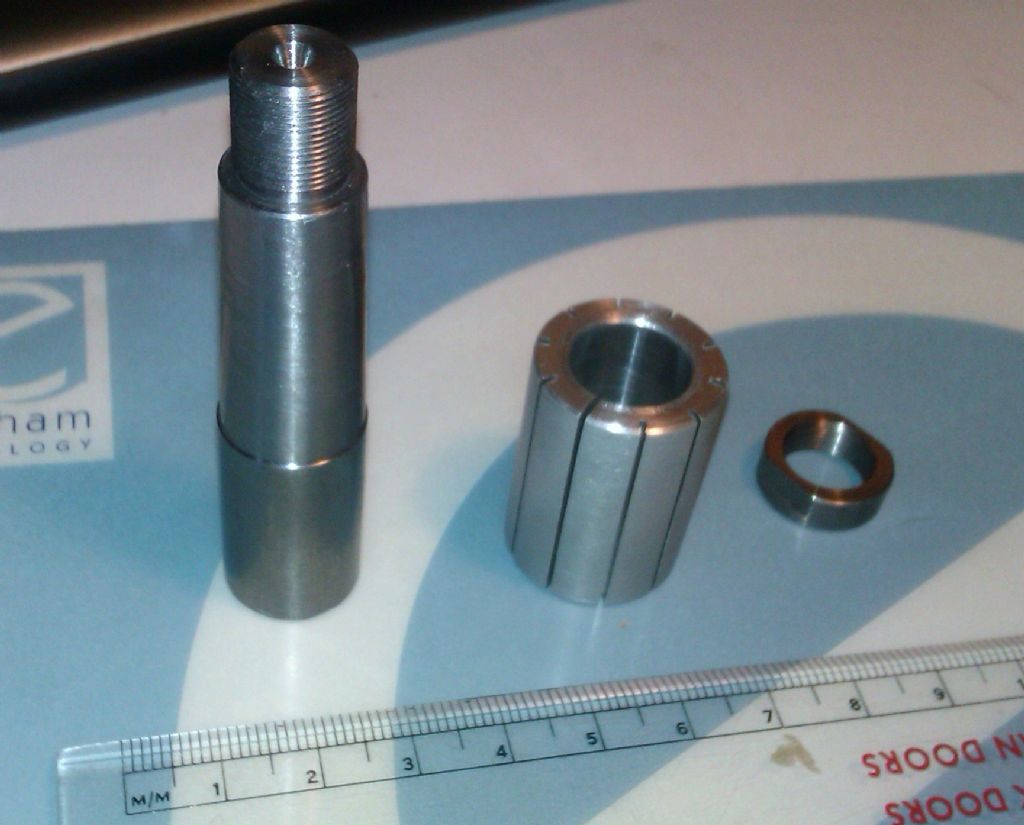

                  Ramon, the lap was no problem to expand, I set the topslide to approx 2deg to cut the taper, over the 30mm length of the lap this gave me a wall thickness of 3mm at the thin end to 4mm at the thick end. OD is 21mm average bore about 14mm and I cut 10 slots about 1/2 way through. I threaded the end 7/16×40 for nice fine adjustment and put a couple of flats on the nut to take a 3/8" spanner.
                  J

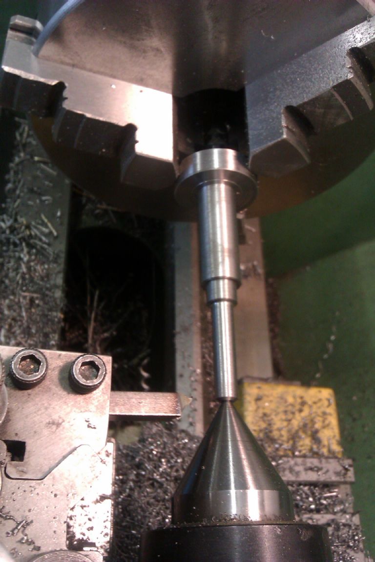

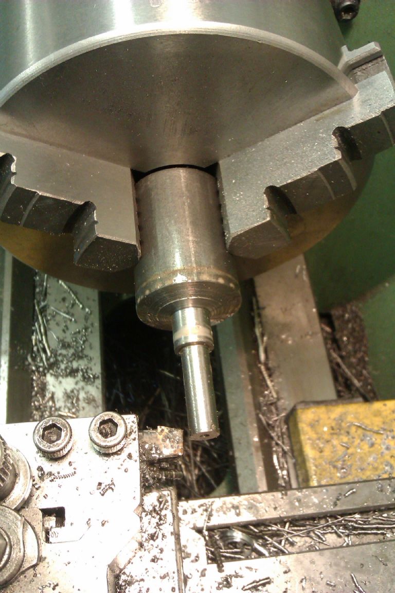

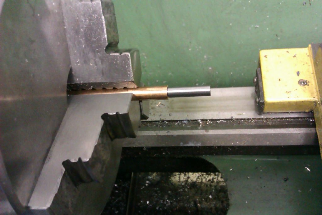

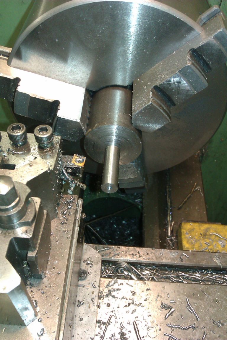

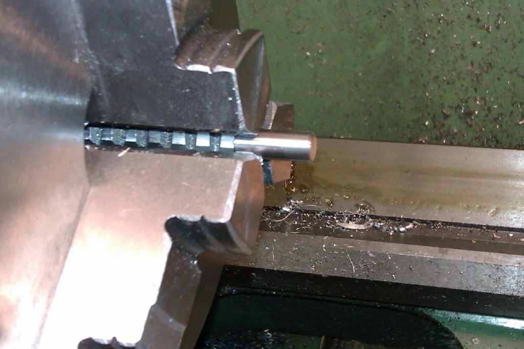

                        Crankshaft
                        Another bit of the 30mm EN8 was chucked up with about 40mm sticking out, faced, center drilled with a BS 0 bit and then roughed out to about 8mm.
                        Firefly137
                        Then a bit more was exposed and the step for the drive nut roughed out a little over dia.
                        Firefly138
                        I then held it by what will be the web, supported with the tail stock centre and reduced the bearing area down to 13mm.
                        Firefly138

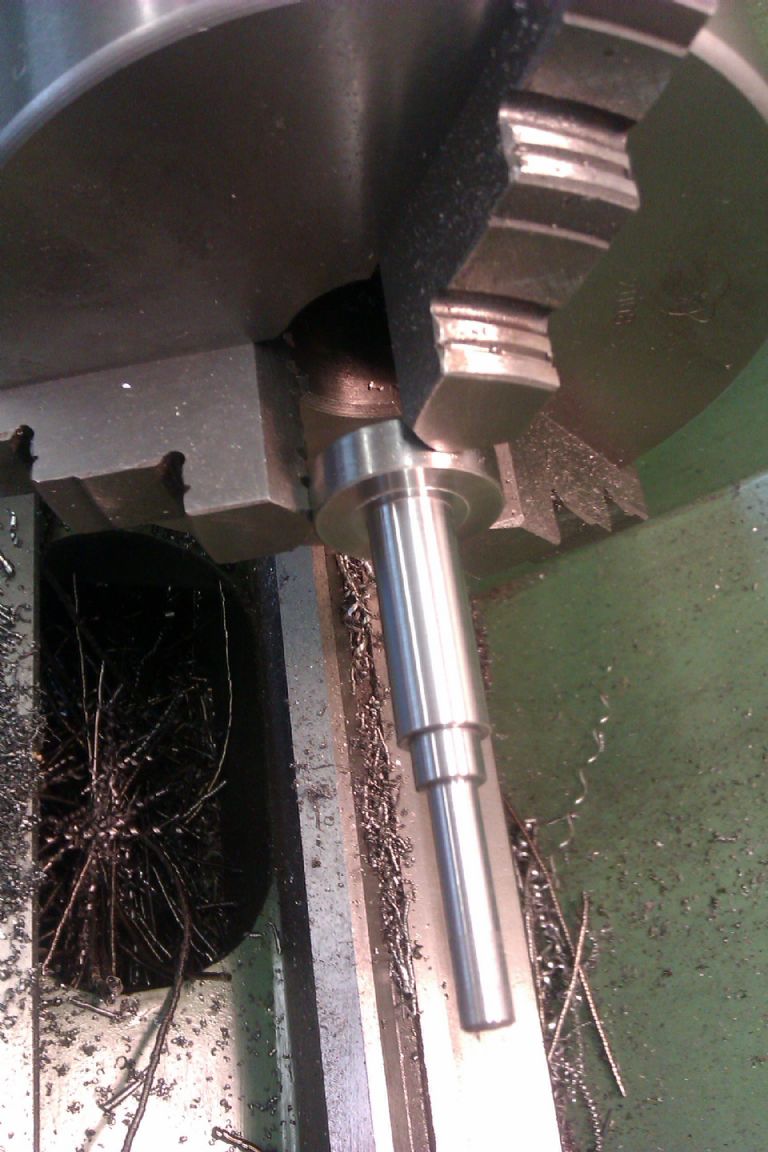

                        You may have noticed that I am using a holder that makes use of teh other two corners of blunt CCMT inserts, I find this very good for roughing cuts, it whizzed through the EN8 with 0.050" depth of cut producing a nice pile of swarf.
                        Firefly139

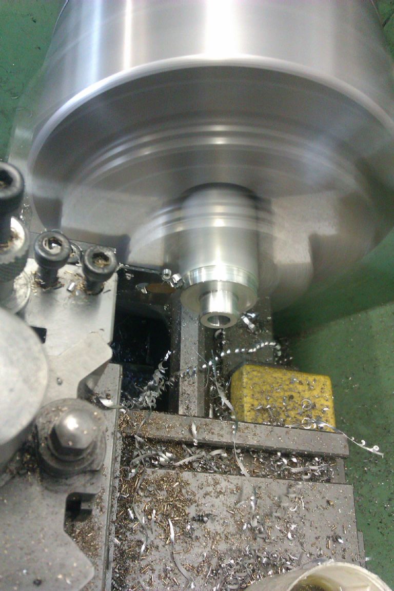

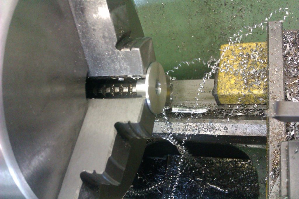

                        I then reversed the part in the chuck, faced off, drilled out to 8.5mm reduced the OD to finished size and chamfered all corners.
                        Firefly140
                        Now I had a face to work from the web was turned to thickness plus the 0.2mm for the raised area around the pin, bearing dia turrned ready for honing and the larger 0.2mm raised area formed.
                        Firefly141
                        The other diameters were finish turned to dia and length before the usual chamfering.

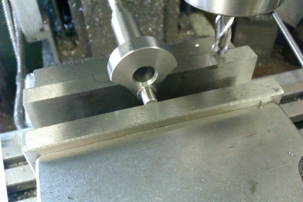

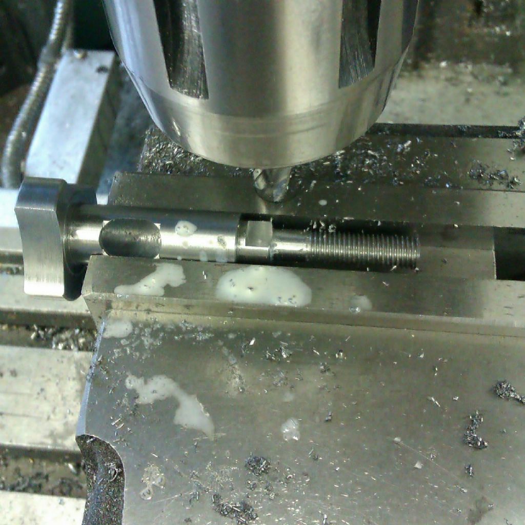

                        Then over to the mill to add some shape to the web using a boring head.
                        Firefly146
                        And repeated for the other side, now the cutting fluid has been wiped off you can see I also used the DRO to spot the crank pin position.
                        Firefly147

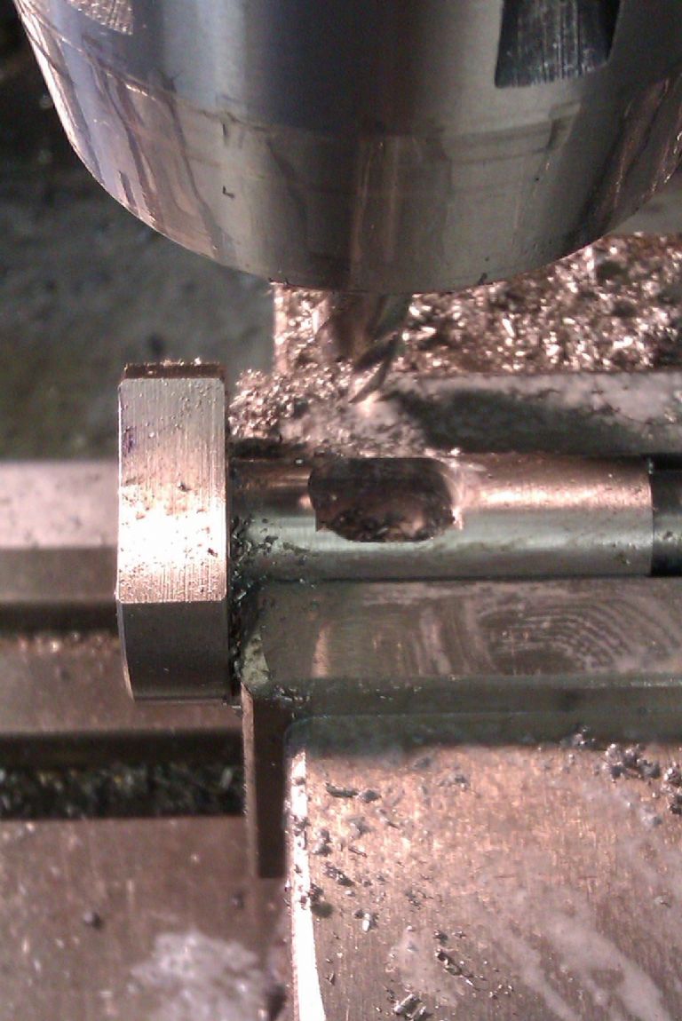

                        Holding the crank in a vee block I lightly marked a vertical line on the end while it was tilted to 40deg.
                        Firefly148
                        This line was then used to make sure the crank was held at the correct angle for milling.
                        Firefly149
                        Here the flat area and the 8mm slot have been milled.
                        Firefly150
                        Then the flat for the drive nut
                        Firefly151
                        Cont'd
                        Edited By JasonB on 21/07/2012 21:01:11

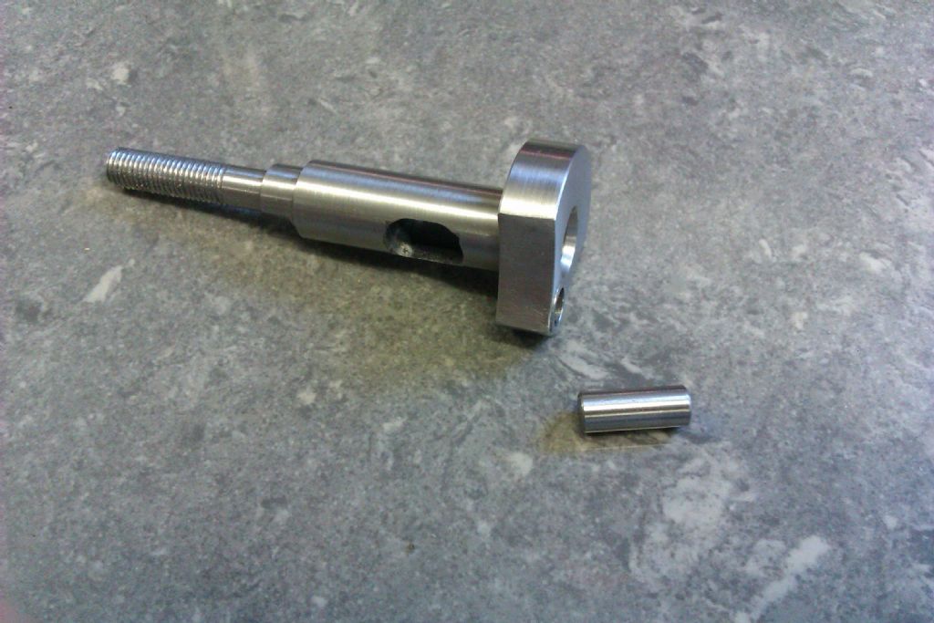

                          So here we have the crankshaft and pin.
                          Firefly155
                          Which were pressed together in the mill vice
                          Firefly156
                          So they looked like this

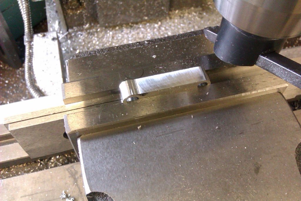

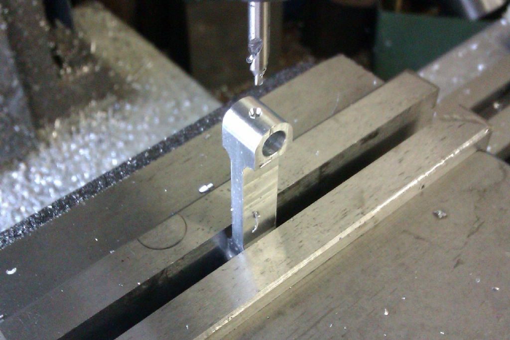

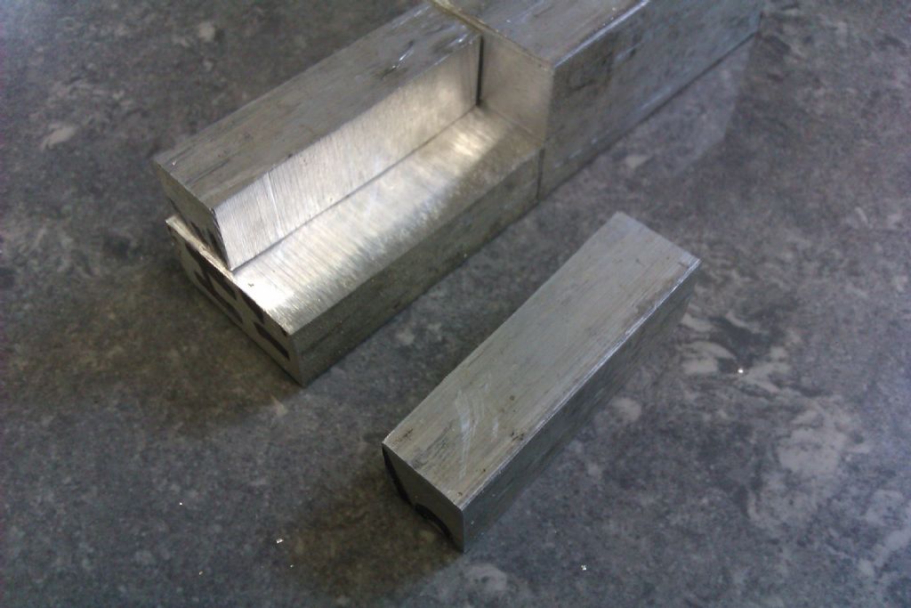

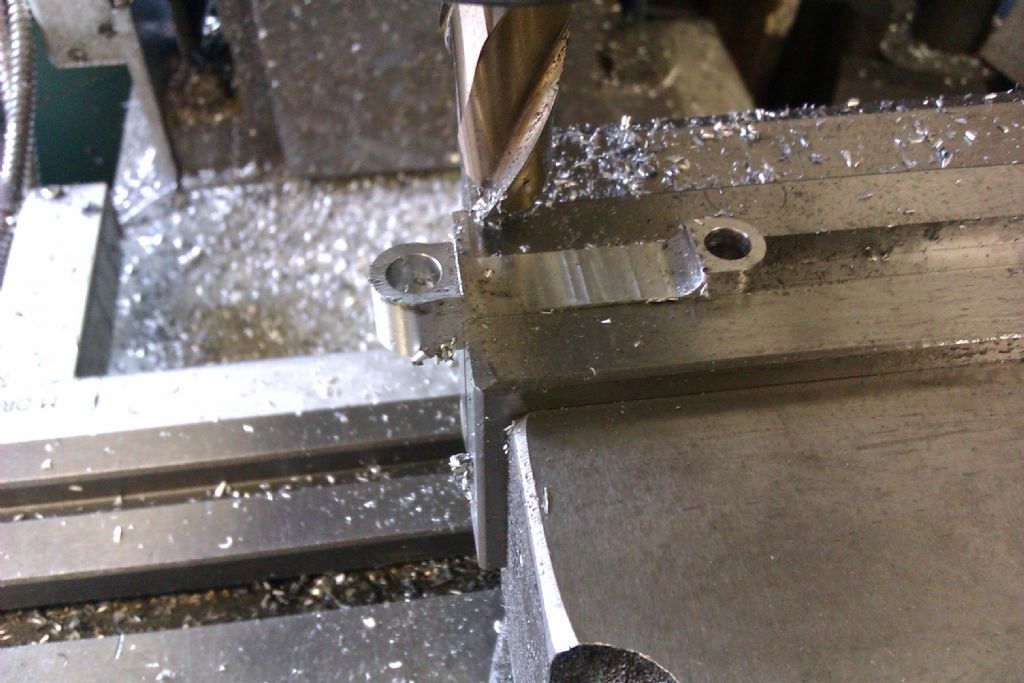

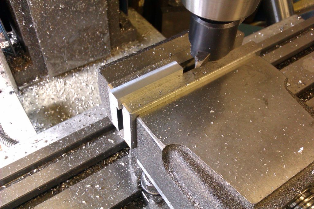

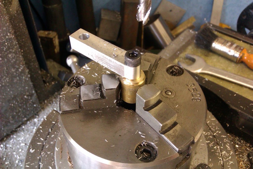

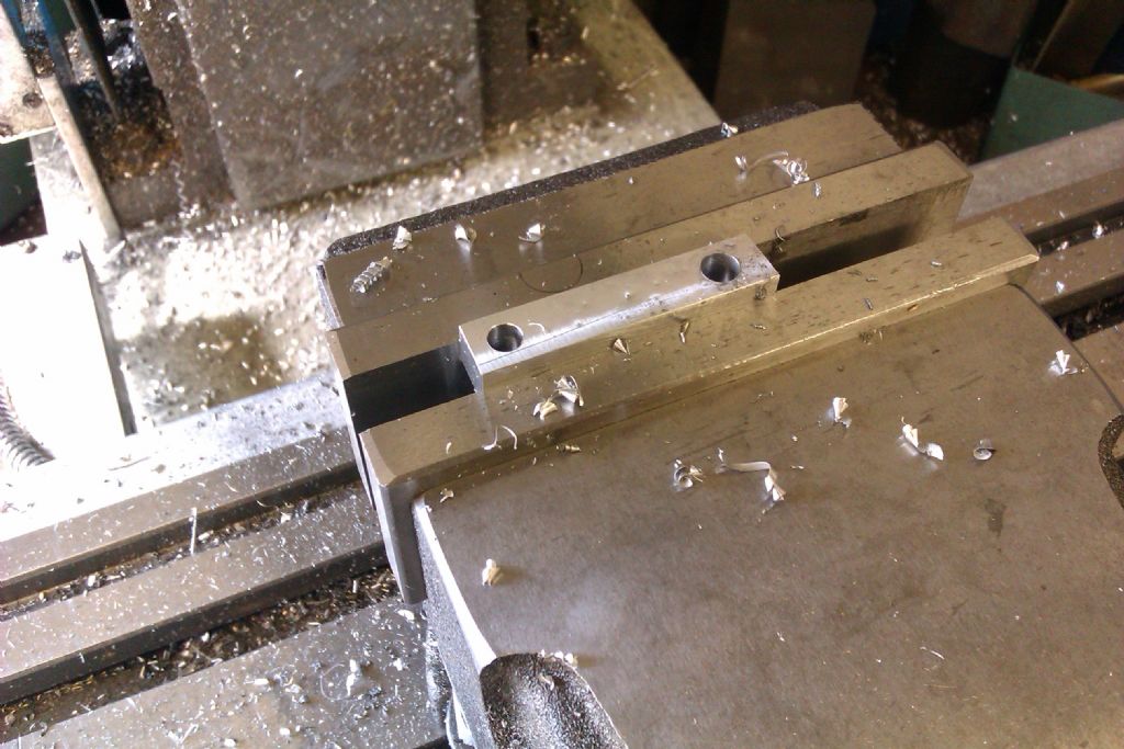

                            Conrod

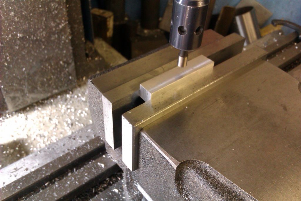

                            I found it was only a few pence more to buy 1"x1" HE15 than 12x13mm so ordered 4" from M-machine which gave me plenty in reserve should I have a scrapper, bandsaw soon gave me a usable bit.
                            Firefly161
                            This was cleaned up in the mill with a flycutter
                            Firefly162
                            Once de-burred it was centred up in the milling vice
                            Firefly163
                            The two holes were drilled and then reamed
                            Firefly164

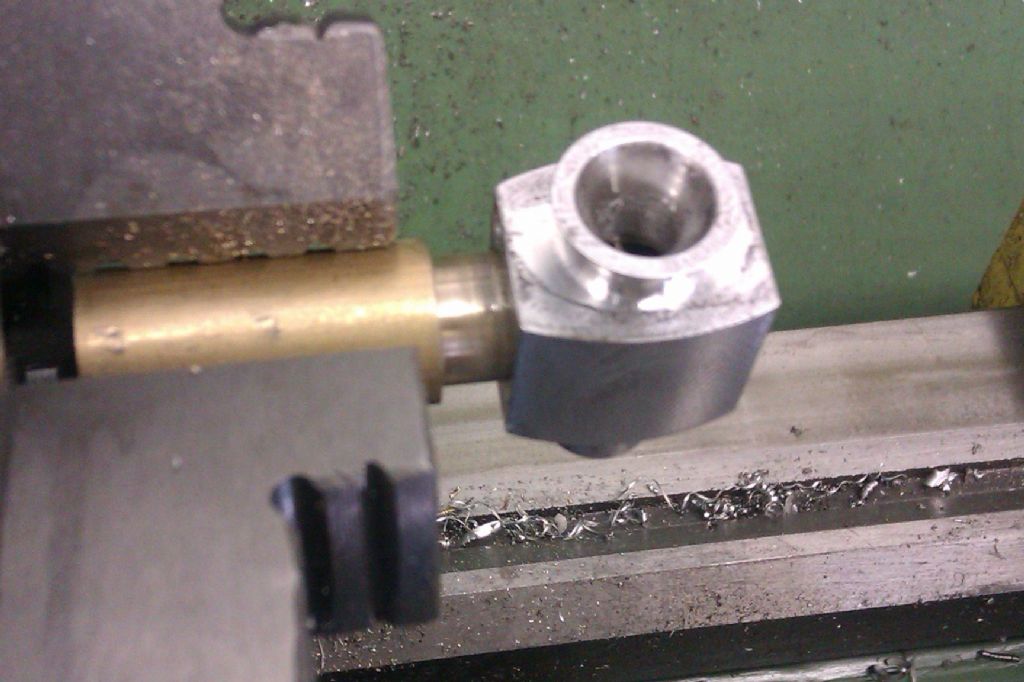

                            A simple holder was made from 3/8" brass and the conrod screwed to this so the little end could be rounded to 8mm dia
                            Firefly165
                            A quick alteration to the brass holder and the big end was rounded to 9mm taking the cut into the two sides to give 8mm between cuts
                            Firefly166

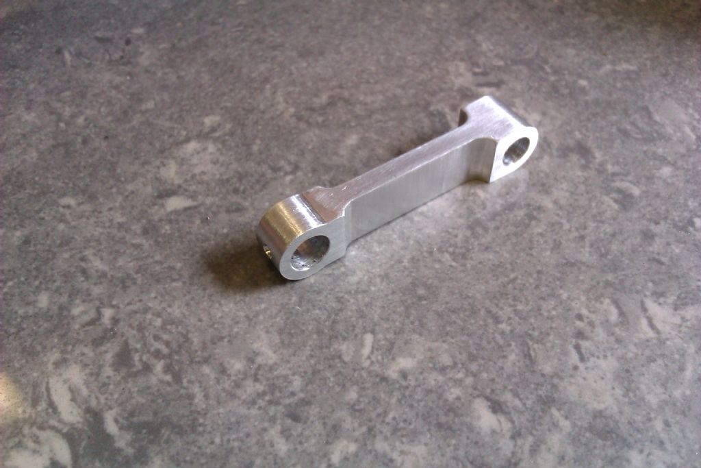

                            0.5mm was taken off each side using the rounded end of the flycutter to blend the curves
                            Firefly167
                            The waist was cut using a hand ground radius corner cutter Note the drawing states 10mm dia typical but is actually drawn with a 5mm dia or 2.5mm radius, take your choice, I went for the smaller.
                            Firefly168
                            The width of the big end was then machined back as required.
                            Firefly169
                            The oil holes were added with a BS0 centre drill
                            Firefly170
                            And thats the conrod finished
                            Firefly171

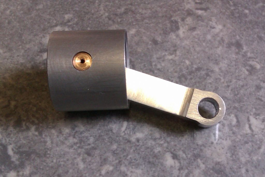

                            Could not resist putting a few bits together, even with the head off and just holding the backplate on by hand I can feel the vacuum in the crankcase as the piston rises before the port opens, so must be doing something right.
                            Firefly172

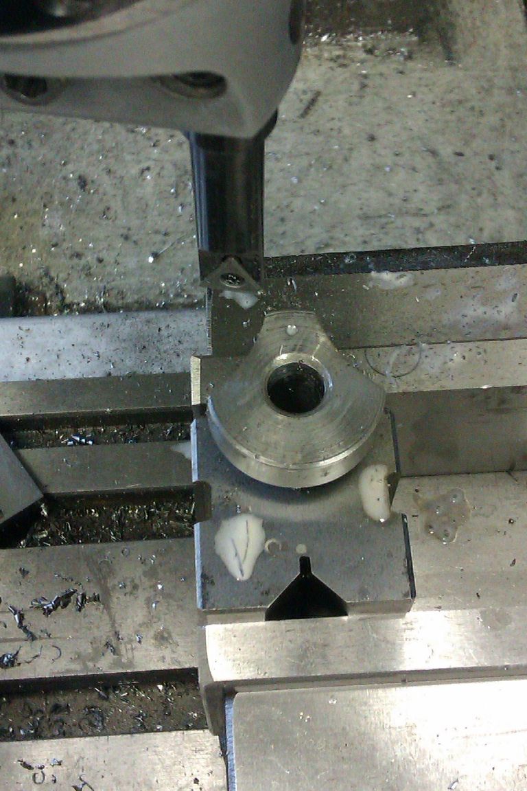

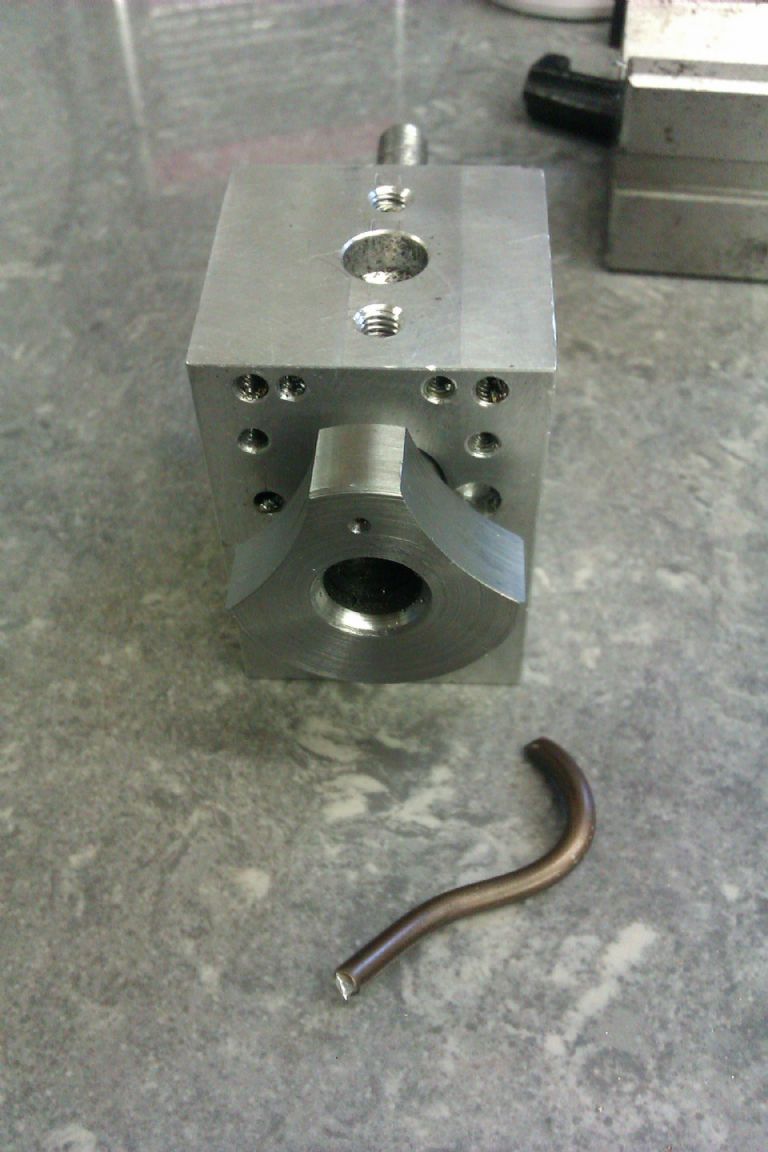

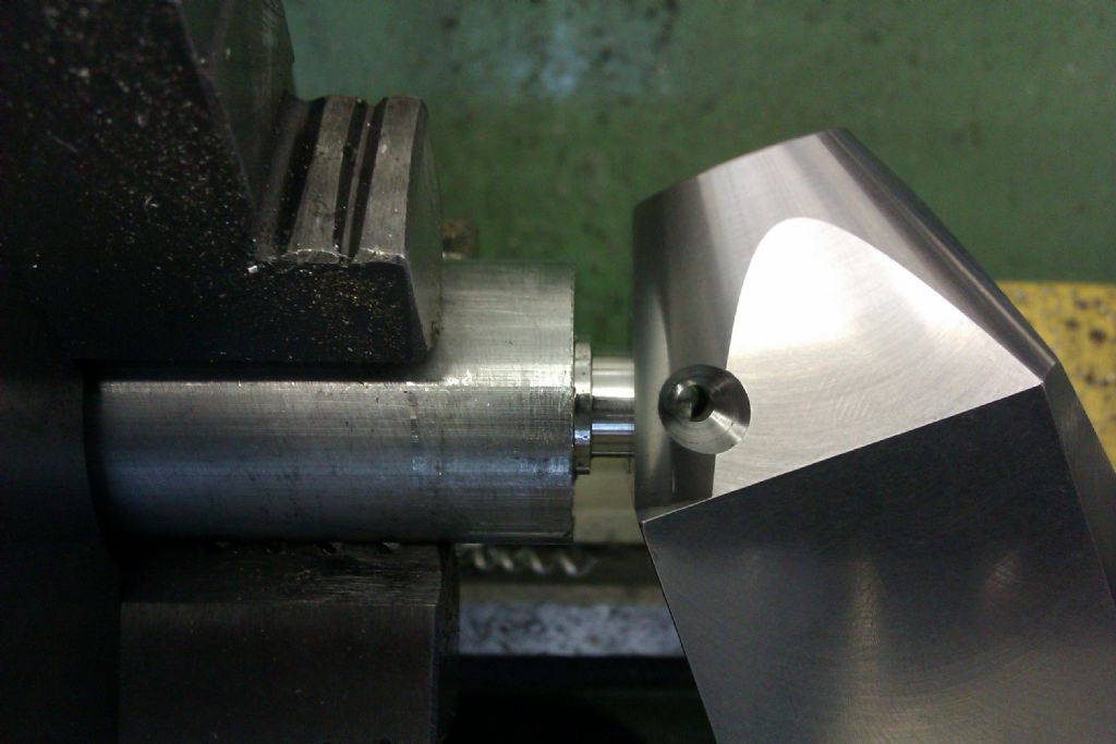

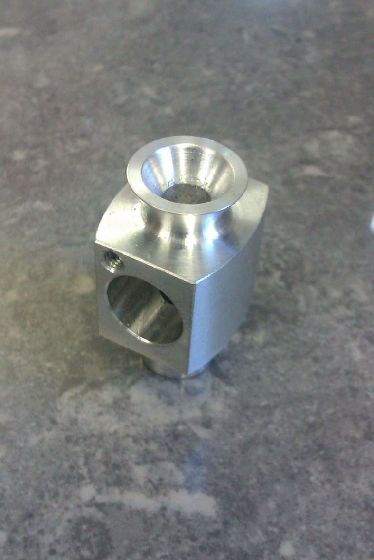

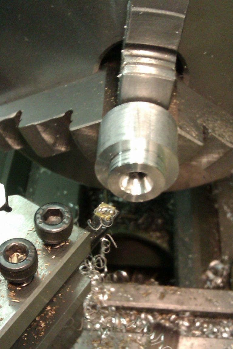

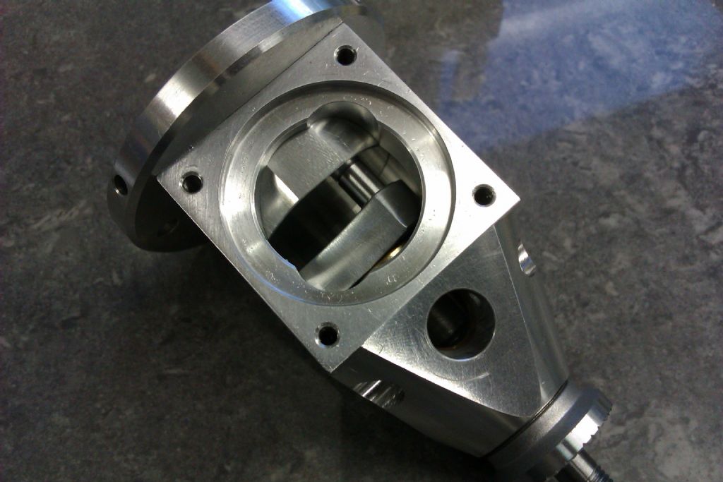

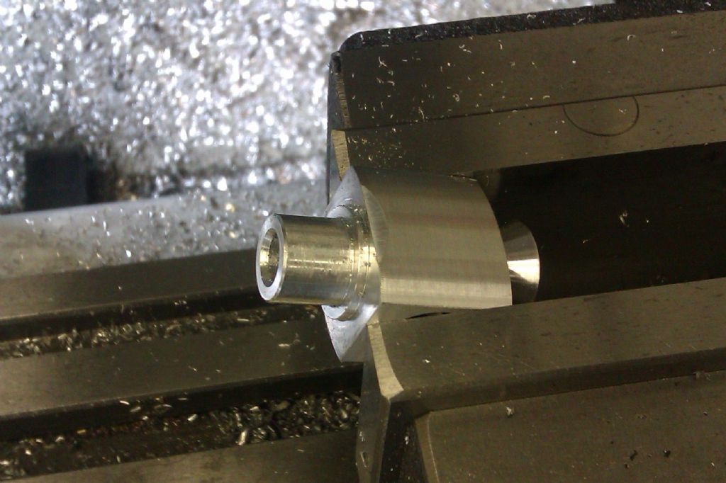

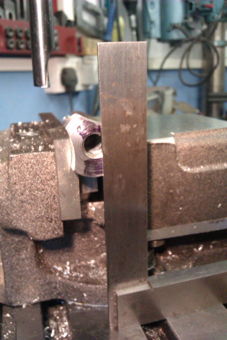

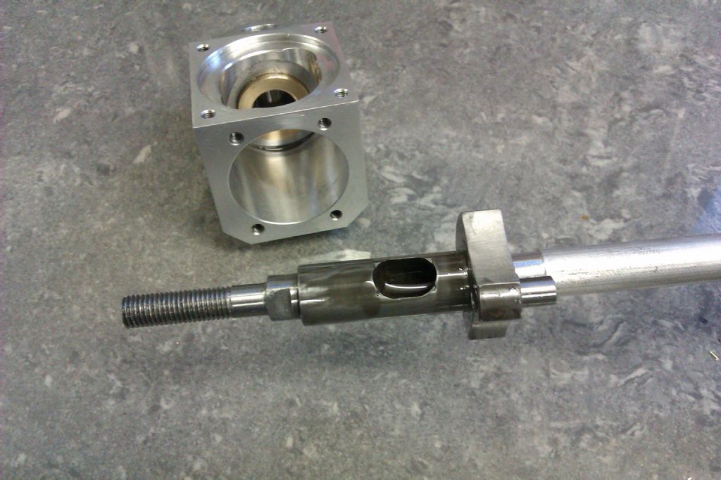

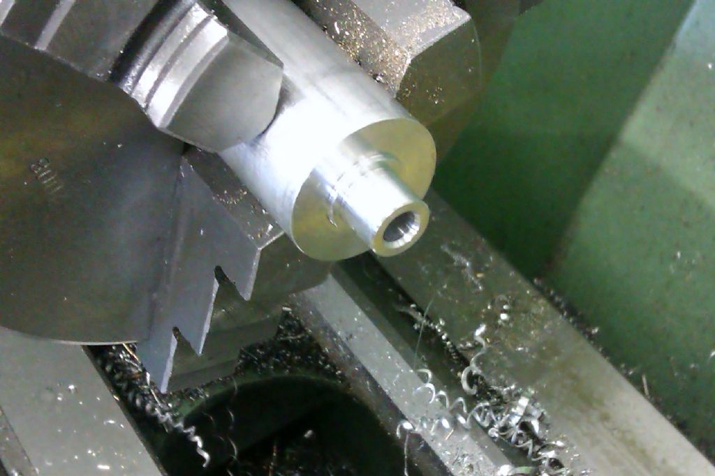

                              Carburettor Body
                              Once again I have deviated slightly on this one partly as I did not have any 3/4" hex bar and partly because I wanted a less bar stock look.
                              Starting with a length of 1" dia bar the spigot and step were turned using the inlet in the crankcase to test fit the spigot to.
                              Firefly173
                              The hole was than drilled and all corners chamfered
                              Firefly174
                              Sufficient was sawn off the bar and then holding by the spigot I roughed out for the inlet trumpet.
                              Firefly175
                              Then used a mini boring bar to cut the internal taper
                              Firefly176
                              Without altering the top slide angle a round nosed tool was used to cut the external profile
                              Firefly177

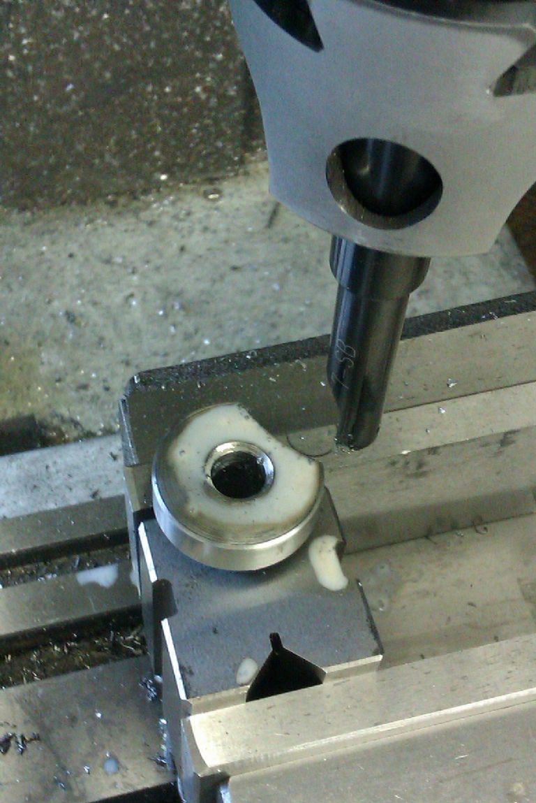

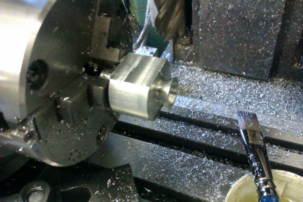

                              Transfering the work to the rotary table the two sides were milled flat and to finished width
                              Firefly178
                              I then drilled tapping size before using an FC-3 cutter for the 10mm counterbore, this gives a flat bottomed hole with the advantage of a turn or two more thread than the drilled hole shown, its also a better finish for a good fit of the barrel.
                              Firefly179
                              Tap the hole and while in this orientation drill and tap the 2.5mm screw hole
                              Firefly180
                              Rather than using a hex shape I cut the front and back to a shallow convex profile using a boring head, this does need a slight clearance cut to miss the cylinder barrel
                              Firefly181
                              Firefly182
                              Finished job, well actually I took the pic before drilling and tapping the two retaining screw holes.
                              Firefly183
                              J

                                The crankshaft and carburetor look excellent, beautiful work as usual. One 'design' question – what seals the carb spigot to the crankcase? I am sure you have a close fit between carb spigot and crankcase, but ideally this should be sealed gas-tight. An o-ring or flat silicone gasket could be used if space and / or suitable counterbore were planned for at the joint. If there is no room, a smear of RTV could be used as a last resort. Just some thoughts….
                                (I had problems years ago in commerciallly-made RC aircraft engines with bad sealing in this area and rear crankcase cover seals leaking causing some running issues. I fixed several of these leaks with RTV sealant but felt it was a bit of a rough fix at the time.)
                                Again, great job so far!
                                JD
                                Edited By Jeff Dayman on 23/07/2012 21:00:48
                                #95015
                                  Funny enough I was in two minds to leave off the step on carb spigot and fit an O ring but thought I Would try it first as Alex says it is a Gasget less design. If needbe I'll ad a smear of liquid gadget anywhere that needs it or machine the step off and go with the O ring.
                                  J

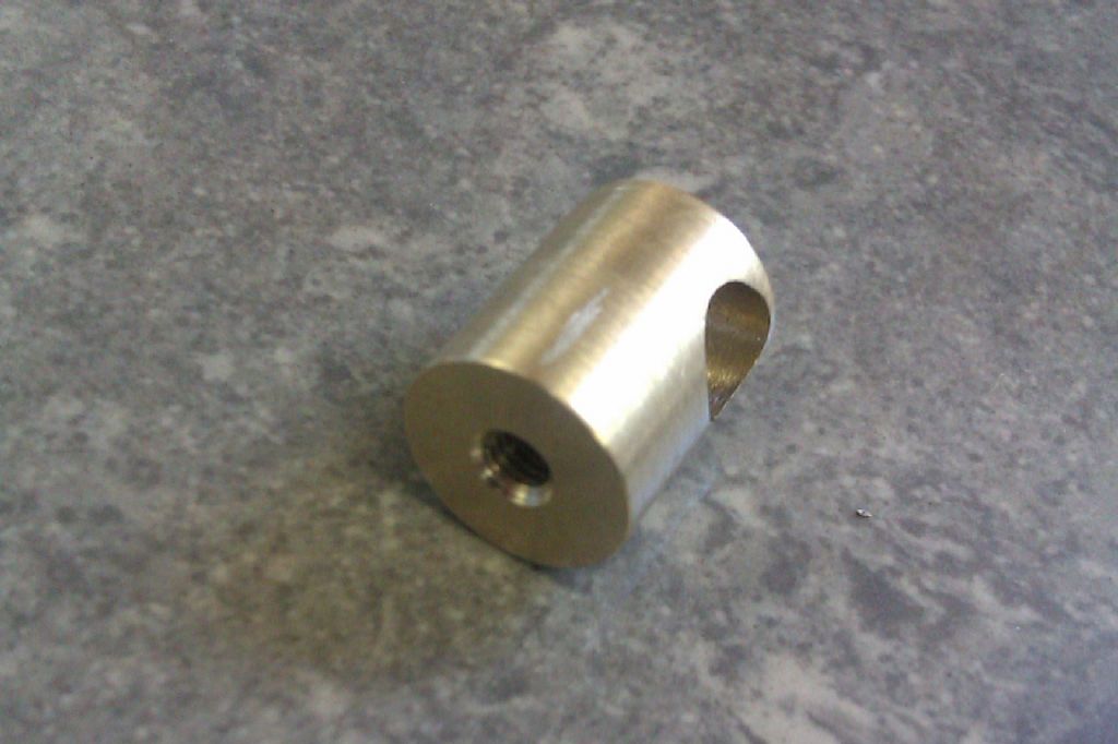

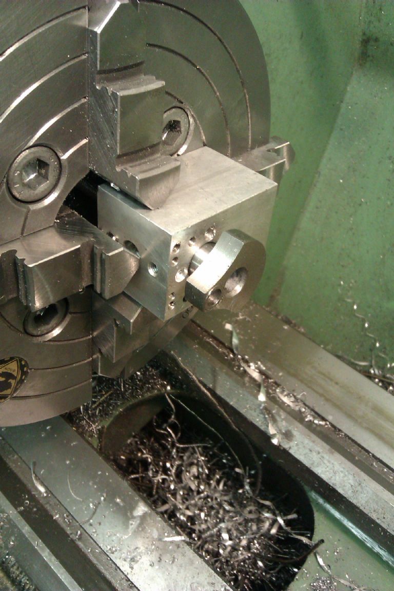

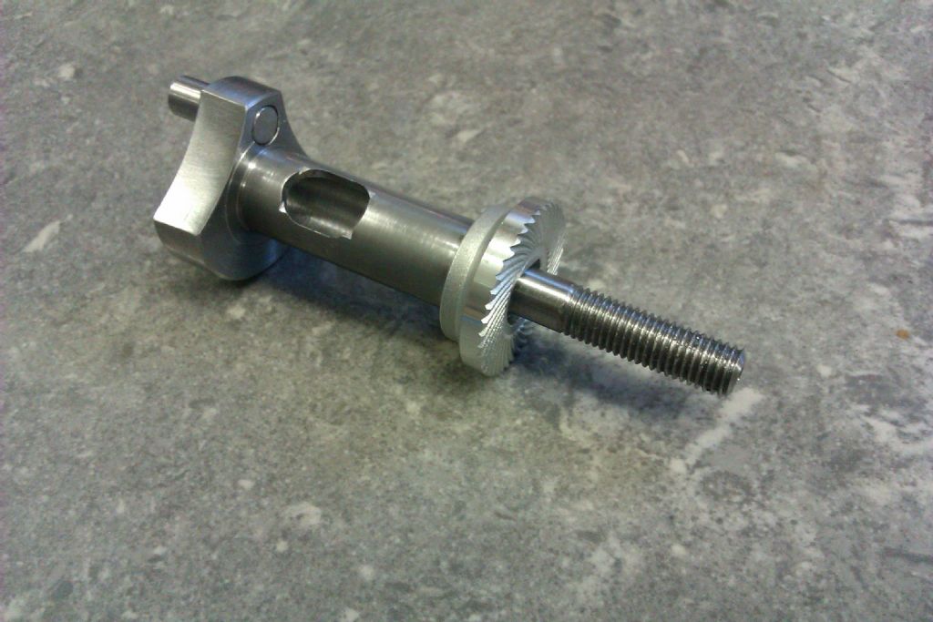

                                    Carb Barrel
                                    As the cross hole is quite close to the edge I chose to drill first a few mm from the end and also from larger stock (1/2&quot
                                    Firefly184
                                    It was then turned and faced to size before lapping to the carb body
                                    Firefly185
                                    To finish its then just a case of drilling, tapping parting and facing to length
                                    Firefly186

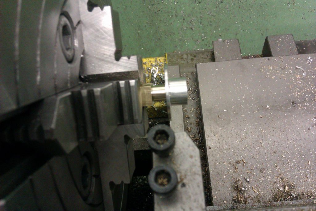

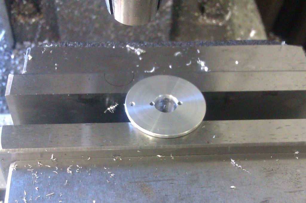

                                    Mixing Disc
                                    This is fairly straightforward tutning to form the spigot, drill and then part off a bit over long
                                    Firefly187
                                    Before reversing in the chuck and facing to thickness
                                    Firefly188
                                    Transfer to the mill and add the holes, I put the linkage one in line with the pins but it makes little difference.
                                    Firefly189

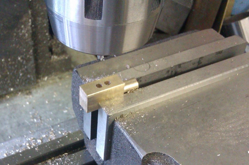

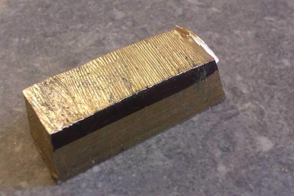

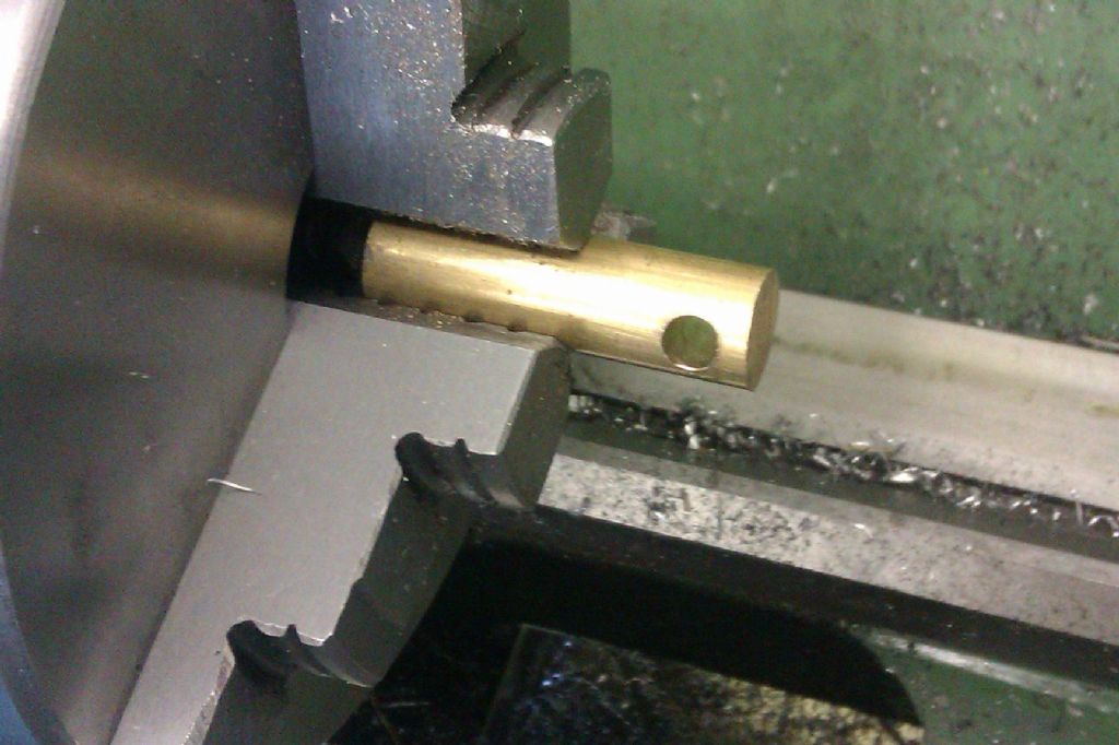

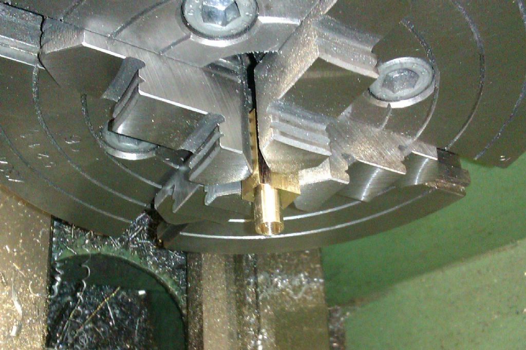

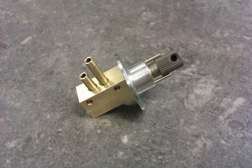

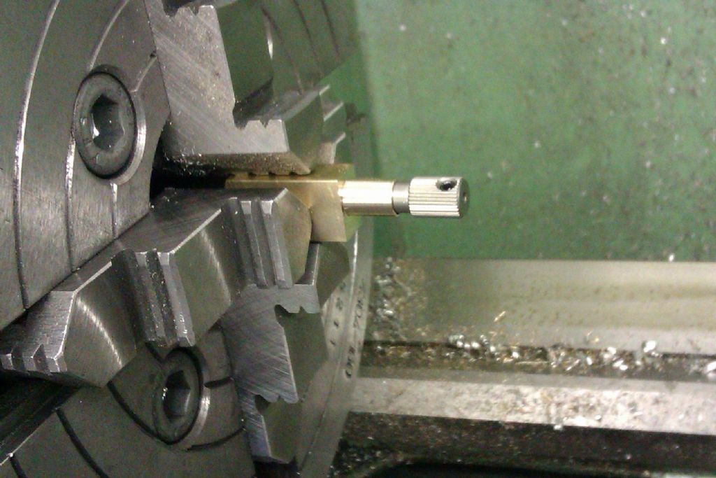

                                    Mixer Body

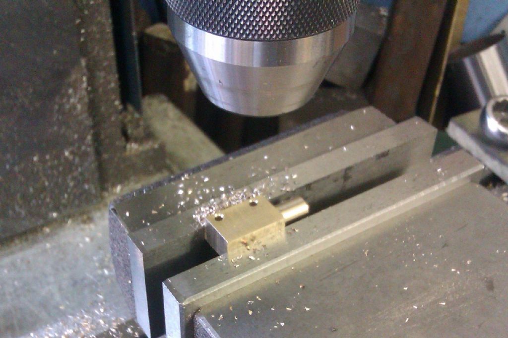

                                    A suitable lump of brass was fished out of the scrap box and machined to 11.5×8.0mm
                                    Firefly190
                                    The centre of the hole was marked and set to run true in teh 4-jaw and the spigot turned a nice running fit in the disc
                                    Firefly191
                                    It was then drilled, tapped and counterbored. Make sure you use a M4x0.5 metric fine thread if going with the OS needle
                                    Firefly192
                                    Needle was test fitted before removing from chuck.
                                    Firefly193
                                    Then over to the mill to drill the fuel passages and counterbore for the pipe stubs
                                    Firefly194
                                    Flip it on its side and drill the fixing holes
                                    Firefly195
                                    Job Done
                                    Firefly196
                                    Add the tubes and thats the mixer assembly done

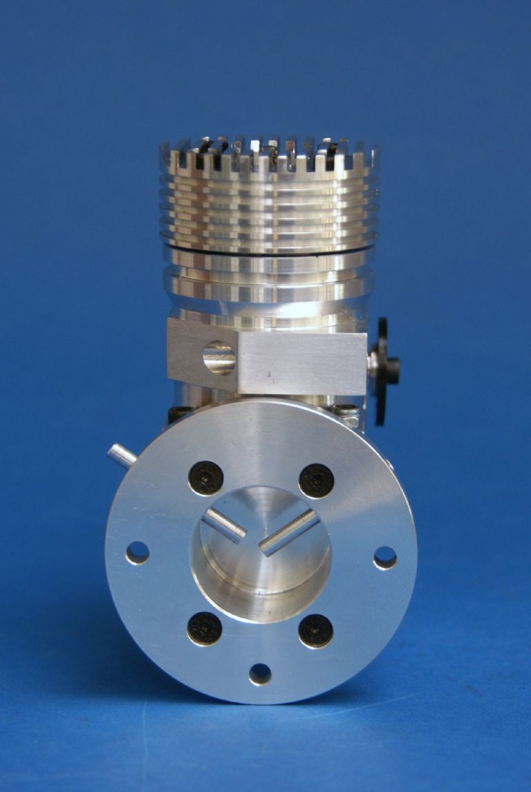

                                    Thats the making complete, hope to get it running this weekend, stay tooned.
                                    J
                                    #95251
                                    Stewart Hart
                                      @stewarthart90345
                                      Thats comming together wonderfully well Jason:- great build log
                                      Stew

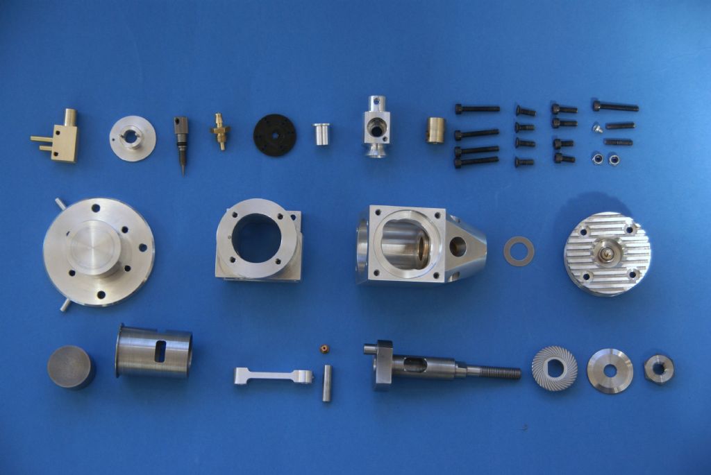

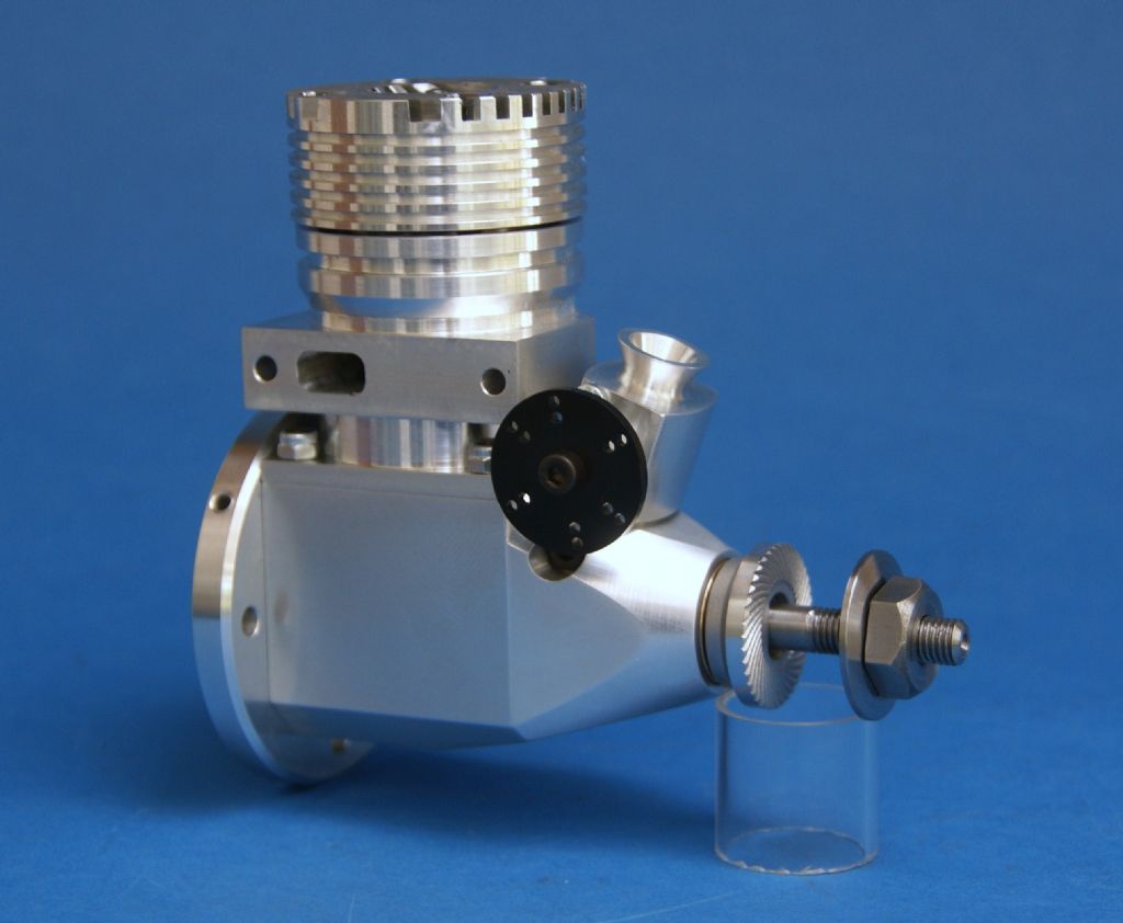

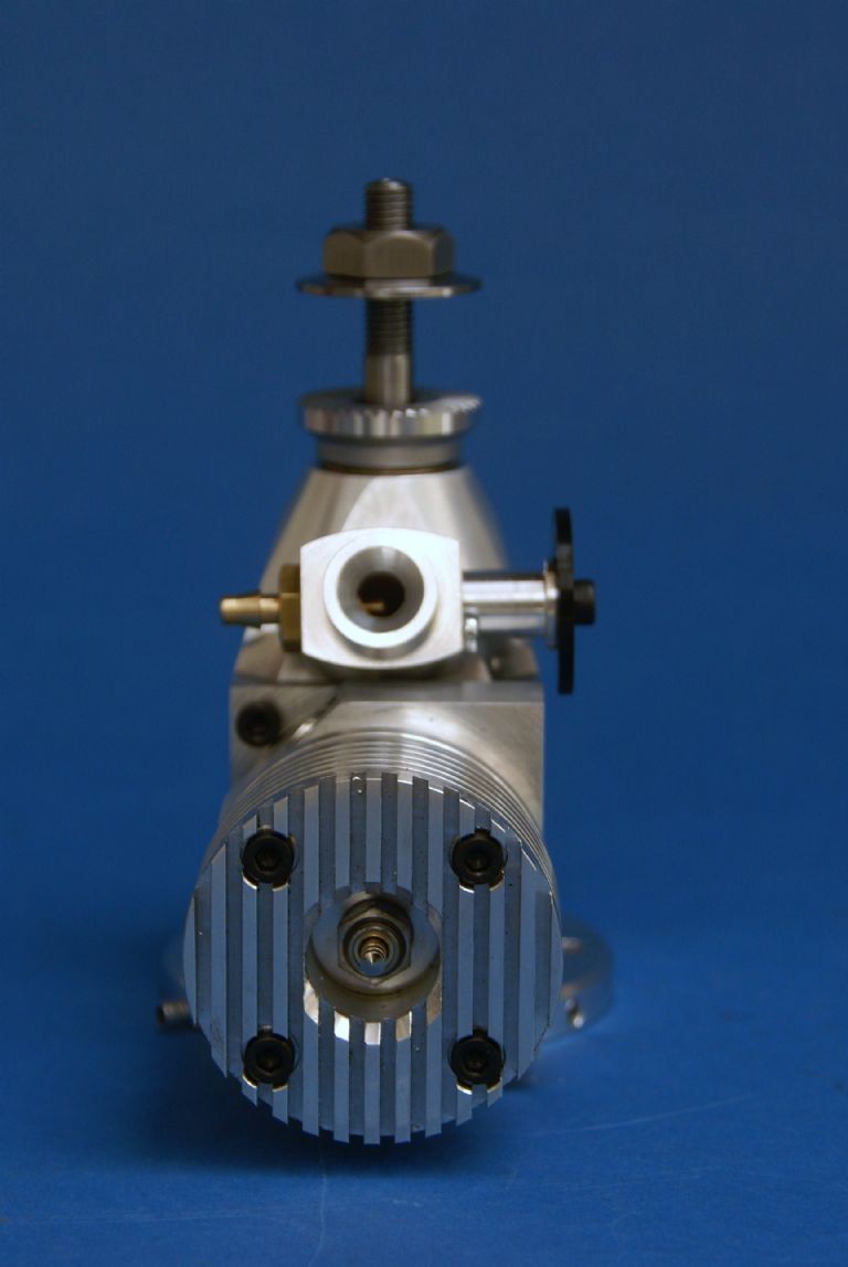

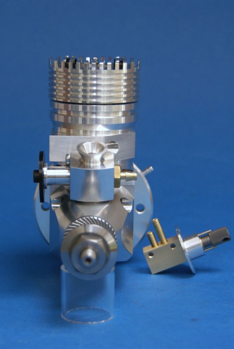

                                      #95265
                                        Thanks Stew.

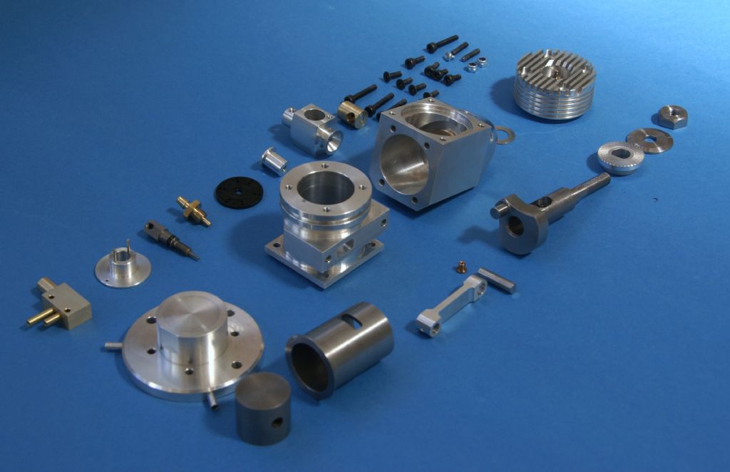

                                        Just a few decent shots rather than phone pictures of the assorted parts and assembled engine
                                        Firefly199
                                        Firefly200
                                        Firefly201
                                        Firefly202
                                        Firefly203
                                        Firefly204
                                        Firefly205
                                        Firefly206
                                        Firefly207
                                        J

                                          It's looking great Jason, nice job. Are you planning a muffler / silencer for it later?
                                          If designed correctly, a muffler can increase power, lower the combustion chamber temperature, and reduces noise of course. There are lots of references for this if you google "expansion chamber design for two stroke engines" and/or look at pipes for race two stroke motorbikes.
                                          Thanks for the build log.

                                            Just knocked up a simple stand, bodged a tank from a film canister hence the bubbles in the fuel line and fitted the only silencer I had which is probably a bit restrictive as its off a 0.25 engine. Oh and the fuel is at least 20yrs old!!
                                            I'll spend a bit of time tidying things up then post a better video.
                                            I'd like to thank Alex for his design, Glenn for the drawings, DavidC for publishing and also the help from Ramon Wilson with his posts over on HMEM as well as his support during the build.
                                            Now lets see a few more or at least what progress you have made.
                                            Edited By JasonB on 28/07/2012 16:52:50

                                                Hi George, yes it is the 280v-f and I have the smaller 00 original Dickson which like you I was loath to part with as I have about 20 holders.
                                                First issue was height so I just cut a square from some 3 x 1/4 flat stock to fit over the stud. You can see it in this photo
                                                Firefly7
                                                Second was as you say getting teh post onto the spindle, there is a larger cast spigot that comes out of teh topslide and the threaded spindle out of that. My solution was to use a boring head to reduce the OD of the spigot until the toolpost fitted over it. I have a simple sleeve I can drop on when I want to use the supplied 4-way post which is handy for large dia boring bars etc.
                                                Hope that is clear, let me know if not and I'll take some pics in the morning.

                                                    I rigged up a better fuel tank and set the engine up outside on the workmate so it sounds a bit better now though the exhaust still needs sorting.
                                                    You can see the barb barrel opening and closing as I move the camera around to the front but had to stop the video before the other clamp came loose allowing the engine to take offsmile o
