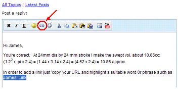

          Hi James,
          At 24mm dia by 24 mm stroke I make the swept vol. about 10.85cc:
          1.22 x pi x 2.4 = 1.44 x 3.14 x 2.4 = 4.52 x 2.4 = 10.85 approx.

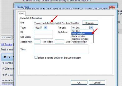

          In order to add links just copy your URL and highlight a suitable word or phrase such as James Link. Then click the ‘link’ icon at the top of the message box (arrowed).
          Then paste your URL in the box shown below (Arrow). I then choose for the link to open in a new window (short arrow) so that you keep the Model engineer window open.
          Hope that makes it clearer, sorry if I confused you earlier.

                    Hi Hansrudolf,
                    I am trying the method of adding links in Opera so here goes.
                    Jim’s Video link.
                    It appears to have worked, however in a previous message the browser would not let me edit the link so there may be a problem there.  I will now post the message and test the link.
                    Best regards (fingers crossed)
                    Terry
                    #64281
                    Terryd
                      @terryd72465
                      Hi Hansrudolf,
                      It seems to be successful using Opera.  Just make sure that you paste the Url into the top box of the ‘link’ window.  It is better to copy and paste rather than try to type it in.
                      Regards
                      Terry
