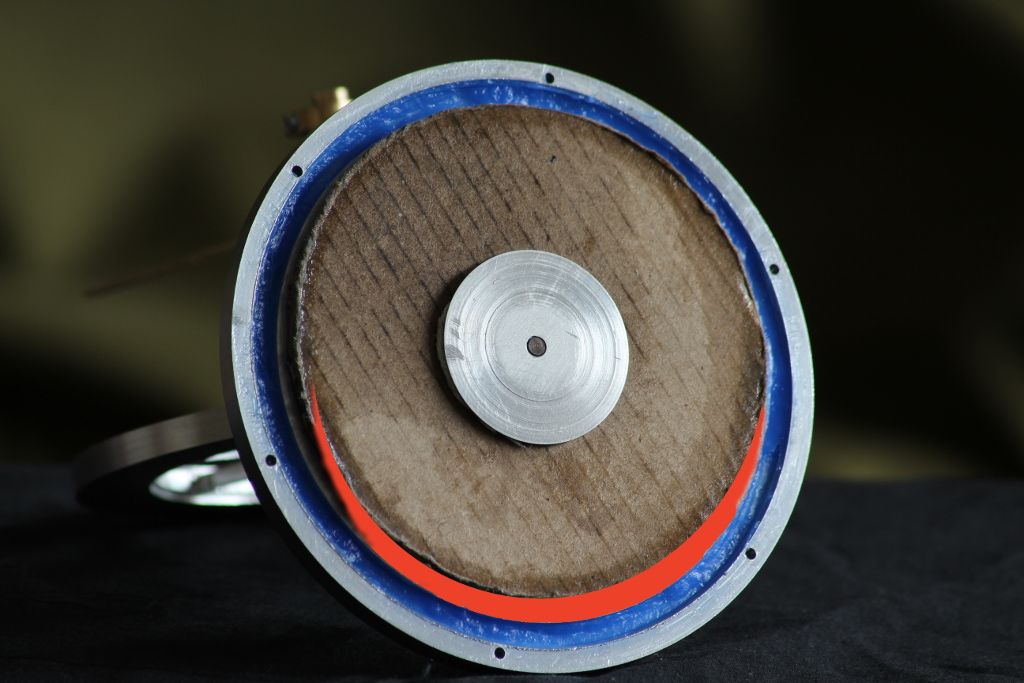

                          I've fitted a double thickness (4mm) cardboard displacer with edges sealed with a smear of latex glue. Still not running in either direction. (Until Howi's advice I'd only tried spinning it clockwise.)
                          Some more facts:
                          I followed Jan's design fairly closely. My acrylic tube is 96mm inside diameter. The other components are to spec except that the upper and lower plates are 1/4" (6.25mm) thick rather than 5mm. The flywheel is 1/4" thick rather than 7mm and I increased the diameter to 106mm to compensate. (Design says 100mm diameter.) The piston is mild steel rather than graphite but that's allowed. I used RTV silicone instant gasket rather than cut rubber hose to make the seals. The plate fixing spacers are drilled through and secured with 2mm stainless nuts and bolts rather than being tapped M2 at the ends with an air gap between.
                          The various bearing points have been de-burred. The engine was spun by hand and then given about 30 minutes drive with an electric meccano motor for "Running In – Please Pass"

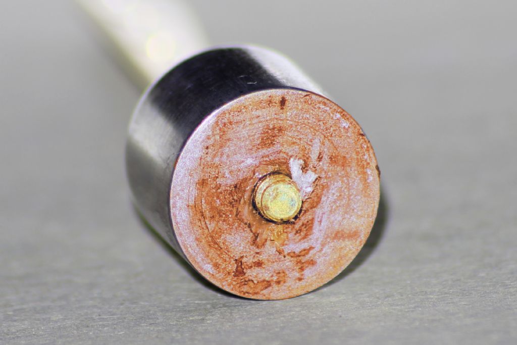

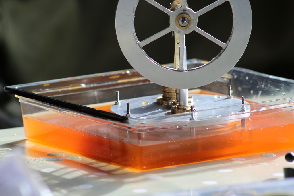

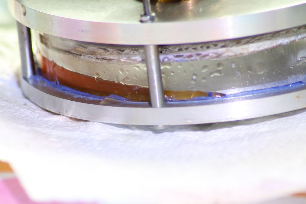

                                                    Wow guys, thanks very much. I repeated the leak test using water with a drop of washing-up liquid to make it wetter and some red food dye to make it easier to see. The engine's lower plate was immersed for 5 minutes.
                                                    The result may explain why the engine wouldn't run yesterday.  (Water Hammer!)
                                                    The cardboard displacer was ruined.

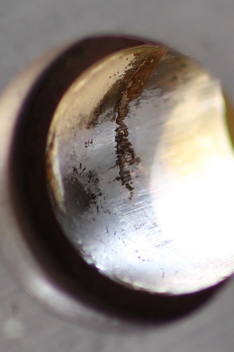

                                                    Stripping down the engine revealed more problems due to acetic acid corrosion. See what it did to the polish of the power cylinder bore!
                                                    It looks worse than it is, fortunately Duraglit made a huge improvement. The end of the piston was rusted again but the damage isn't serious.
                                                    I went out and bought Balsa and a Flat `At. Wearing a traditional cap in the workshop will multiply my meagre skills. Sadly I found that my traditional local ironmonger has stopped trading and I was unable to easily buy more silicone sealant.(I've gone off RTV Instant Gasket because of the fumes.) I've decided temporarily to use modelling clay as a sealant. It 's like plasticene but rather softer. I use it very successfully it to weather protect the nuts and bolts of an antenna system: it's clean, lasts outside for years and is easy to remove.
                                                    Noting advice above. I'm off to make a balsa displacer. Now I've spent money because of it I fully expect to fall over the missing polystyrene in the next 5 minute. I have the wherewithal to make a hot-wire cutter and may well end up trying it. Some of the other ideas are now in a queue because I don't want to change too many things at once.
