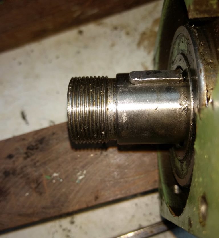

      I'm replacing the gears on my mini mill. There is a key on the mainshaft which is totally jammed. Of course there's almost nothing to grip. Pliers just slide off and risk damaging the key. What can I do to get it out??

          It would help enormously if we had a picture or two. The exact model of mill would also help. Knocking out a feather key can be fairly routine, but if it turns out to be a woodruff, you will only make things worse – for example.

              Image attached. I don't think it's a Woodruff (the curved ones?). The mill is an Amadeal XJ9512, it is the 'usual' mini mill available under several different brands.

                I would use a small chisel on the end and try to lever it up. don't worry about damaging the key it should be replaced anyway

                  If the key is a woodruff key ( a semi circle ) one way of moving it is to tap on the extrememe end so that it rotates to bring the other end further out of the keyway.
                  File or stone off any burrs that you may ahve already produced.
                  1 This should "unstick" the key. If it moves, with a small flat ended punch may it be possible to rotate it even further, even to remove it completely.
                  (Before searching to se where it has fallen )
                  2 There should be more material which can be gripped. If it moves, but does not come out completely.
                  Don't hammer so hard that the key is "mushroomed", or even worse so that the shaft is bent!
                  If the worst comes to the worst, you can make a new key!
                  Turn a piece of bar to the OD of the Woodruff key, part it off slightly too long, for careful filing afterwards ) to the correct thickness, and then cut in half . Not actually, since you want to finish up with one semi circle, cut and file away from the centreline, to produce the Woodruff key that you want.

                    Mole grips should be able to grip the key, whatever method you use 'gently does it'.

                      As Roy said, use a chisel to lever it out. You could clean the key with a file. The better way is to get a piece of key steel of the correct width and height, available in both metric and imperial. cut to length and finish with a file to fit. teh keyway.

                        Done! Once I realised how easy it would be to make a replacement if required, I got it with the Mole grips. It was just badly wedged.

                            For others in a similar situation, I have found that a sharply ground pair of pincers, gripping the key along its length and then using the pincers to lever the key out works well, for both plain keys and Woodruff.

                              Good old fashioned PINCERS – they will grip much better than mole grips (Other brands are available)

                                My favourite tool for this job – as long as you can get to the stage shown in the first picture – is an old pair of wire cutters. Grip the proud part of the key so the cutter edges run along the key, and tweak, levering the key out. Cutters with notches from cutting too-hard wire work admirably, and are also useful for removing tight split pins.
