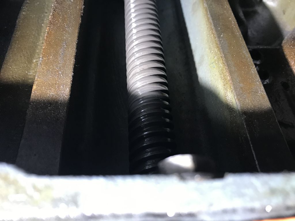

      I had the same problem and had to do a fair bit of research before finding a solution.
      The advantage of the silicone compound compared with normal greases is that there's no soap and it's completely insoluble in oils and coolants. It also sticks like snot on a blanket (technical term). cheeky

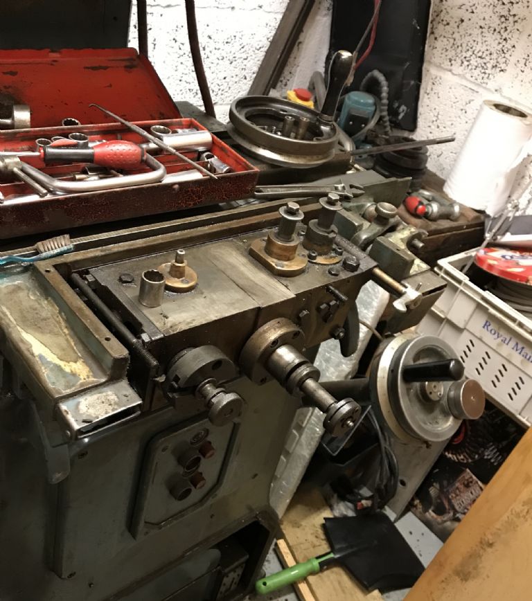

        Shouldn’t need to spin a big wheel. That photo is a used 180mm wheel – It measures about 170mm diameter and the wheel head wasn’t at the bottom of its travel
        removing wheel guards is a thing to only be done after careful consideration IMO
        #574734
        Mark Rand
          @markrand96270
          It wasn't the wheel guard I meant to be removed, it was the rear splash guard as J&S called it. The back of the guard that goes around the table.
          #574737
          Dave S
            @daves59043
            Ah. Good clarification
            Mine came without table guards, so I cobbled together something that mostly contains the mess.
            Did read like put a big wheel on it, take of the guard if it won’t fit…

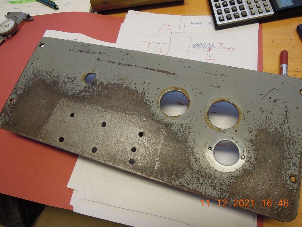

                  gerry madden
                    @gerrymadden53711
                    I haven't checked my wheelhead excursion yet but will do that later this week end and let you know. But by the sound of it I should be ok.
                    In the meantime I'm about to paint the valve cover.
                    Does any one know what these 7 1/4" holes would have been for ? Some are tapped and the alignment isn't that good..
                    Clearly something has been fitted at some time but not sure its important to me and at the moment all they do is let the muck in so I plan to plug them.
                    #575077
                    David George 1
                      @davidgeorge1
                      Gerry the holes in the table plate are probably for a jig to hold a dial indicator to set up job parallel to bed travel etc.

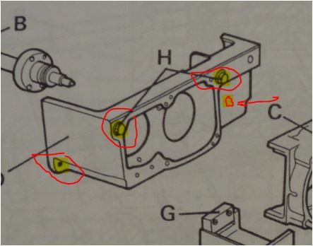

                        Evening all,
                        The refurbishment makes steady and very satisfying progress but had a minor hitch last night. I'm trying to remove the valve block cover which is the part shown in the pic below.
                        I have removed the 2 nuts designated 'H' plus two smaller cap screws located at the bottom left and bottom right corners of the cover. I thought that would be it, but there seems to be something else holding it pretty tightly near the bottom edge. I think this because I can lever the upper edge of the cover against the valve block and it will deflect off its mounting face by a mm or so. If I release the force the joint closes tightly. If it was just a sticking gasket I think that this would have broken the joint so there must be something else. The underside of the cover looks like this….
                        I have run my fingers up behind the cover but can't feel any screws holding the cover on from the other side…. but it is a bit gruesome back there so its possible I have missed something.
                        Just wondering if any one on here has done this job before and knows the secret to removing this part ?

                          It’s been a while, but I think mine was held on by 4 bolts and and a gasket, but maybe there was a couple of hidden nuts up in the back.
                          If your not in a hurry I can go look tomorrow.
                          I did have all the cross feed handle bits out of the way, but it looks like you have done that.

                              Gerry, I have done this job before but it's so long ago now that I cannot remember exactly what is holding the front valve gear cover on apart from the screws you have already mentioned. Perhaps there are a couple of dowel pins to locate it accurately although nothing is shown there in my parts manual for the machine. There is a dowel which appears to be through the top of the cover but you have probably already found this. You could possibly, and very carefully, insert a small screwdriver blade in the gap you can open up and use it as a wedge to part the castings. I don't know exactly, and the risk would be all yours, but that is the sort of thing I would be looking at unless something more obvious can be detected. Other than that, is that bush on the cross-feed screw not fixed to the valve gear cover in any way? Or, does the casting just slip over it? Again, no fixing is shown in the parts diagram.

                                Chris, ….mmmm… you may be right. Perhaps it is just a couple of dowel pins on the bottom edge….They might just need a more direct pull to get the cover off them.

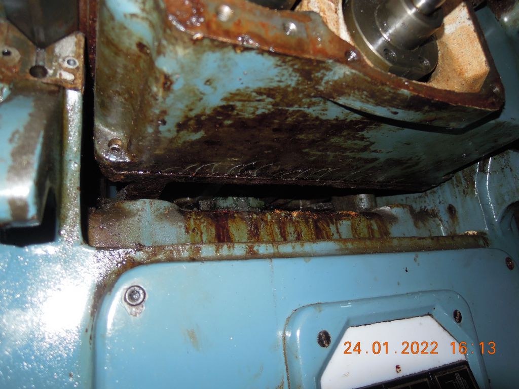

                                #582412
                                Dave S
                                  @daves59043
                                  I’ve not made it out there yet, shopping hiccup means I’m at rugby training with no2 daughter.
                                  had a poke about for photos on my phone – often take them to aid my reassembly of things.
                                  This is the only one I have with the cover off:
                                  I think there was something non obvious, but it’s 2 years ago… The photo does show how much of the mechanism I removed though, which may help?
                                  With luck I’ll get back in time to have a look, will certainly try to this week.

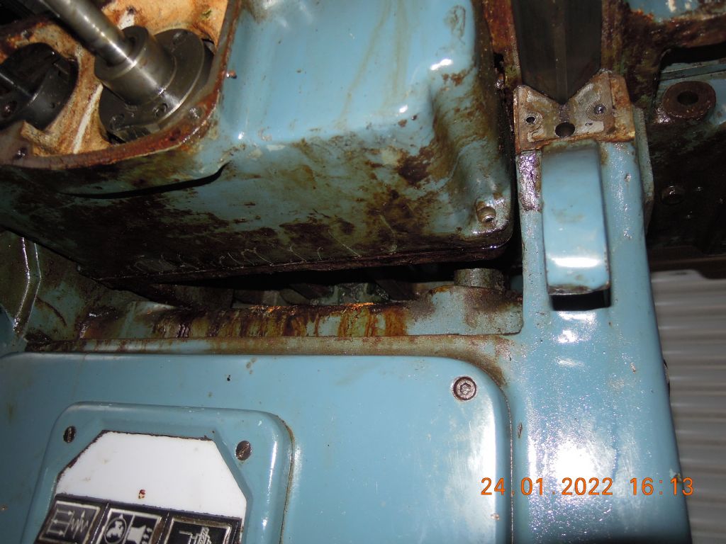

                                  #582568
                                  Dave S
                                    @daves59043

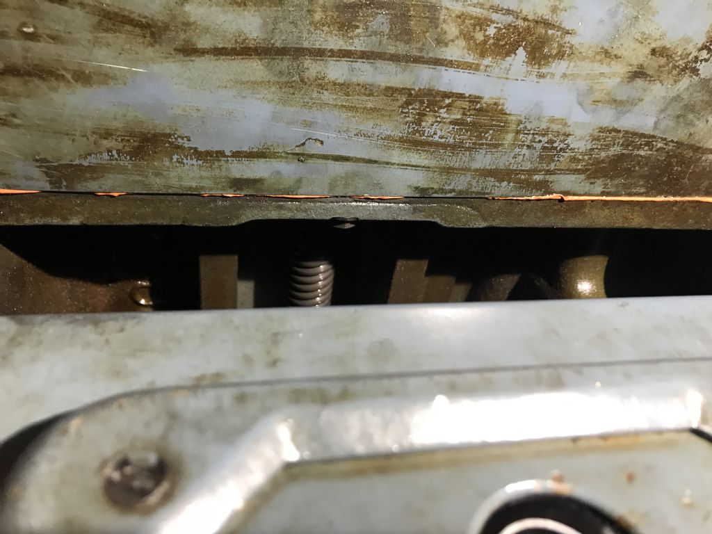

                                    Just checked. There is an extra bolt in the middle at the bottom.
                                    You can see it in this pic:
                                    It’s accessible if you wind the cross feed all the way out.
                                    Hope this helps.
                                    #582570
                                    gerry madden
                                      @gerrymadden53711
                                      It does Dave, that's excellent. Thank you for your efforts. I had another 'feel' tonight but nothing was obvious in the dark so I just need to look harder now that I know its there somewhere.
                                      G.
                                      #582573
                                      Dave S
                                        @daves59043
                                        I seem to remember thinking along the lines of that’s a really long edge to get a good seal on, bet there’s a bolt there somewhere… Of course when the cross feed is in pieces it’s a pita to wind it out, but unless you do it’s even more impossible to get to.

                                          Dave found and removed that 5th nut today! …Now I wonder how I could have missed it ! The valve cover is off along with bits of its gasket. That should be an easy one to make when the time comes.

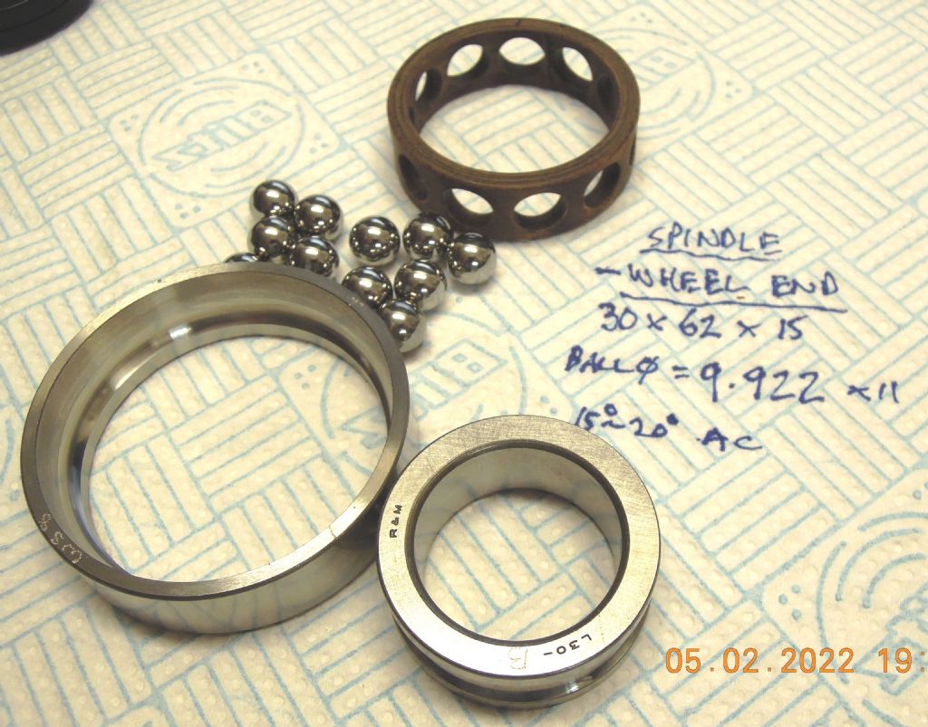

                                              For those of you who are interested in the insides of the J&S 540 wheel-head spindle, then here they are after a bit of a clean-up.
                                              50 year old grease abounded, but I think at some point the two covers had been removed and some fresh had been stuffed in. Even that looked and felt like it was at least 20 years old though! All the bearing seatings were good with no sign of creep or fretting damage. I was surprised to find the original Ransome and Marles bearings still in it. I stripped these too and was even more surprised to find them in a corrosion-free condition, especially as this unit doesn't have seals, only labyrinths.
                                              The pulley end bearing was in almost perfect condition with just a few random metal chip indents in the raceways. There was however just a trace of wear on the raceways of the wheel-end bearing from dust ingress. However both definitely good enough to go back in for further duty and I'm quite sure they'll see me out.
                                              Only one mistake so far – I forgot to measure the wheel-end spindle runout before I commenced the dismantling so now I don't have a target to meet or even exceed on the rebuild. Might need a little trial-and-error with ring positioning but good fun for a wet Saturday afternoon.
                                              Just a word of caution for anyone doing the same exercise. When you pull out the free-half of the spring box arrangement from the casting, put your hand over the housing and collect the 12 springs before you do anything else. I didn't and the inevitable happened. I found 10 quick quickly, but the other two had bounced some distance and landed in one of the wife flower pots where they blended in nicely with the soil.

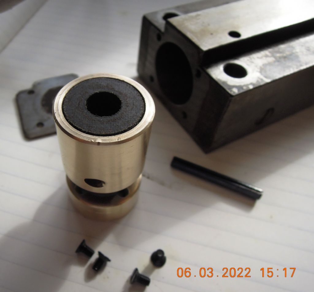

                                              #588591
                                              gerry madden
                                                @gerrymadden53711

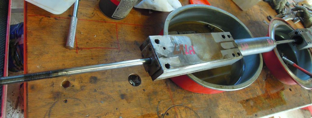

                                                I now have my table off and its being prepared for blasting and repaint. The ways look good, clear scapings cover the full surfaces and there is no damage or casting defects present. For the record the table weighs 55Kg.
                                                I'm now cleaning and expecting the ram. Its all fine (apart from a obvious covered-up manufacturing error). Although the machine didn't have excessive leakage previously, I'm thinking that now its all in bits I may as well fit new seals. They are basically just simple bushes pressed into brass sleeves. as you can see below.
                                                I would rather make something myself than buy new parts which cost around £50, but not sure about the material. I 'looks' like Tufnol, i.e. cloth impregnated, but its a little compliant, so its a kind of cloth impregnated with a hard rubber, as opposed to a phenolic. Would anyone know confidently what this material is or likely to be ?
                                                Another puzzle is this. The spare parts manual shows gaskets between the central circular section tube and the two outer square section tubes.
                                                The were no gaskets in mine, just spigots, and not particularly good fitting ones at that ! Could this be another build mistake perhaps ? Does anyone else have these gaskets here, and if so, are they fitted between the axial or radial surfaces of the spigots ?
                                                Since there is no means of controlled axial clamping between these 3 ram cylinder parts its difficult to see how axial gaskets could ever be successful in this situation but what do I know
                                                Gerry
                                                #588634
                                                gerry madden
                                                  @gerrymadden53711
                                                  Forget the question about the material for the seals. Further investigation shows that the ram seals are in fact proper 2-part hydraulic components which look like this:-
                                                  For the record the outer part has dimensions 9.5x 22.2 x 8.6 and back-up inner part 10 x 21.8 x 6.5. These should correspond to some imperial measurements of course and hopefully I should be able to find a cheap source somewhere on the net.
                                                  Gerry

                                                      Mine had gaskets as I remember having to find the gasket paper to make new ones.
                                                      Ill see if I have any photos for where they go – IIRC I didn’t pay attention, and made them for the wrong face initially…
