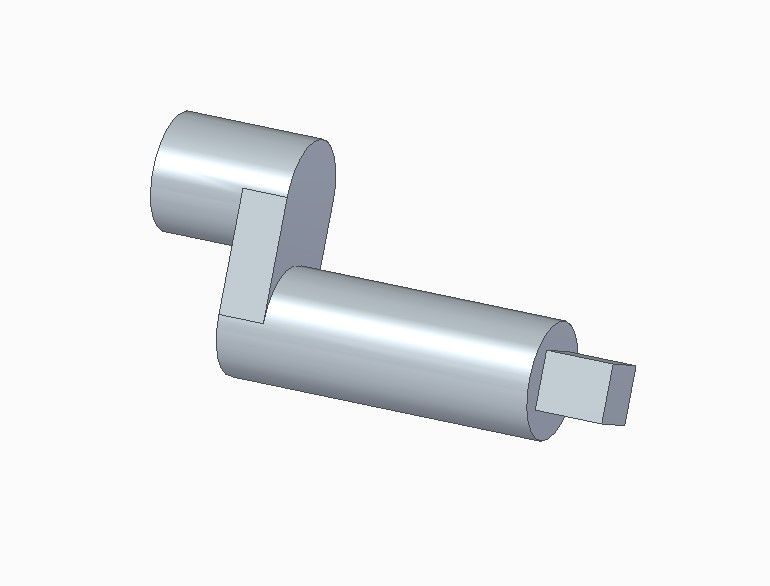

                                We've all assumed that Tony wants to print engineering objects,
                                And he isn't a fantasy fan:
                                Almost all 3D-CAD software will do the crank thingy. Not many CAD packages are strong on arty stuff, for which other software is better. Model railway layouts should be full of miniature figures, kiosks, seats, weighing-machines, clocks, lamps, and trolleys

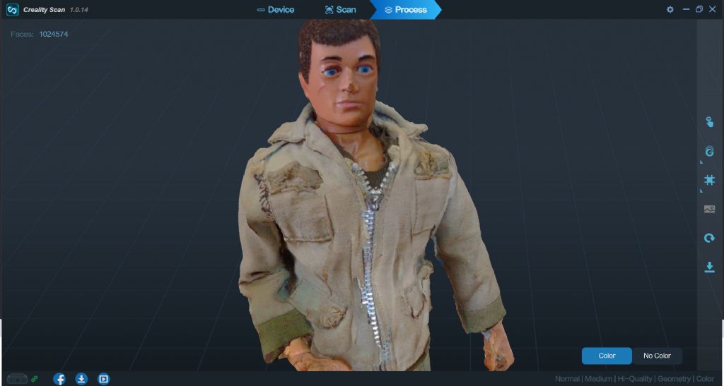

                                      To modify STLs you can use Blender. I find it VERY hard to use for all but basic operations, but people do amazing things with it.
                                      I've discovered scanning, and found that if I need 'crew members' I can dress up a 1970s Action Man (with gripping hands, realistic hair and eagle eyes, no less!), pose him, scan him and print out a smaller version.
                                      Look out for more details in a future MEW!
                                      Here's a teaser – this is a 3D scan not a photo, it can be rotated in three dimensions. It even captured his flat-ended nose (as a result of an accident forty-odd years ago).
