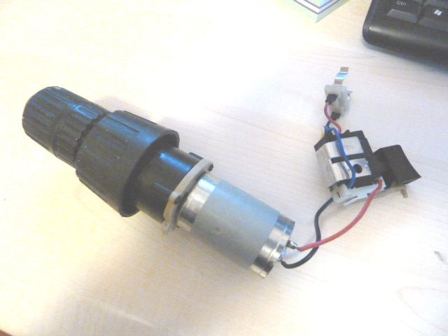

      I looked on Ebay recently for an auto reverse tapping chuck for use on my Mill (something like an Etco). I was amazed how expensive they were (£250 new), Then I looked at my defunct chinese cordless 18v drill/driver which has failed batteries and too expensive to replace. I bought this out of Aldis a few years ago, cheapo price about 20 quid, so I had my use out of it
      It has a 13mm auto chuck and the useful torque limiter. So I took it apart and was amazed to see that it is quite good quality, lovely little double sun and planet gear box, 100w motor. variable speed 0-500. So this will be reassembled with some external wiring t an 18v SM PSU and I shall mount it on a cheap drill stand I had for my power drill. Fix up with a control box for speed and direction.
      How neat is that – well I felt a bit chuffed anyway.
      and FWIW I'm sure that this system would make a good pwoer drive for my Mill tablep1010006.jpg

          I did a similar thing sometime ago, Robin. Usual thing – the batteries died, and new one cost more than the original drill, so I just bought a new one. The old one lay around for ages, then I needed to tap multiple holes in an ally block, so it was just the job. two small (ongoing) problems – The chuck was the usual auto thing, and not particularly good quality. I find it difficult to get it tight enough to stop the taps slipping in the chuck. Its OK up to a point (good safety feature!), but its annoying with anything over about M4, because it slips too much then. Maybe a chuck and key would be better. Other problem is the bearing for the chuck – its really not man enough, and there is quite a lot of side to side play if I pull the chuck around. So far its not a big problem, because the taps are started in a pre-drilled hole, and the pressure is axial, as in the original drill.
          I keep thinking about using the gearbox part to build a better machine – proper bearings for the chuck, and a geared or toothed belt drive, because the low speed torque is not so good using a variable power supply (and it draws a lot of current ! – I was lucky to have a suitable transformer, but they are expensive if you have to buy one.).

            Indeed I have got to find a power supply to replace the battery source. Now I read somewhere that Switched mode supplies dont like pwm speed controllers, probably due to high frequencies interfering . I havent found a discussion on this just now, but some quick test showed me that and 18v smps with a rated output of 7,5a dc wont power this motor. I guess the starting current trips out the overload protection
            Do you have any idea what sort of power these little motors draw. As a rule of thumb the current supply needs to be 6 times the fl running current, so it could be a lot of amps 10-20?

                I have a (huge) old tranformer which is nominally rated at 11V, 15 Amps. I have no idea what it was originally used for. I acquired it years ago to strip for the copper wire (another project), but never got around to it. I just used a solid state full-wave rectifier (easy to find), and I have a 5000 uF 40V capacitor to smooth it,. (It works without the cap, but a bit noisy for some reason).
                I have to admit the whole thing was not 'designed' – I just needed something to do the job in a hurry, so whacked it all together without much thought. As you can guess from my description, as it stands, it could be a bit lethal. It all sits in a wooden case, and the only protection is a fuse in the power lead. I did have a 25A fuse in the motor lead, but this blew sometimes, so eventually I just removed it. (I know – but its my shed, and I can take my own risks!).
                I can't say I have ever had problems with startup current – as you say, rule of thumb says 5 or 6 times running current. I normally switch on with no mechanical load, so the load current / inrush current is probably relatively low, so I guess this is the reason. May be a problem if I startup on-load (ie motor stalled – must try it sometime).
                As I noted before, transformers now are pricey – I did run it for a while on a car battery, albeit at reduced voltage, and it still worked Ok for me – a bit down on power (18V motor). (A battery is probably cheaper than a transformer these days! – use the guts of a 12V drill maybe?)
                I suspect smps supplies cannot start up under such a heavy load, but I have never investigated it.

                  you really should have a fuse on the output side – but its your shedthinking
                  I finally got a surplus psu from a defunct laptop to work, its 19vdc and 3.8A but it wouldnt run the motor directly, so I stuck a 10ohm power resistor which dropped about 4v and it work even with the speed controller. The psu I think kept shutting down and restarting probably cos of current spikes caused by the PWM..
                  Since then I sourced an industrial psu giving 15vdc and 16 amps for £35 so I think that will do the job and run several small motors. Its a conventional xformer psu with volt control and o/load protection, cost £350 new
                  Interesting is that dropping 4 volts across 10 ohms mean its only taking 400mA but then I havent got a scope so cant see whats going on
                  So I think ive got it sorted at last and ive got several of these old cordless things lying around

                    The motor may have looked like a short to the PSU when it was stationary.
