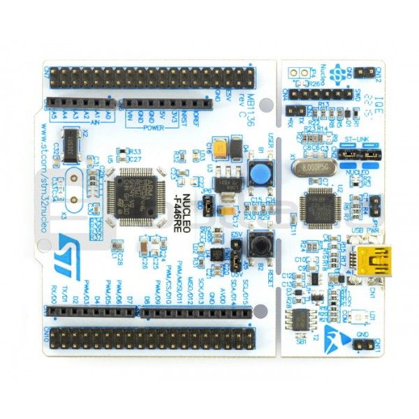

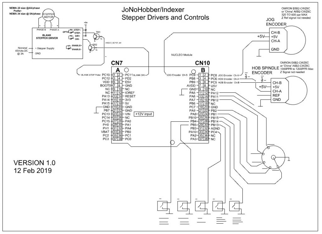

                            To re-iterate, the unit is based on an STM 32bit uP, using a NUCLEO module, similar to the Arduino type modules.
                            The right hand section is a USB based programmer for the main CPU, center/left. Open source ST-LINK programmer software from the STM site is used to program the module, on a windows PC.

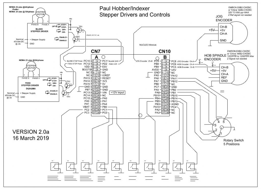

                            The circuits follow – note that resolution is limited in the size image I can paste, so some areas are repeated , zoomed in, for better viewing.
                            Circuits for the Hobber WITH FEED controls:

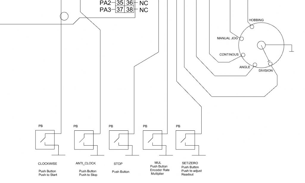

                            The pushbuttons with blanked text at the bottom are repeated next , zoomed in.
                            Circuits for the Hobber WITHOUT FEED controls:
                            Zoomed detail:

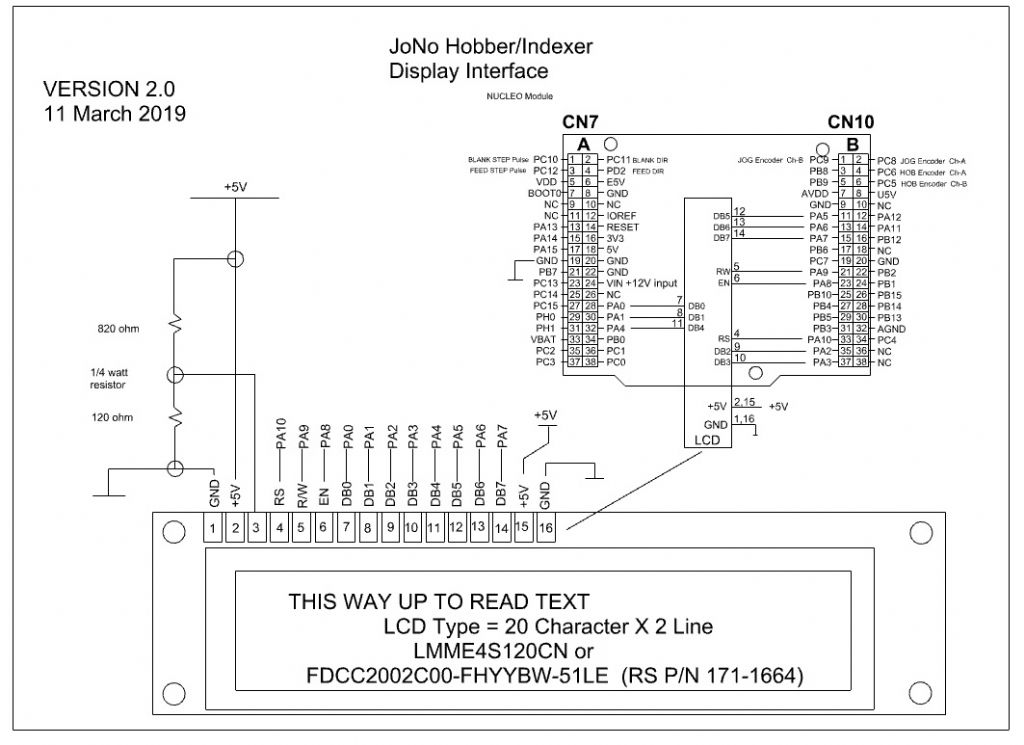

                            This is the Display Interface, common to both Hobber types:

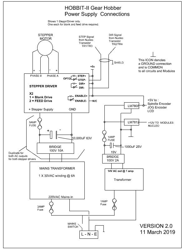

                            This is a typical Power supply for the unit – no part numbers since you can easily make do with what may be available to you:

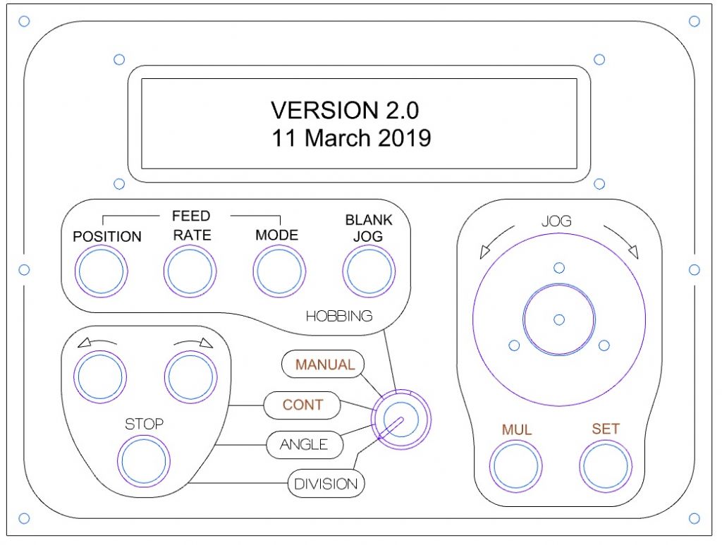

                            This is a sample front panel for a unit with Hobber AUTOFEED function

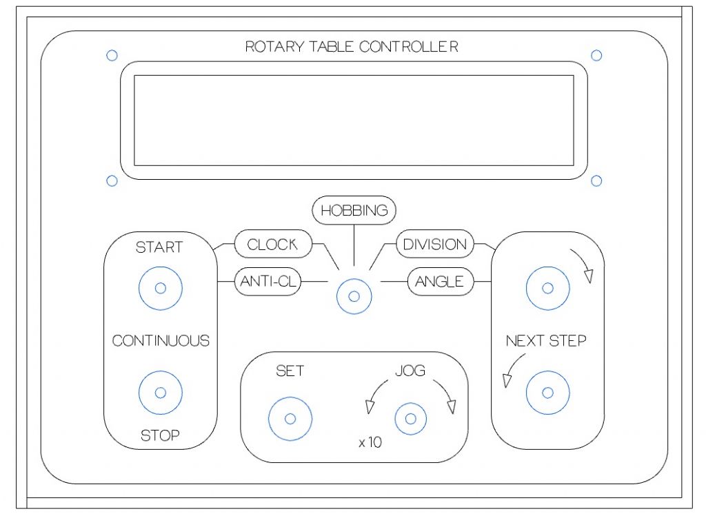

                            And this for a Hobber with MANUAL FEED function.

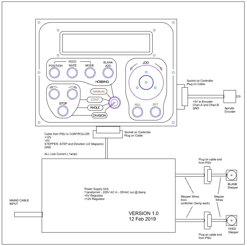

                            This shows the basic interconnection between items in the system: PSU, Hobber/Nucleo controller, Steppers, Spindle rotary encoder, etc

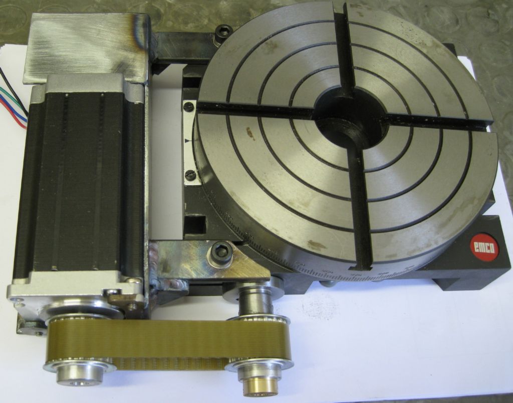

                            The un-modified rotary table at the start:
                            And the stepper fitted.
                            It is simple to change parameters in the software to cater for stepper pulse/rev, stepper to table gear ratios, table worm ratio, etc.

                              This describes basic operation of a hobber WITH AUTOFEED capability. It is easily understood from this which modes are not applicable to the non-AutoFeed mode type…
                              The Rotary Switch selects the various modes.
                              Each Mode may require the setup of some parameters, such as continuous rotation RPM, angular step size, No of divisions in the circle, No of teeth on the blank gear, etc.
                              When a mode is selected, the JOG encoder is active and used to set the required parameter. The SET/ZERO switch enters the parameter as the active such as number of teeth in hobbing, angular step size, number of divisions to step, rotary table rotational RPM, etc
                              The JOG wheel increment size on the display can be increased by xN (N depends on your encoder PPM..) by pressing the MUL pushbutton and rotating the jog wheel. Useful when big increments are needed.
                              Your Hobber, rotary table, may have different gear ratios – these can be adjusted.
                              Rotary Switch selections:
                              DIVISION
                              The JOG wheel is used to set a division increment, eg, say 360deg divided into 20 segments, ie each segment = 18degrees. Press SET/ZERO while using the JOG wheel to set the division value. Release SET/ZERO when done. When the ‘>’ or ‘<’ PB is pressed ( either clock or anticlock), the table will turn in that direction by the set division, for each press. The table can be set to a specific start point by first using MANUAL mode, below. Then selecting DIVISION again and using the ‘<’, ‘>’ buttons , the process will step on from that point each time. The number of division steps selected is displayed, as is the current cumulative division step number.
                              ANGLE.
                              The JOG wheel is used to set an angular increment, eg, say 5deg. Press SET/ZERO while using the JOG wheel to set the angle value. Release SET/ZERO when done. When the ‘>’ or ‘<’ PB is pressed ( either clock or anticlock), the table will turn in that direction by the set angle, for each press. The table can be set to a specific start point by first using MANUAL mode, below. Then selecting ANGLE again and using the ‘<’, ‘>’ buttons , the process will step on from that point each time. The selected step angle is displayed, as is the current cumulative angle value.
                              CONTINOUS.
                              The JOG wheel is used to set an RPM at which the table will rotate. Press SET/ZERO while using the JOG wheel to set the angle value. When the ‘>’ or ‘<’ PB is pressed ( either clock or anticlock), the table will turn continuously in that direction at the set RPM. Press STOP to stop rotation.
                              MANUAL.
                              This will rotate the table as the JOG wheel is rotated – useful when milling a radius, setting the table to a specific mechanical reference point, etc. Pressing SET/ZERO at any point in this mode will reset the angle display to 0 degrees as the reference start point.
                              HOBBING.
                              When selected, first use the JOG wheel to select the number of teeth to be cut, by pressing SET/ZERO and rotating the jog wheel. Release SET/ZERO when done.
                              5.1 BLANK JOG
                              The BLANK can be positioned as required by pressing and holding BLANK JOG, while jogging the blank with the JOG wheel.
                              5.2 FEED MODES
                              Since there is the option of Auto-feed of the cutter advance, the feed mode also needs to be set up ( Position, rates, auto/manual)
                              5.2.1 POSITION:
                              To position the cutter in relation to the blank, ie, almost touching, ready to cut, press FEED POSITION and use the JOG wheel to move the blank and cutter into the correct relationship.
                              5.2.2 FEED RATE
                              To set the feed rates ( in mm per blank rotation) press FEED RATE and use the jog wheel to set the value.
                              5.2.3 FEED MODE
                              The feed mode can be AUTO or MANUAL or NONE. This is selected by repeated presses of the FEED MODE button and will show on the display.
                              5.2.3.1 AUTO MODE
                              The feed will proceed in the selected mm per blank rotation and starts when the hob spindle starts running.
                              Pressing ANY other HOBBING mode button, eg, BLANK JOG, FEED POSITION or FEED RATE will immediately CLEAR the feed rate to NONE and if in AUTO-FEED, FEED will STOP – no AUTO feed will take place and the JOG encoder will not cause manual feed. Use FEED MODE to re-select the desired feed mode.
                              The FEED Mode can be changed on the fly, with the machine running or not. This allows manual take-over of feed, or AUTO from manual, or change of feed rate, and then back into auto, etc.
                              5.2.3.2 MANUAL MODE
                              In this mode the JOG encoder will drive the FEED axis Stepper. The JOG wheel is disconnected from ALL other functions and only generates FEED increments. Pressing ANY other HOBBING mode button, eg, BLANK JOG, FEED POSITION or FEED RATE will immediately CLEAR the feed rate to NONE, and the JOG encoder will not cause manual feed.

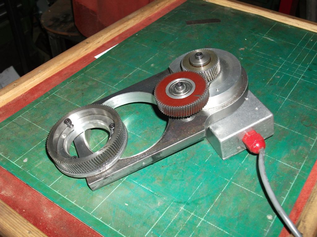

                                  In my hobbing set up on a Warco A2f machine i use this part of the
                                  spindle to attach a split collar turned in situ to mount a drive gear for an
                                  optical encoder ,the encoder bracket clamps around the quill and is
                                  seen here in the photo.
                                  Above 18 dp the hobs are around 55mm dia and you may need a
                                  substantial rotary table to cope with the cutting loads.
                                  I only cut up to 1,25 mod or 20 dp as seen in the photo here ,the
                                  set up here is much more rigid than any rotary table.
                                  More photo's in the the album gears.

                                      The other end of your gear size range at 15 tooth ,with a 2.500 inch diameter cutter
                                      you would be at about 150 rpm , with the Vertex table at 90 to 1 the stepper
                                      motor input to the table at 1:1 would have to run at 900 rpm,i don't know
                                      if that is possible ,my own hobbing unit has only a 5:1 reduction between
                                      the stepper motor and the work shaft but i mainly cut small gears and have
                                      hobs from 0.3 mod to 1.25 mod and 20 DP and sometimes cut as few as
                                      5 teeth ,so at times the cutter speed could be around 400 rpm.
                                      There is some more information on my own hobbing setup in
                                      MEW 193.

                                        Thanks for all the information Joe,
                                        Got interested in this from model engineers workshop 303,this is exactly what I could do with at home !
                                        The hobbing version , I just need the code to program to the nucleo board …the mechanics and electronics I can do and understand , Just the program code, I wouldn't know where to start !!
                                        If I could please get some assistance with that , I could get ordering the needed parts .
                                        Gary
