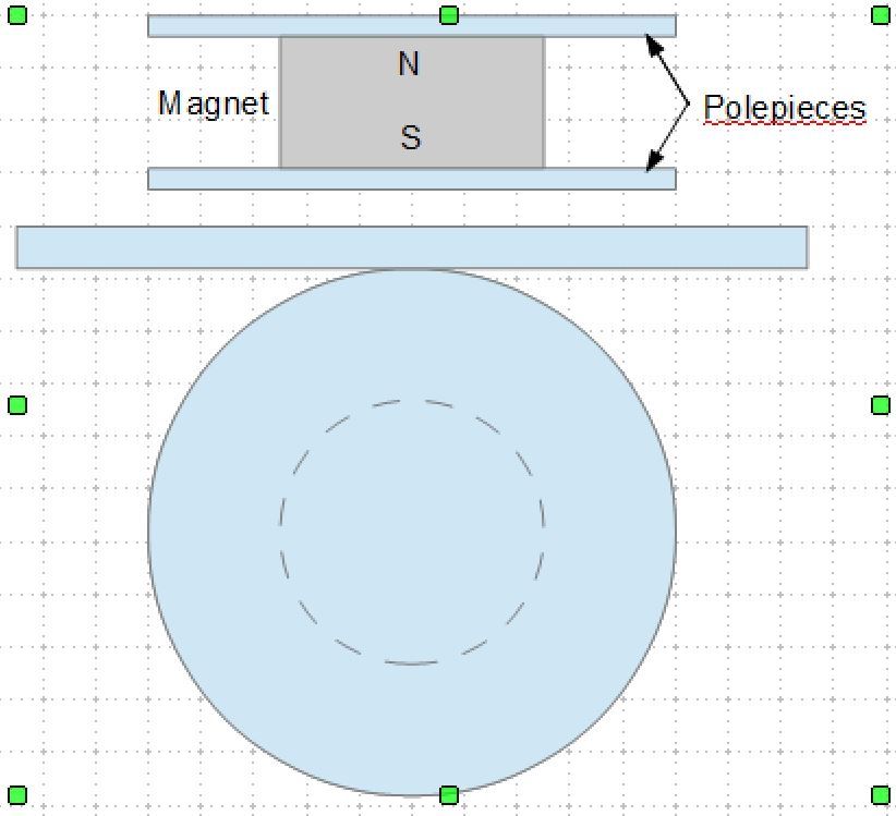

                    This is my mental picture of the arrangement. The rollers are two soft steel discs that form polepieces for a strong short cylindrical magnet mounted coaxially between them. If the contact is good virtually all the flux from the permanent magnet will flow through the polepieces, and establish a magnetic field in the space outside them, mainly concentrated in the air gap.
                    The lower picture shows this hanging from a flat soft magnetic plate. Since the plate and discs are in contact at the tangent point, most of the actual flux will flow through this point as that is the path of minimum reluctance. There will be some flux in the gap close to the contact point but it will fall off rapidly with distance. If there was any imbalance between the forces on each side of the contact point then the roller would move on its own – symmetry ensures it won't move.
                    In a real suspension the radius of the discs would be much larger and we will only need a small proportion of the circumference, but if we made sure that there was enough that the movement of the contact point is only a small proportion of the width I would guess there would still be no net magnetic force – given a suitable field analysis program we could compute this.
                    So I don't think that it's obvious that the system won't work at least from a magnetics point of view.

                      I'm with John, I think it works in principle. The difficulty is stopping it going walkies. My only suggestion is a set of very thin metal tapes wrapped round curved members coaxial with the pole pieces.
                      #659486

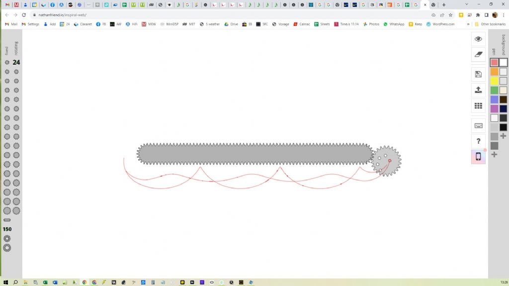

                        Just in case there is still any doubt about what is going on here, it might be worth digging out your old Spirograph set and playing with that. I found an online Spirograph sim that illustrates the point with a tad of imagination:
                        The two traces in the pic are formed by (1) using a point close to the circumference of the roller (trace near enough cycloidal), and (2) a point close to the centre of the roller (trace approaching a flat line). It will be no surprise that if you trace the path of the centre of the roller, it would actually be a straight line. What the sim doesn't allow, but which you could do with a real spirograph, is to strap a larger wheel onto the smaler one to allow you to see what happens when you trace a point that is outside the circumference of the roller – e.g., a point on the "bob". It doesn't take much to visualise what the trace looks like – apart from anything else, on each full rotation it passes through the horizontal plane, performs a retrograde loop, and then passes back through the horizontal plane.

                          Tony, nice! What is the tool called please?
                          #659488
                          Tony Jeffree
                            @tonyjeffree56510
                            https://nathanfriend.io/inspiral-web/
                            Incidentally, my observation that the centre of the roller follows a straight line should tell you that the centre of mass of the bob needs to be on the circumference of the roller (earlier on there was some uncertainty as to whether the roller radius or diameter should equal the pendulum length – clearly it has to be the diameter, or the bob would travel a straight line path.)

                            #659490
                            Tony Jeffree
                              @tonyjeffree56510
                              Of course, a moment's thought about the wheels on a car would have brought you to the same conclusion. A point on the tread follows a near-enough cycloidal path (give or take the flexibility of the tyre), but you'd better hope that the wheel axle doesn't follow a cycloid, or it is going to be a rather bumpy ride!
