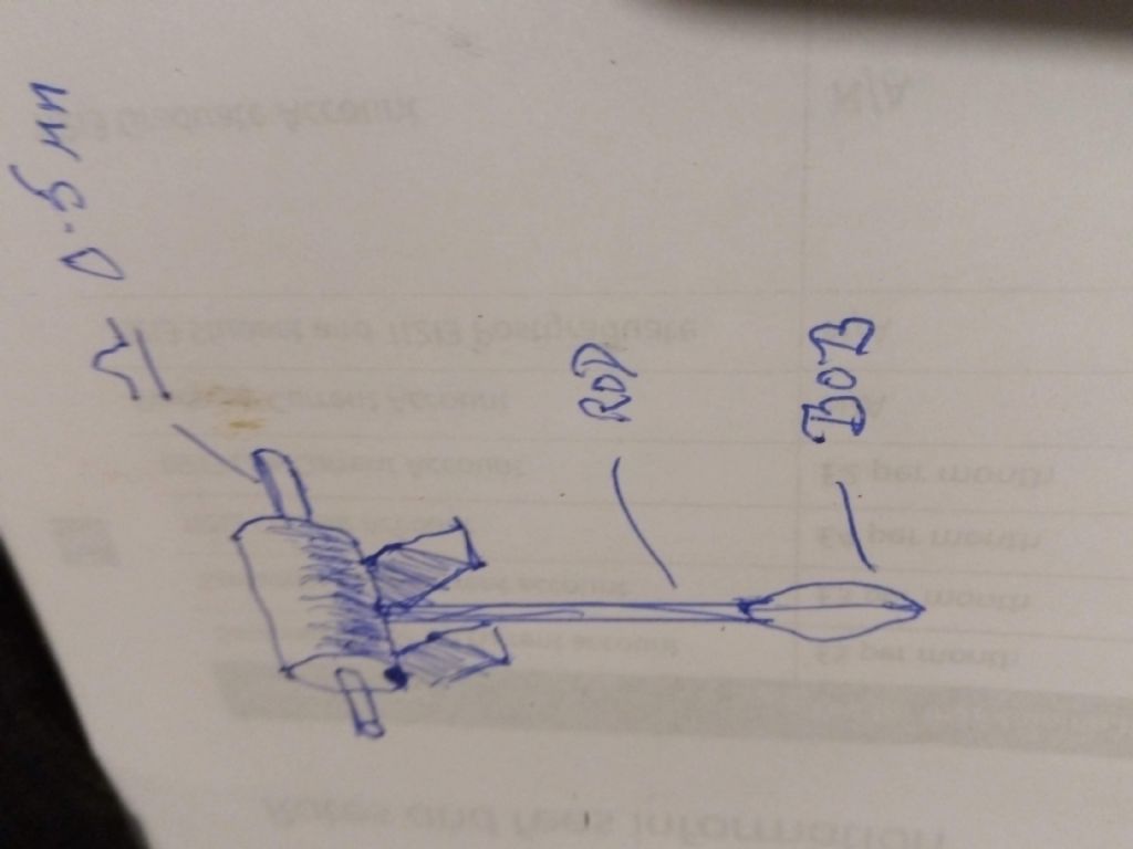

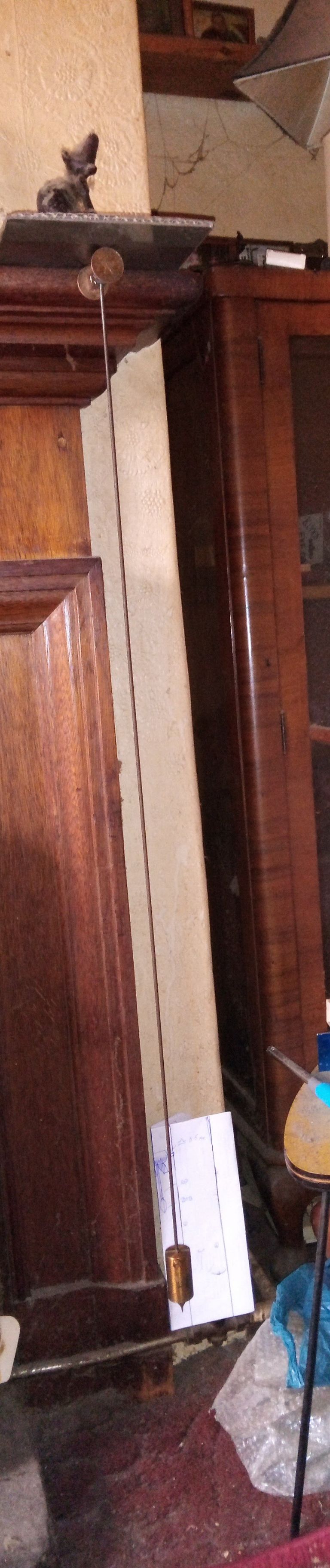

Posted by david bennett 8 on 28/08/2023 10:43:02:
Posted by Michael Gilligan on 26/08/2023 22:12:53:
A nice friendly Moderator might rotate that picture for you, Dave

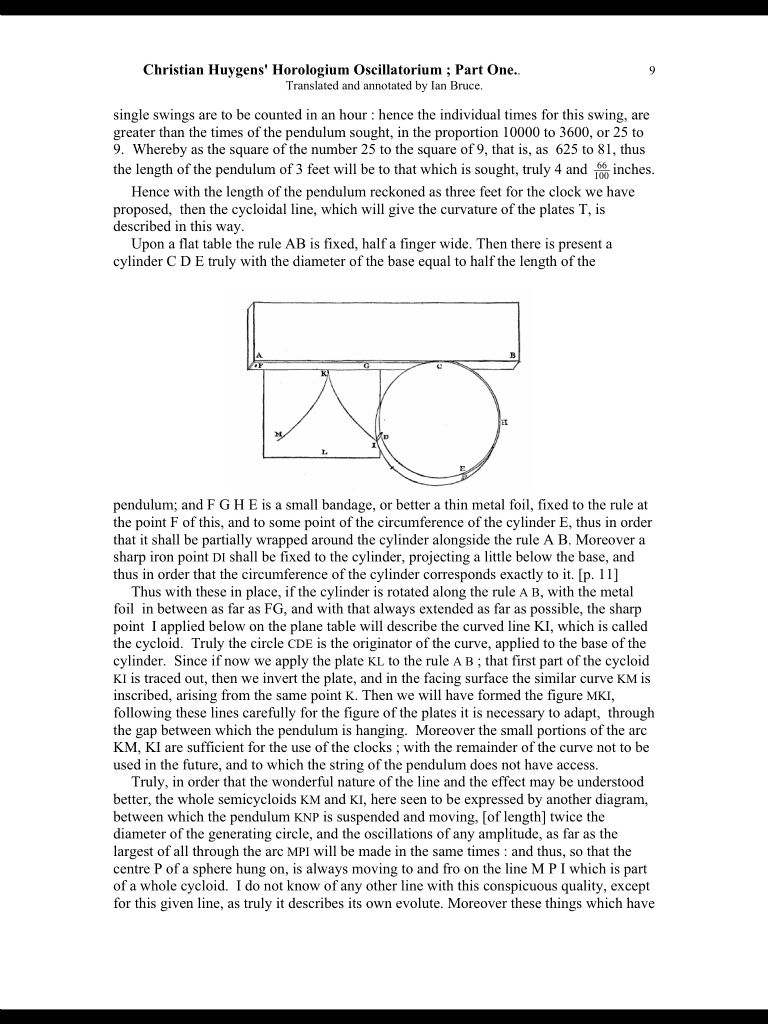

Meanwhile … I think the first problem is that the radius of your cylinder is too small
For the geometry to work, that radius would be the same as the length of the pendulum

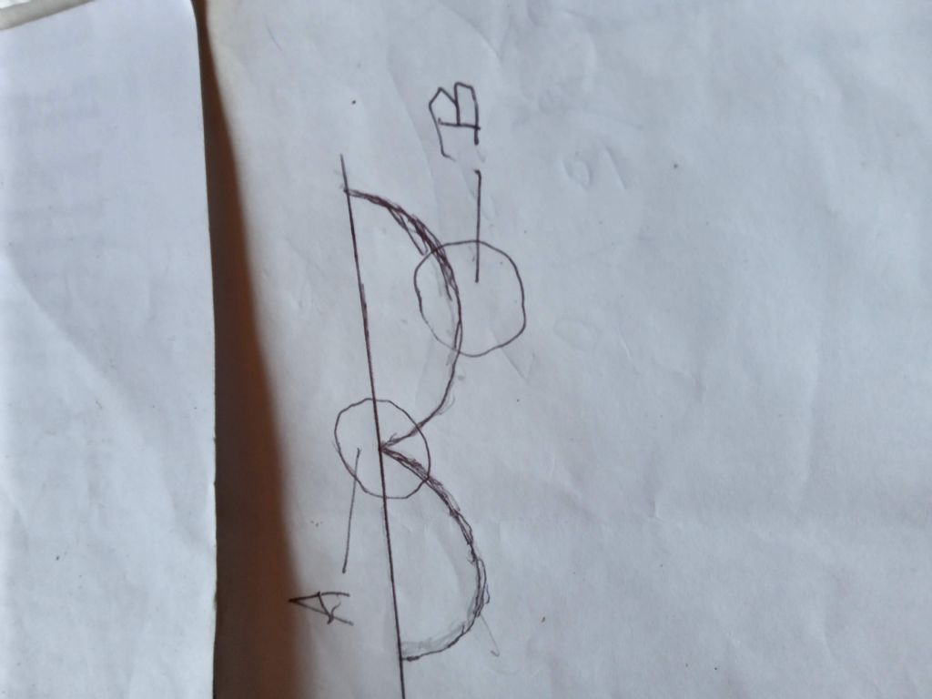

Michael, are you sure? I cannot reconcile this. Surely a roller of any size on a flat plane must produce a cycloid. The bob must follow this shape.
dave8
To be honest, Dave … no I’m not sure:
… It was a knee-jerk reaction, and I would be perfectly happy to be proved wrong.
… I was just thinking back to Huygens’ original, which is lodged firmly in my mind.
Please experiment, and please advise !!
This is not it … but is a delightful image:
https://commons.wikimedia.org/wiki/File:Cycloidal_pendulum_demonstration.png
