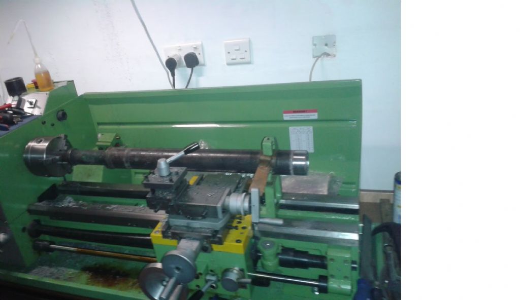

                                          I think the spindle bore is never large enough! but I usually make do with what I have, especially for a one off.
                                          Can't remember exactly what I was doing here, I guess it was shortening a cardan shaft… oddly enough it didn't come out too bad!

                                            Agree with ChrisB, however large the bore you will always want it to be a few millimetres larger.

                                                    I would agree, I have 38mm and sometimes wish it was bigger, in fact I just wish I had a bigger lathe
                                                    Just looking at your photo made me realise I have never used the steady
