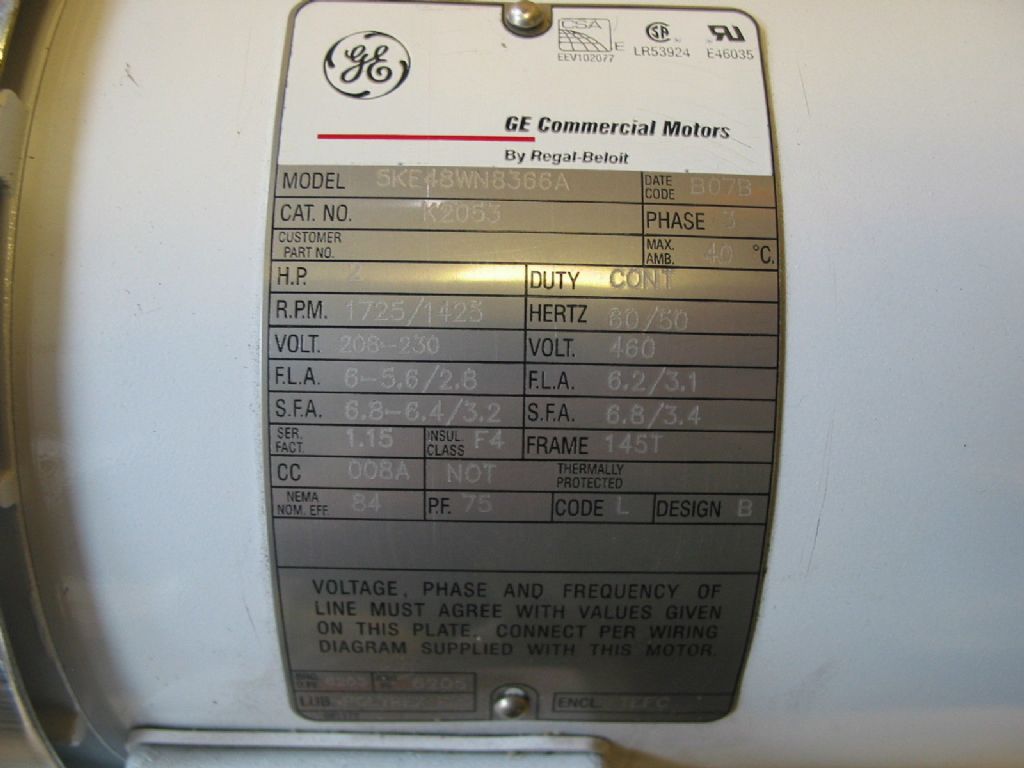

  • #248110
    mark smith 20
      @marksmith20
      s-l1600.jpgHi , Im always unsure when i look for suitable motors and especially the electrical aspects of machine tools.But is the motor in the photo suitable to run a milling machine through an inverter??
      I notice it says there is no thermal overload protection is that a big problem?
      Its a washdown motor but i like the idea of the extra protection from the environment you get with these motors as my workshop isnt exactly ideal and often gets damp .
      Thanks
      Edited By mark smith 20 on 26/07/2016 09:54:53
      Edited By mark smith 20 on 26/07/2016 09:56:18

        #248113
          It's dual voltage, and from a good manufacturer
          … So my answers would be:
          Q1 = YES
          Q2 = NO
          Edited By Michael Gilligan on 26/07/2016 10:29:30
          #248121
          David Jupp
            @davidjupp51506
            All the NOT protected means is that there is neither a thermo-switch, nor a thermistor embedded in the windings to wire back to the control terminals of the VFD. Modern VFDs provided a lot of protection anyway if the motor rating information is set correctly (some can even measure/calculate this for themselves). If planning extended running at low speed, or lots of stop/start cycles in a short time, extra thermal protection might be more important.
            I wouldn't be worried about a little damp (as long as your cable glanding is sound) – standard TEFC induction motors are often installed outdoors with no weather protection.

                #248130
                not done it yet
                  @notdoneityet
                  Anything that is safe and works would be fine. Start with connector strips and build from there if there is nothing available commercially.
                  Only twelve wire connections and three or five link connections, so not too difficult. Better screw clamp connections would be better than the usual cheap strips with screws into the conductors. Fitting good connection terminals to each wire is also safer.
                  The question of suitability for any particular milling machine? Yes. But not to all.
                  MG,  looks like a US product.  Might be OK, if you are that side of the pond, but a bit hefty to import to the UK, I would think.
                  Edited By not done it yet on 26/07/2016 12:02:24
                  #248132
                  Andy Ash
                    @andyash24902
                    I would have thought that although it is rated with dual voltages, it could still be used with an inverter.
                    It is common for three phase motors to be capable of being wired either star or delta. The impedance of the winding is different in either configuration. The rating plate should say if the rating is star or delta. If it does not, you would probably assume that the rating is for delta. This is how larger/older motor rating plates work, to allow for star/delta starters.
                    In your case the label inside the connection cover implies that the two voltages on the rating plate are for delta and star respectively. I'd say that you can use that motor with either a three phase or a single phase input inverter.
                    It does depend very much on what inverter you obtain to use with it. Generally an inverter with a single phase input will only have a fairly small output voltage rating. A three phase to three phase inverter would normally have a much higher output voltage rating. This is not a rule, just an observation.
                    To compensate and get broadly equivalent ratings from a motor at different voltages you would wire 240V delta and say 415 star. If you just want the maximum from the motor, wire delta whatever the supply. If you want efficiency and/or low inrush wire star.
                    There is absolutely no reason not to use a motor like yours with an inverter. You should do some simple experiments however. Get a current clamp and verify the rating plate data. You can also get thermistor protection relay packages from people like ABB automation. These can act to stop the motor in thermal overload conditions. That might be quite important with a fully sealed motor, like this. Obviously it must have poor airflow.
                    The connections you will have to buzz out. It looks to me like someone has written the terminal numbers on the wires. Check them obviously, but there is no reason not to use 10A marathon/choc block inside the box to make connections.
                    You should expect it to work out such that low voltage is the delta connection and high voltage is star connection. If it doesn't something is up.

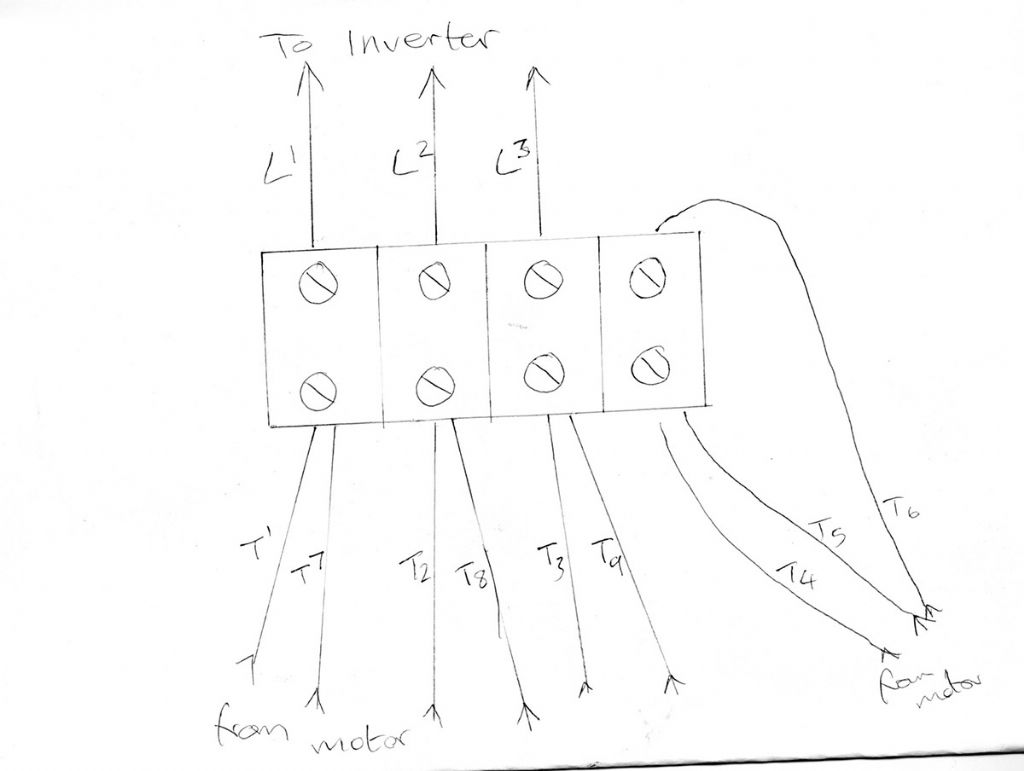

                                                #249240
                                                mark smith 20
                                                  @marksmith20
                                                  Posted by Martin Connelly on 26/07/2016 13:33:13:
                                                  I'd use a rigid type terminal strip rather than the soft nylon type, they are more like the material usually found as terminal blocks in motors and may be more resilient with regard to fretting due to vibration.
                                                  **LINK**
                                                  Martin
                                                  Hi Martin, so which of those on that link do i need, you mention 2 wires on one side and one on the other????
                                                  Heres my idiot understanding of the wiring is that right or completely wrong.
                                                  Edited By mark smith 20 on 03/08/2016 15:41:54
                                                  Edited By mark smith 20 on 03/08/2016 15:42:46
                                                  #249285
                                                  mark smith 20
                                                    @marksmith20
                                                    Anyone??
                                                    #249300
                                                    mark smith 20
                                                      @marksmith20
                                                      Really need advice on this,am i on the right track? Can a 3 section block be used and the T4 T5 T6 wire be simply twisted together seperately from the block and one of those twist cap wire connectors used??
                                                      Thanks
