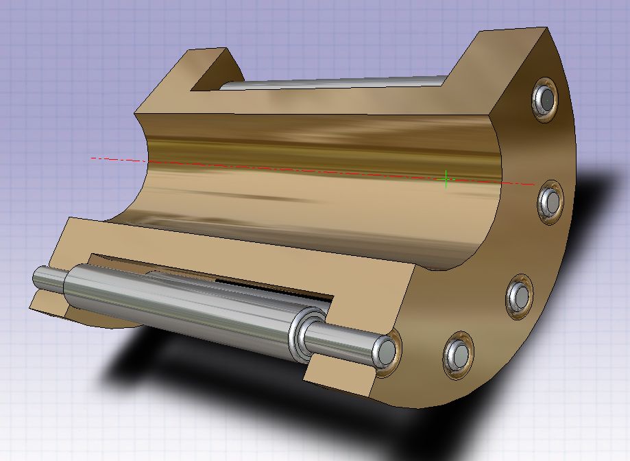

      There are four lantern pinions in my skeleton clock. The pins were a press fit of steel into brass, and unlikely to work loose.
      Although it’s highly unlikely I’ll make any for reasons I’ve mentioned on previous occasions, I’ve pondered about the benefits of trunnion-style pins as shown in this illustration.
      The pins could roll over wheel teeth instead of sliding with the obvious benefits and disadvantages …e.g. assembly of the pinion, lubricant spreading to the wheels, etc.
      Any thoughts?
      Sam

        Lantern pinion with trunnion pins

          Looks impressive but difficult to make, particularly in small sizes. I also wonder if the rollers would actually turn easily on the pins ?

                I am just wondering if the surface contact area between a wheel tooth and a roller would be sufficient to overcome the friction between the roller and its pin, so that it will revolve if you see what I mean.
                It would be an interesting experiment to prove it either way though.

                    As you suspect with clocks being low powered devices you need to worry about drive energy rather than simply thinking about friction.
                    If you have a plain bored roller on a plain pin the bearing surface area will be large correspondingly multiplying the actual friction. Probably need to reduce the plain pin to a set of ridges, perhaps three, to cut down the bearing area and drag.
                    The roller won't be turning with constant velocity either. It will speed up and slow down as the gear tooth moves past it. Acceleration and deceleration takes energy. The larger the roller the greater the demand.
                    Maybe plain pins in jewelled pivots at each end would run easier. Good luck with making that!
                    Although lantern pinions are known to be somewhat inefficient compared to close tolerance involute gear pairs the actual effect is strongly influenced by size. Small ones wit appropriately shaped gears can be pretty good. As everything is rotating the contact between gear and pinion is not simple sliding.

                      Lignum vitae [self lubricating] on brass pins …
                      See detail at about 2m:20s here: **LINK**
                      P.S. … Igus Drylin might be a reasonable modern substitute.

                            There's something I don't get about lantern pinions. AFAIK they mesh with standard "cycloidal" wheels. Now, "normal" cycloidal pinions actually have the only true cycloid in the gear, the straight radial flank of the dedendum. The addendum of the wheel, which is a circular arc, engages with the straight pinion flank when on the line of centres and stays engaged until the next wheel tooth engages. The pinion addendum is also a circle, but shouldn't do anything and not touch the wheel – it's just there to keep the pinion tooth out of the way.
                            So what is the logic of replacing the straight cycloidal dedendum with a circular pin, and why use the same wheel tooth form which is normally expected to "roll" on the straight part of the pinion tooth? I see that for example Thorntons, doyens of clock tooth cutters, don't have a version for lantern pinions.

                                  Yes. As drawn it can't be made. One flange would have to be removable. Lubricating when sevicing is needed would be a problem as one flange will be adjacent to the wheel.

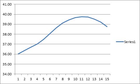

                                            My back-step is in regards to velocity ratio. I had become rather tired of attending to all the manual (CAD) iterations and abandoned the exercise when I got around to messing with lantern pinions.
                                            In that case, I retained the number of teeth, the lantern pinion having 8 (eight) pins (leaves) meshing with the John Wilding’s 290 tooth large wheel. The teeth of the latter being of conventionally accepted cycloidal design.
                                            Consequently, I can only show what was happening where Mr Wilding’s pinion was cycloidal not a round pin.
                                            The graph shows that the velocity ratio (theoretically 290/8 = 36.25:1), gradually increases to almost 40:1 as a single (large wheel) tooth makes its transition. Then, as the ratio gradually decreases, surprise, surprise, the ration drops (from 38.77:1 to almost 36.25:1) as the next pair of teeth/pins meet.
                                            I'm obliged to split this thread a second time …

                                            Sam Stones
                                              @samstones42903
                                              Tell yah wot … split three times … it's taken me twenty-five minutes to get this b******y graph into the thread.
                                              Cobbled in Excel, it went into MS Word where I prefer to edit, and then into Photoshop, before becoming a .jpg file and palatable for this forum.
                                              Now, if you haven't lost interest, you'll have to go back to the text on the previous page. EDIT Now on same page,( Jason)

                                                Sam, worth noting that if you paste an Excel plot into Powerpoint and right-click on the image, there is an option to "Save as picture", you can select png or jpg.
                                                When you say "John Wilding’s 290 tooth large wheel. The teeth of the latter being of conventionally accepted cycloidal design." I assume you mean the circular approximation to cycloidal addendum?
