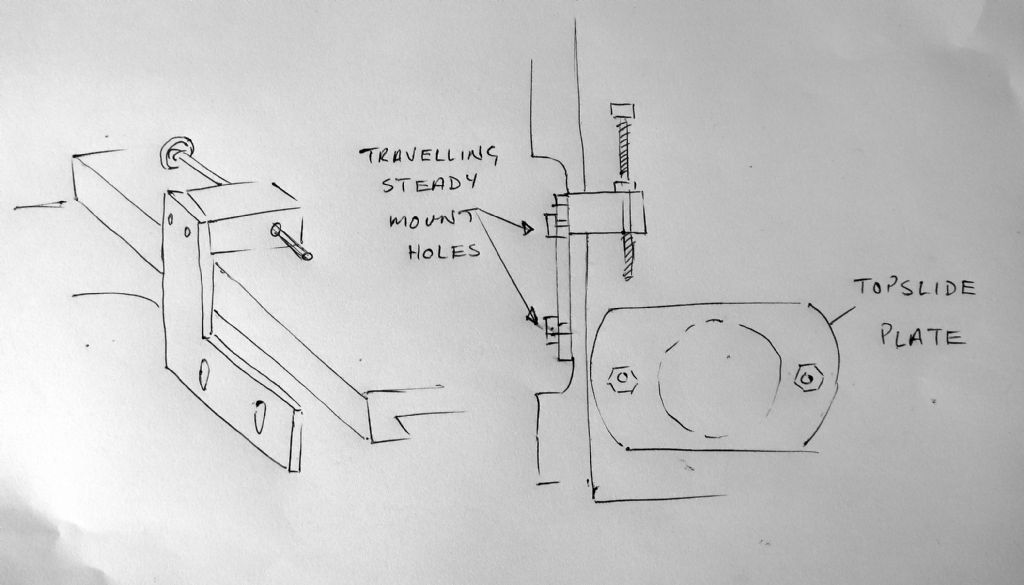

      Forgive the truly appalling 'fag-packet' sketch.. ..I hope there's enough information for a man of your experience to see what I'm driving at, and how it might be made to work – something I've been pondering for my own ends..
      The bracket / block should just clear the cross-slide body, I think it will be okay as something to bring the slide to a stop against. rather than crash into with abandon..
      ..I'm rather assuming that your lathe has a pair of bolt holes in the lower front of the saddle?

      Tony Pratt 1
        @tonypratt1
        Trouble with driving a screw driven slide against a stop is that you can easily ‘overcome’ the stop so losing repeatability

                        Apologies for failing to report back on this. What happened was that I found that the repeatability of the QCTP was indeed much better that I had supposed as you suggested – perhaps not half a thou, but good enough. So I ended up turning in the normal way, with the aid of the DRO and a bed-mounted carriage stop.
