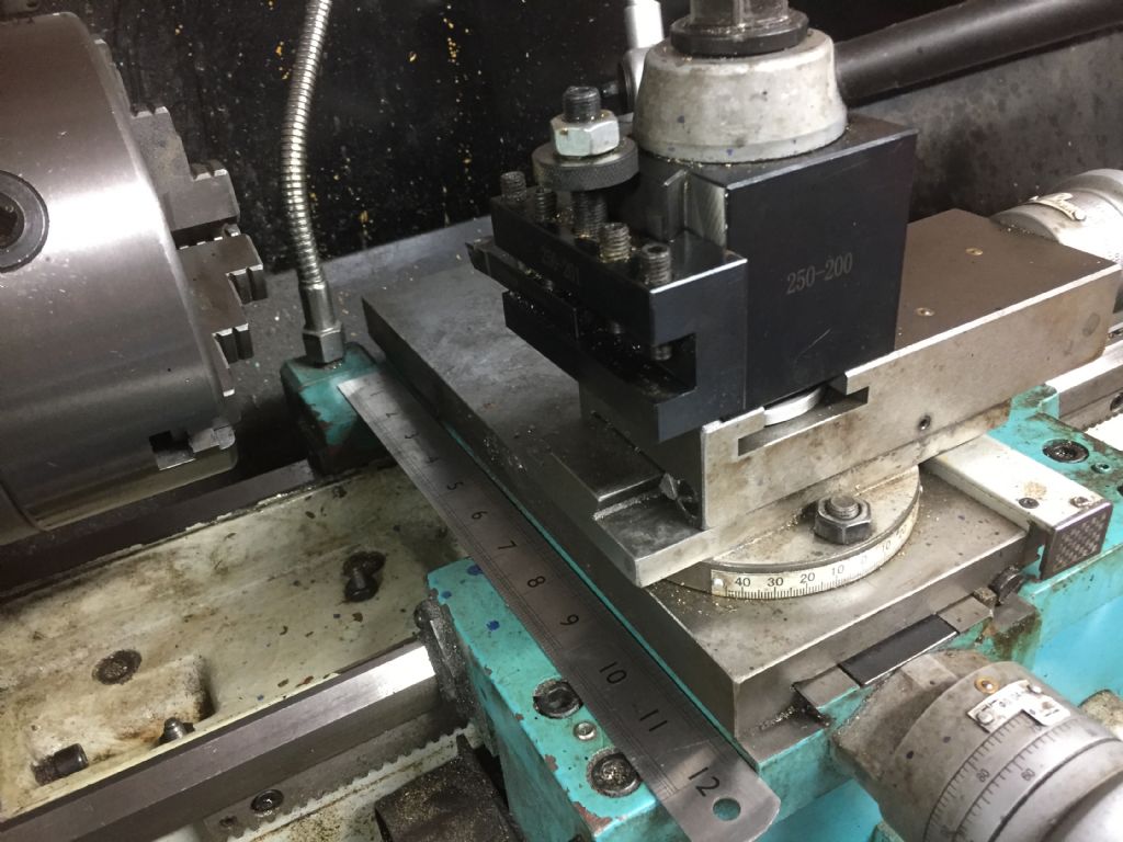

                                  I't's the cross slide he needs a stop for to give fixed diameter, suggested early on in thread.
                                  Edited By JasonB on 23/08/2021 14:16:34

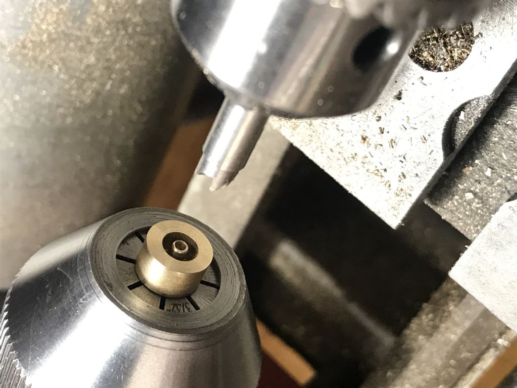

                                    @daves59043
                                    In brass its a fair bet that for 12 an unhardened steel tool will last.
                                    This:
                                    was made to produce a stem tube and crown guards in brass:
                                    Its much smaller, but its not really any different in process. Given the tool is still silver coloured I almost certainly didn't heat treat it.
                                    Make the hole the correct depth and it wont overfeed.
                                    I would bore a suitable hole in a piece of steel bar, ensuring it was the correct depth, then just use a hacksaw /files to gash the teeth. Being brass no rake is required. As its a spigot on a flat plane, rather than the tube feature I was making there shouldn't be a tendency for the chips to pack up – they can just fall off.
                                    To use turn the spigot to correct length and a small amount oversize in diameter, then run tool in in the tailstock.

                                      I have digital scales on my lathe, so in principle I could use the cross slide scale to achieve the reproducible accuracy I'm aiming for. The reason that I was wondering about tailstock tooling is that I need either to (a) change tooling to part off each item, or (b) remove the stock from the lathe to saw Obviously (b) would lose reference, and I worried that (a) would do too. I normally use a Chinese QC toolpost:
                                      but I don't know how accurately it relocates the tool after a change. Perhaps I should measure, or maybe someone can tell me.
                                      I'm intrigued by the idea of a cross-slide stop, but at the moment I'm not sure how I could implement one on this machine. I have made a longitudinal stop, and, despite having scales, it's paid make the time of making many times over when doing repetitive work

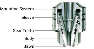

                                            Just a thought …
                                            For Robin’s application, the body of a ‘surplus’ drill-chuck could be modified to accept three cutters.
                                            [ no, I’m not suggesting using the jaws ]

                                              Cross slide stops: I have an album with a couple of photos which might help.

                                                  Cross slide stops, you don't need them you have a DRO on your by the looks of it decent lathe? The QC tool post you have has been tested on YouTube many times & will typically repeat within .0005", I may be proved wrong but your 'external reamer' will be a waste of time.

                                                    #560100
                                                      Posted by Robin Graham on 28/08/2021 03:07:36:
                                                      Thanks for further replies. […]
                                                      Michael – food for thought perhaps. Though from your somewhat gnomic reply I'm not sure what exactly you have in mind.
                                                      I didn’t have anything exactly in mind, Robin
                                                      … it was just a fleeting thought perhaps [or perhaps not] worth sharing.
                                                      The empty shell of a 1/2” Jacobs tailstock Chuck [locked-up tight] could be adapted to accept a cutter or three … possibly saving a lot of tool-building time.
                                                      Credit: https://toolsmach.com/en/content/14-drill-chucks
                                                      Edited By Michael Gilligan on 28/08/2021 07:05:09
