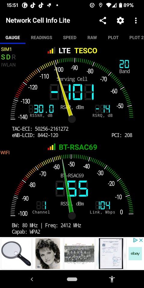

        … if so, could you please help with what seems to be a very simple requirement, but it has me defeated ?
        My cheap & cheerful Alcatel 1S runs Android 11
        Where I live is a ‘not-spot’ for 4G signals because the tower is shadowed by a cliff, but some nearby locations have nearly line-of-sight, and it would be convenient to identify them.
        Signal Level can be accessed on the ‘phone but is buried under several layers of menu !
        Is there any way that I can put a shortcut on the home-screen that takes me directly to the relevant page:
        |Settings| |System| |About phone| |Status|
        … it would make life a little easier.

          I'm no expert, but I couldn't find a way to easily display it, so I use Netmonitor app, which works well enough
          https://play.google.com/store/apps/details?id=com.parizene.netmonitor&hl=en&gl=US
          Handy for WiFi strength too.

            I can't help you with a shortcut Michael, but what would you do if you had one? The phone will select the "best" serving cell on your registered network and I don't think there's any way to change that and make it use a different one, unless you changed network. Something like Netmonitor could help, or you could install the Opensignal app.

              At my property, the signal level is -100dB or worse
              I know where the local tower is, and I know that there are dead-spots in the coverage
              What I want to do is a quick check of signal level at any convenient point that I happen to find on my travels.
              The ‘phone is difficult to use with my arthritic hands, and difficult to read without glasses … so I was just hoping for a slightly easier life.

                Right now I understand a bit more;
                The other app I use is Network Cell Info; I use the free lite version and put up with the adverts which aren't too intrusive.
                https://play.google.com/store/apps/details?id=com.wilysis.cellinfolite&hl=en_GB&gl=US
                It gives a nice clear easy to read display which might suit your needs without resorting to reading glasses.
                The previous app I mentioned does have a rather small text.
                I've never tried, but I think it allows you to build up a local signal strength map as well, though you might need the paid for version..

                    Thanks, Bill … that looks very promising … I will download it forthwith !

                          The App seems to be doing its job nicely … indicating a good wi-fi signal and ‘no connection’ on the cell : the needle hasn’t moved off the -141dB stop yet.
                          The proof of the pudding will come when I take it out for a walk tomorrow.
