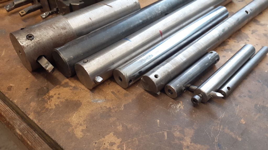

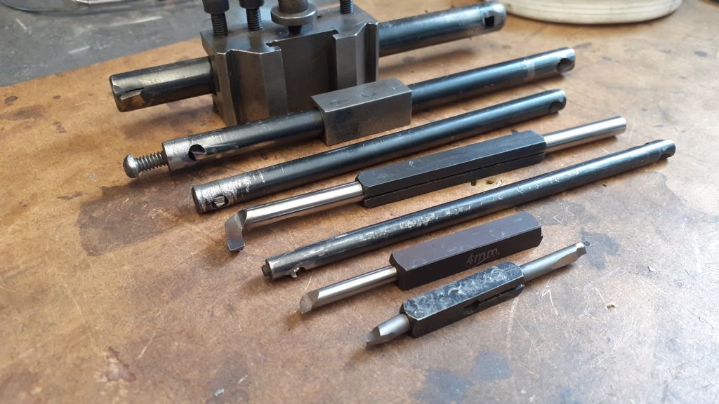

        William, you can just grind a bit more off your tool so it clears a smaller bore, can you post a photo of what you have got just to be sure.
        The bars can easily be made just a hole for a round tool bit and a tapped hole at 90degrees for a grub screw.
        Used to be that most of the ME suppliers did a set of 4 – 1/4, 5/16, 3/8 & 1/2" shanks but now mostly insert types. Looks like Tracy have some, I assume the size is for the tool bit so you may want to check with them the size of the 1/8" one which may just be the right height for you.
        The ones with the black shanks are from one of the 4 piece sets and have had a lot of use
        Plus a few homemade ones
        I've only known heights to be published for insert tools

          I'm sure I saw some of those long, round-shanked HSS boring bars (i.e. fourth from front in your first pic) somewhere, but I can't find them again. I've asked Tracy to confirm on their holders – and will keep looking – or make my own as you have shown!

            Chronos and ARC do the bent HSS ones.
            Yes you can grind more off but will get more flex
