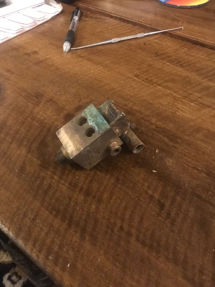

      Hi, the picture shows the regulator from my 3.5 gauge Columbia. This is the twin popper type and it’s not very controllable. Is there a better option that I can use. ThanksIMG_3492

      Howard Lewis
        @howardlewis46836
        From the corrosion, it might be worth stripping and cleaning in case it is sticky and causing the difficulty in control
        Howard
        #767501
        norm norton
          @normnorton75434
          Yes, firstly clean and try to get it working.
          Most ‘difficult’ regulators eventually get replaced with ball valves. But you have to work out the construction of a housing body to connect the steam feed, the valve and the rotational input from the regulator shaft. This link might show you what others have suggested for a different valve replacement. modeleng.proboards.com/thread/15196/stroudley-regulator-problem
          Alternatively, see whether you can replace the valve seats with PTFE or o-ring inserts – sometimes a good fix to keep the original design.
