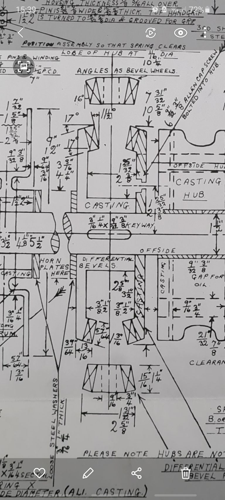

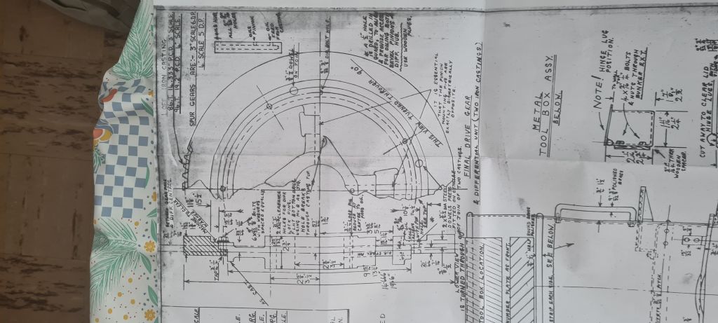

      Hello!
      I am just at the point of machining the bevel gears for the 3" Fowler.
      I am using Ivan Laws Gears and Gear Cutting for all terminology and calculations.
      I will be cutting the gears using Ivan Laws parallel depth method on page 106-111
      Now H.R Plastow calls for a 44T Crown wheel and 9T Pinion both 6D.P.
      This gives a P.C.D of 7.333"
      The problem arises when you look at the distance between the backs of the Pinions. This is stated as 7.969"
      Now the P.C.D can't be referring to a True Bevel Gear (True P.C.D of wheel as stated by Ivan Law page 46) as this would make the O/D of the Crown wheel far too small. It also can't be referring to Parallel depth Bevel gears (P.C.D of small end page 106) as this would mean the tooth face is only 5/16" long!
      If I use N/D.P I find that 37T gives a small end P.C.D of 6.166"
      This allows a tooth face of 0.86" and an O/D of 7.953, which is pretty much perfect for the Distance between the backs of the pinions.
      My question is am I missing something here? Is 44T correct and I am being stupid or did Plastow get something wrong and my 37T is correct? I have seen the other thread referring to Bevel gears and ensured I Have changed the Sin to Cos where required but I still get the same result.
      Help would be appreciated before I make a lot of cast iron mess!

                      The design calls for 2 pinions exactly diametrically opposite.
                      Why does the Crown wheel have to be divisible by the amount of Pinions?
                      So I am only able to cut the bevel gears using the parallel method in Ivan Laws book. And using his procedure, 44T Crown wheel doesn't seem to fit the design?
                      Cheers,

                                        So it seems a 44T 6.D.P parallel depth tooth, Crown wheel, to the dimensions specified does not exist?
                                        And as Jason says, on an odd number Crown wheel, the pinions will be in opposite positions which will match up with the opposite Crown wheel?
                                        So I can use my plan of a 37T Crown wheel?

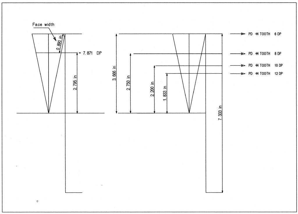

                                            Hi
                                            The problem that you have with these gears you may not
                                            be able to solve using the parallel depth method.
                                            As Andrew indicated earlier generated bevel gears
                                            are calculated from the outside of the cone and
                                            parallel depth from the inner cone.
                                            The diagrammatic representation of the 44 tooth gear here at
                                            6 DP shows how the gear reduces in diameter as the DP
                                            number rises ,to obtain the gear face width of 57/64 inch
                                            (.890 inch) would mean the starting point for the calculation
                                            would be 7.871 DP . This would be possible to do
                                            using the calculation to make cutters as seen in the book
                                            gears and gear cutting providing that you can find tables
                                            that go down to 9 tooth .The tables on page 115 show
                                            these at 30 deg pressure angles down to 10 tooth which may do.
                                            The minimum tooth count that you can cut parallel depth
                                            bevels at 20 deg pa is 12 tooth using the tables in the book and that is providing that is a
                                            pair or 12 and 13 tooth pair ,as the angle changes the minimum
                                            size creeps back up to 17 tooth otherwise under cutting is
                                            present at the inner root as seen here in this photo
                                            of about 16 and 31 tooth set.
                                            #502893
                                            John P
                                              @johnp77052
                                              Hi
                                              Further on from yesterday's post the size of 7.871 DP
                                              this is very close to 3.25 module at 7.815 DP ,Aliexpress do
                                              sell Mod 3.25 cutters at just under £10 each .
                                              The No 1 cutter goes down to 12 teeth at the angle of the 9 tooth
                                              bevel gear the equivalent spur gear tooth count would be about 9.28
                                              changing to 10 tooth gear you get to about 10.3 teeth and a 11 tooth
                                              gear would be 11.4 tooth so not far off from the 12 tooth minimum
                                              count of a No 1 cutter you might get away with this.
                                              If you can live with the slightly larger gear it might be worth a try
                                              at just under £20 for the cutters
