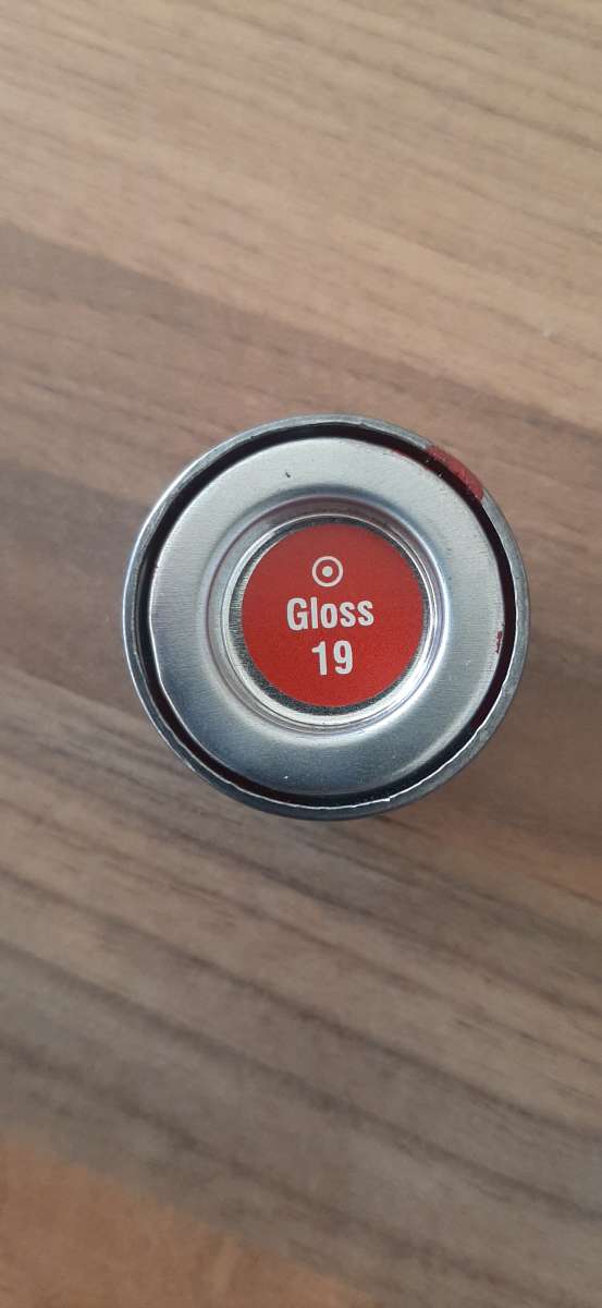

                        Just reading through the posts in this thread, in particular relating to the quality of humbrol paint
                        I’ve been using the little pots for donkeys years and have around 15-20 colours. Never had a problem with quality, they all brush well and set hard fairly quickly
                        Having said that I have just bought a small tin of number 19 bright red and it’s awful. It paints ok but is still tacky after 5 days.
                        Nothing to do with lack of shaking or stirring or the room temperature.
                        I’ve lost confidence in the brand now, never again.
                        Anyone recommend an alternative, perhaps in the Revel range?
                        Geoff

                            Geoff
                            I have had a similar experience recently with humbrol bright red used for lining, my very old tins were fine but some new ones took ages to dry and very hard to keep a consistent line width (bow pen and lining tool). I tried a tin of signwriters enamel and it seems to be just like old humbrol, lots of pigment and covers well, even thinned it and sprayed some buffer beams with it, came out fine, settling out nicely. Mine is by Craftmaster bought via eBay.

                              Hi Dave
                              Thanks for the reply, I’ll have a look at the craftmaster range.
                              I would suggest to all to be wary of the recent humbrol pots with the new label on the lid. Note the spot and circle above the word gloss.

                              Dave Wootton
                                @davewootton
                                Ahh thats the type of tinlet that has given trouble and took ages to dry, my old ones had the paint number embossed on the lid. The search is on for some old dusty tins of the good stuff in the other colours I need.
