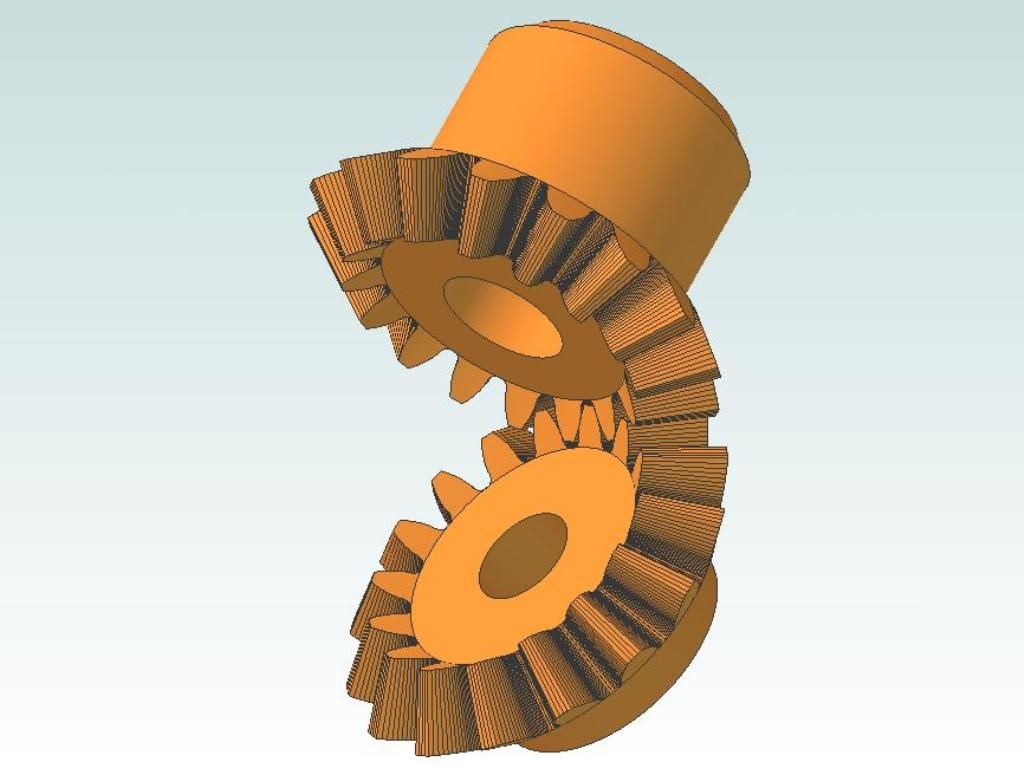

      Posted by Nigel Graham 2 on 21/06/2019 23:23:50:
      Even an equal pair of bevel wheels isn't easy to measure and draw though!
      Not difficult, but you do need a good understanding of gear design, like this:

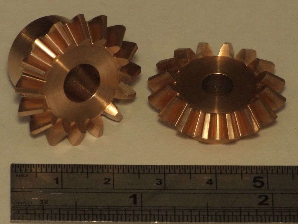

      And after machining on a CNC mill:
      Andrew

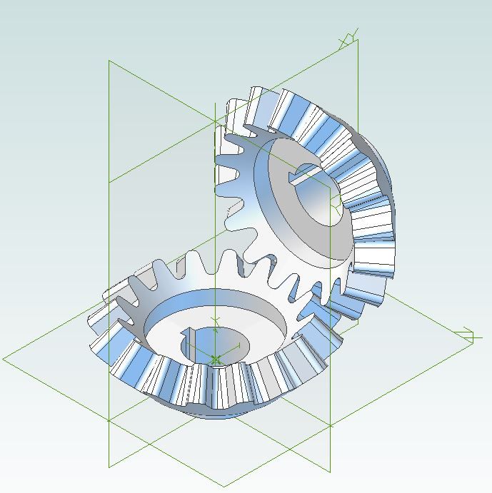

        Also not to hard to model a reasonable visual representation even if you don't want or need the exact profile

                I did a bevel gear in MoI a while ago.

                  I must admit I've often wondered how close to each other all these programmes are, behind the trade-marks and patented / copyrighted presentation.
                  That bevel gear is actually very much like the ones I am using.
                  To make the assembly work I need join them by a central journal that also prevents the axial thrust on one of them from pushing it out of mesh. I have established the most compact arrangement for that.

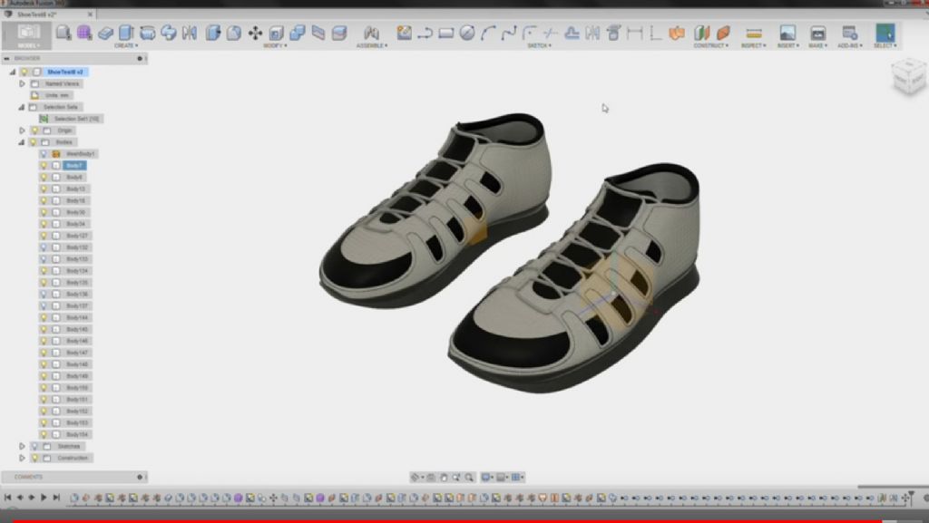

                    How about these shoes, produced entirely in Fusion.

                        " … from tracing over photos …"
                        Via a scanner? I don't know if such software exists, but it could be very useful, being able to translate a scanner file into a CAD one.
