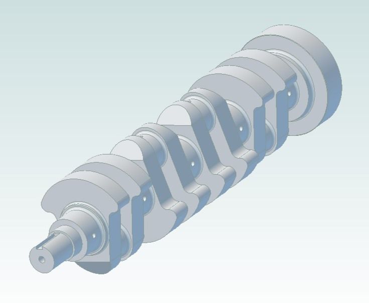

                I had another go at a 3D TurboCAD exercise, a 2-throw crankshaft similar to that for my wagon engine. I tried a subtractive method as potentially feasible.
                It looked promising but failed when I tried to change something part-way through. TurboCAD lets you produce simple " Primitive " solids like cylinders directly, but doing anything to them automatically dissolves them into " TC Surfaces " – polygonal prisms of adjacent but independent facets, so the former " solid " cannot be edited. An extruded cylinder from a circle is a TC Surface by default.
                Now a crankshaft with disc webs is a chain of symmetrical, simple cylinders of known sizes, so can be assembled by calculating their centre co-ordinates. If the assembly is of more complicated, varied, unsymmetrical elements and sub-assemblies, such calculations become just too difficult.
                So just don't expect me to model the rest of the engine around the shaft!

                  Nigel, you're STILL thinking in separate 2d drawings!
                  Model your crank main journals from one long properly defined cylinder. Do the same for the big end journals, mapping them around the end of the main journal. Then add the webs, positioning them with your dimensions. With some practice, you could reuse one web as many times as you need. Have the program join each new feature to the existing ones. Then have it cut away the joining parts you no longer need. The longest part of the job will be positioning the webs.

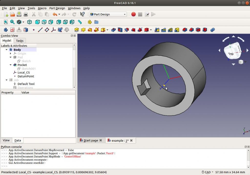

                        Crankshaft calculations may be too difficult for the average Joe, but it is possible. One of the advantages of 3D CAD is the tool may be able to help, perhaps even doing the whole calculation.
                        I didn't expect FreeCAD to have much to offer, but it has part of the answer. Maybe more if I looked harder. My cylinder example would be balanced about the axis of rotation (Z in the example) were it not for the notch. FreeCAD can tell me where the objects Centre of Gravity is, yellow dot near the mouse pointer:
                        Zooming in shows the C.O.G isn't on the Z axis:
                        I could measure how far off the Centre of Gravity is and use that to calculate a counter-balance. Or I could add or subtract lumps from the cylinder until the yellow dot sits 'close enough' to the biue line. Or, if it doesn't exist already, I could write a Python Program to search for optimum balance. These methods would only address static balance, but someone who knew the ropes could program to optimise dynamic balance. In the not too distance past engineers would do this with teams of people doing the sums and testing the result with a real model. Now months or even years of work can be done in seconds.
                        This is grown-up stuff. You can't expect to do it without a good understanding of the problem, knowing whether or not your software supports that kind of problem, and of course – knowing how to drive the tool to get the right result. Learning how to do this requires substantial time and effort.

                          Crankshaft
                          It shouldn't be too difficult to draw a two-throw crank with simple constructional steps in a similar manner, I wouldn't have thought.
                          I'm not saying that this is the best, or only way, to do it, just that this is how I approached the "problem" of getting my head around the concept of 3D drafting. With hindsight and now with more experience with the Atom program I would have used a slightly different approach and used for example, the "mirror" tool to replicate the crank webs instead of producing each one individually. ( I've redone it this way since. )
                          Persevere, Nigel. I promise it is both rewarding and satisfying when it finally "clicks" and you produce an aesthetically pleasing result.

                            By subtraction though, and co-ordinate arithmetic, as I cannot use the intended assembly methods.
                            I'd imagined I was cutting the shaft from a billet of steel 2.5" dia for its full length. After a few goes at establishing the right order, I subtracted an annulus from each end of the ' Primitive ' cylinder to leave the end journals. As I wanted, it now looked like a rolling-pin.
                            Step-by-step and similarly, I removed the " metal " around each crank-pin:
                            I drew the pin " within " the billet, then copied it in place twice; colouring the copies to guide me. I kept copy 1 as-is, enlarged copy 2 to about 4" dia to cover the throw, then subtracted copy 1 from 2. Finally, subtracted copy 2 with " pin hole " from the billet, to expose the original pin. All correct so far.
                            It went to rats somewhere after that, including something that changed the shaft from a generated cylinder to a strange, intractable " TC Surface ". I don't know what that is geometrically. Nor if TC there stands for TurboCAD or something else.
                            This was all in 3D mode, using the various viewing angles to verify progress – until it went wrong.
                            My later thought about mapping the features' co-ordinates was forced on me by TurboCAD's baffling 3D assembly methods: abstruse combinations of various entity-types, tools, etc. Using such mapping works with straightforward, symmetrical objects, but breaks down with increasing complexity.
