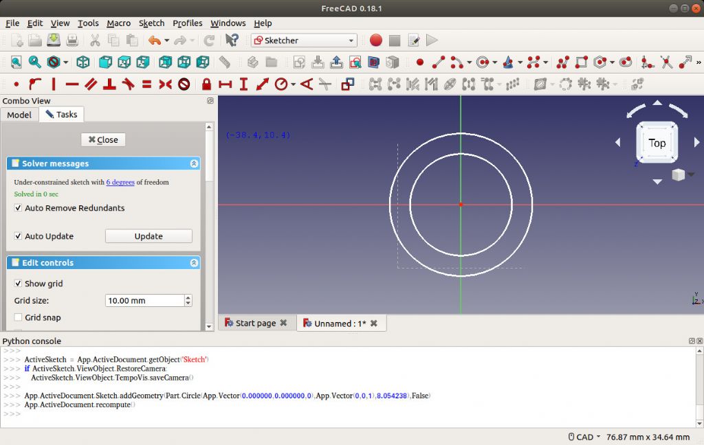

                            #412781
                              Posted by Kiwi Bloke 1 on 04/06/2019 22:58:48:
                              Anyone here got any experience of Linux CAD packages – FreeCAD for example? I've installed it, and some of the supporting literature, but it looks completely baffling (where are the nursery slopes?). FreeCAD is also available for Windoze and Muck operating systems.
                              Getting into FreeCAD is a little difficult because it supports multiple Workbenches for Architectural Drawing, Ship, FEM etc etc.
                              The one mechanical engineers want is 'Part Design'.

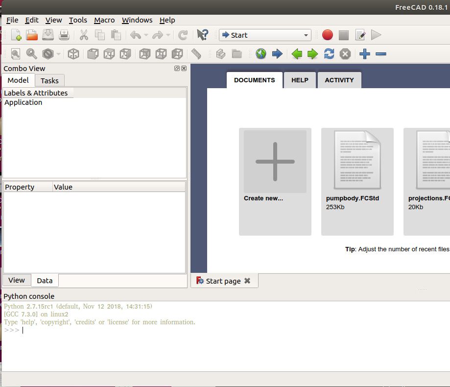

                              Starting FreeCAD gives this rather intimidating screen:
                              Clicking on '+ Create New' gets a little further, but still no coconut:

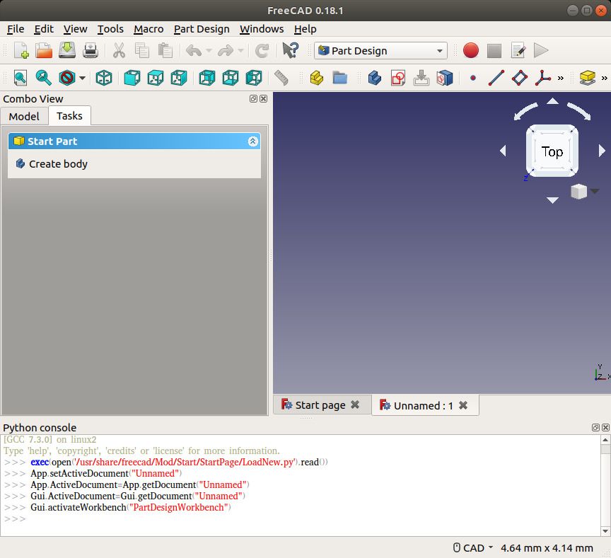

                              So, Click on the start button, and choose 'Part Design'

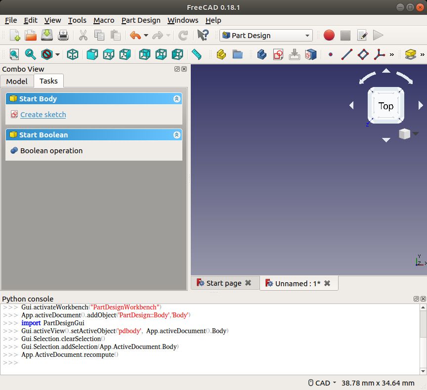

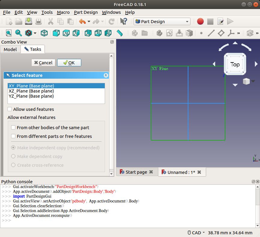

                              The tasks panel lists 'Start Part Create Body', click which produces 'Create Sketch':

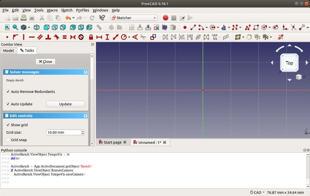

                              Clicking 'Create Sketch' asks another question, which plane should we draw on:

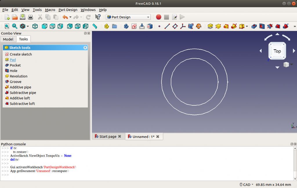

                              Choosing one of the planes opens the sketch editor, and lots of new buttons. Those with red dots and white lines are drawing tools ( the white circle with two red dots draws radius circles ). The Red buttons set constraints, forcing lines to be Vertical, Horizontal, or of a particular dimensioned length or angle etc. Hovering over buttons with the mouse for a second or two pops up a a description
                              I used the editor to draw two circles

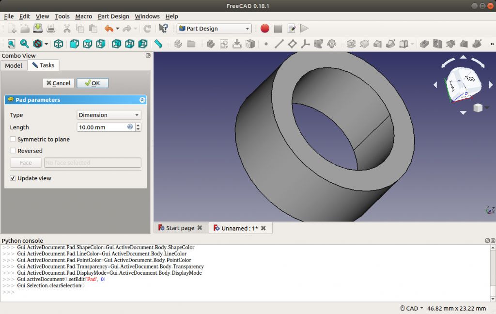

                              Closing the editor gives a new list of Tasks:

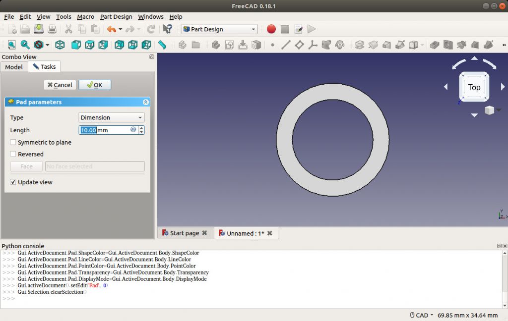

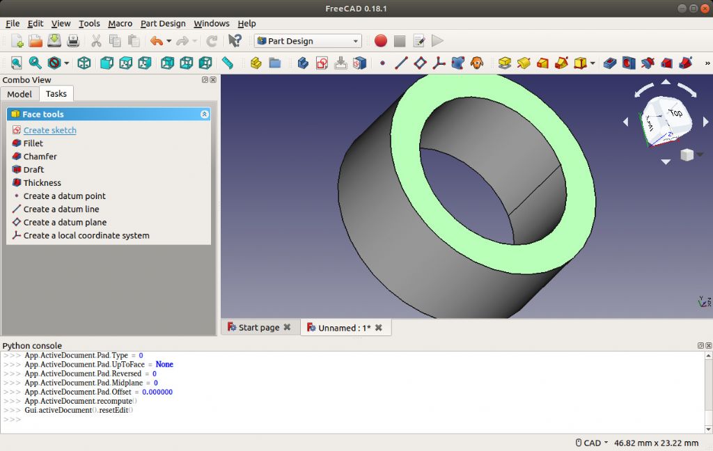

                              Clicking 'Pad' allows the area between the two circles to be extruded as a 3D cylinder. Length, your choice:
                              The new object can be viewed from any angle:
                              More in next post:

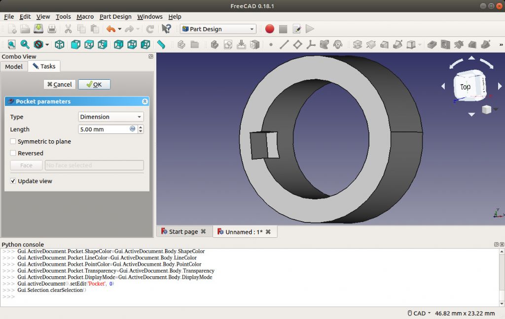

                                One of the Tasks available is another 'Create Sketch'. Clicking it opens the editor, this time working on the top of the cylinder where I've drawn a square, half on half off:
                                As an aside, note FreeCAD is complaining 'Under constrained sketch with 4 degrees of freedom'. This is because the object I've created has no constraints. I didn't set a specific radius on either circle, or put any dimensions on the square. Although it looks OK, FreeCAD knows it's dodgy. For rough work, this may not matter much, but it's not a good idea to leave objects imperfectly defined. In a complex model it can cause peculiar behaviours that baffle the user!
                                Closing the editor, opens up another list of tasks:
                                Choosing 'pocket' lets me cut a keyway inside the cylinder, I've left it halfway (dimensioned 5mm deep), but changing type to 'Through All', would create an end-to-end slot:

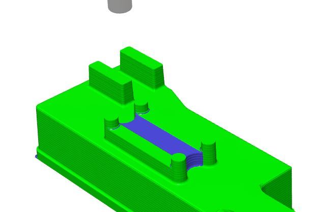

                                    #412816
                                      Posted by Michael Gilligan on 05/06/2019 20:18:09:
                                      Nice demonstration, Dave … and it highlights one 'feature' of CAD that can catch-out the unwary: That half length keyway is very easy to draw, but would be tricky to machine.
                                      Would the same not apply if you drew the part with pencil and paper?
                                      On the other hand if you also have CAM you can run a simulation and that will help to show up what you can't machine. I was creating some tool paths about 1/2hr ago and the cad left some metal shaded in another colour where my cutter could not reach. Still at least with CAD it was a simple couple of clicks to adjust the two features so the tool could pass between or I could just have easily selected a smaller dia tool.
                                      Edited By JasonB on 05/06/2019 20:30:08
                                      Edited By JasonB on 05/06/2019 20:35:05

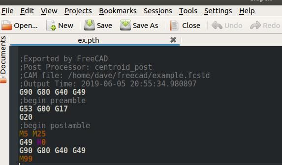

                                          I am intrigued – why does FreeCAD show that programme code at the bottom of the screen? Is it something to do with creating NC control files?
                                          I once saw something like your example, at work, but its equivalent pocket had 1mm corner radii and was on a ledge deep inside an object resembling inside, the interior of a die-cast stepped pulley. Not sure how the draughtsman thought it would be milled – I don't think you can obtain 2mm slot-drills 100mm long!
                                          #412820
                                          Anonymous
                                            Posted by Nigel Graham 2 on 05/06/2019 20:50:16:
                                            I've never used FreeCAD but the "code" is nothing to do with CNC. It's simply a representation of the Python function calls the CAD program is using.

                                                I produced the G-code from FreeCAD's 'Path' Workbench. Pretty sure it's rubbish because I didn't set anything up first! You're supposed to define tools and stuff before pressing buttons at random and there are lots of options hinting at milling, engraving, contouring etc. As I don't understand any of it, only a lucky guess would have produced meaningful GCode. But, in theory, I could have FreeCAD outputting the instructions needed to make the object by subtraction (machining), or addition (3D printing).

                                                  That's right. The Python console can be turned off. Mostly it just shows what the program is doing behind the scenes. It's possible for the user to type modelling commands into the console as well, but I've never experimented with it.
