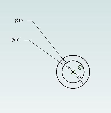

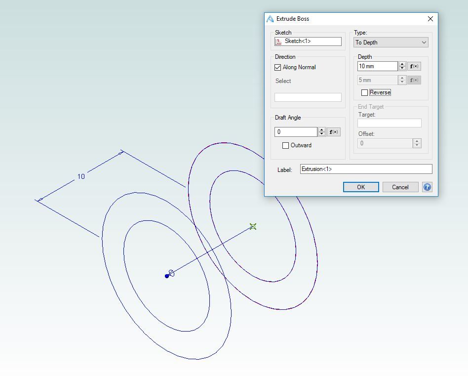

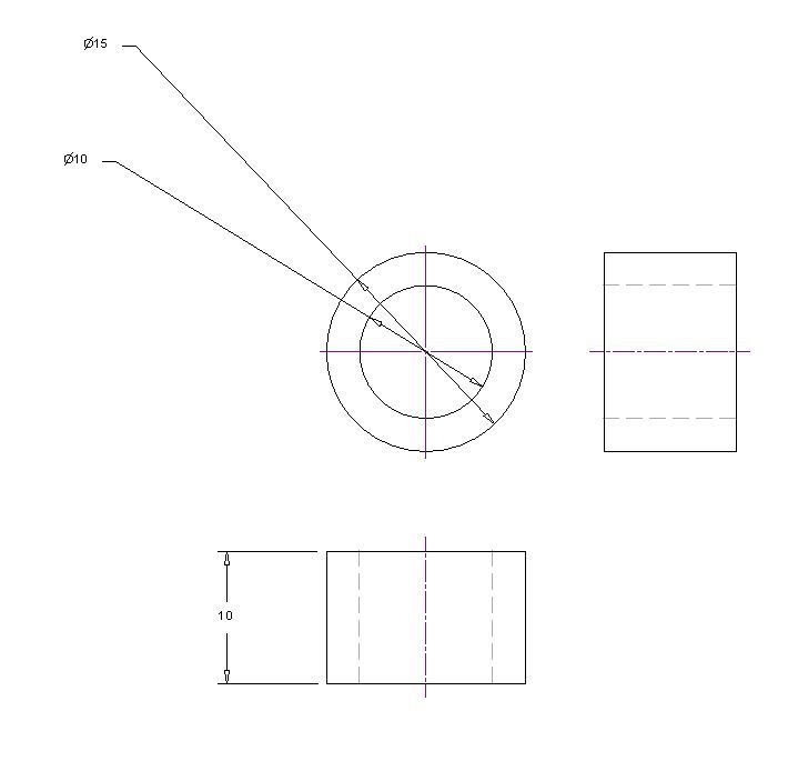

                                              Aah – after reading all that stuff and shaking my head in disbelief I decided to 'design' Nigel's bush in Onscape.
                                              I have to add my comments above as I don't know how to write something below a .jpg
                                              And the two pics are not in the correct succession…
                                              So the second one is the result as it is shown in Onshape. The dimensions are in the (now invisible) sketches.
                                              The first one shows the automagically generated 2D-drawing, with some embellishments added on that stage (hidden lines, cutout) The dimensions can be placed where one wants them, and their values come from the sketches!

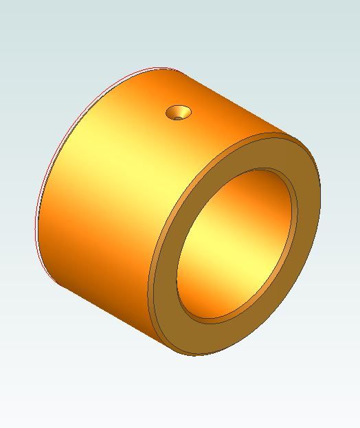

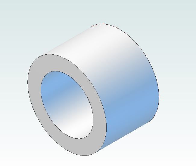

                                                    Nigel, another version of your "complicated" bush
                                                    I will describe the process from your 2D mindset of looking at one side and then another.
                                                    First look at the end and draw the outside circle and then the bore.
                                                    Then looking from the side you can see it has a length so simply give it that length, here I have entered 10mm
                                                    Then click OK and I have your bearing which I can move about and look at from whatever angle I want, there are tabs to click for looking square on from all six sides if you prefer that or any isometric/perspective angles.
                                                    Want a 2D drawing then just click drawing and select the part and what views I want, eg front, side and plan then click OK and I have a dimensioned drawing.
                                                    Any other part can really just be treated in the same way, first operation is a sketch in 2D of one elevation and then cut/extrude or push/pull is like adding the second elevation.
                                                    All I have done is drawn a couple of circles and entered a length, nothing complicated for me to enter, the computer may show it a elipses etc but it does the work and not me, old outdated software may show a series of facets but unless you zoom in massively up to date software will look round to the eye.
                                                    Now if I also wanted chamfered corners and say an oil hole they are easy to add, no deleting of previously drawn lines at the corners, no need to alter each of the three views as the part is altered and the computer will automatically alter the 2D drawing to show the chamfers and holes on any elevations. Could even go as far as adding a bit of colour but that is a personal choice and really more use on assemblies on the screen than for actually making the part.
