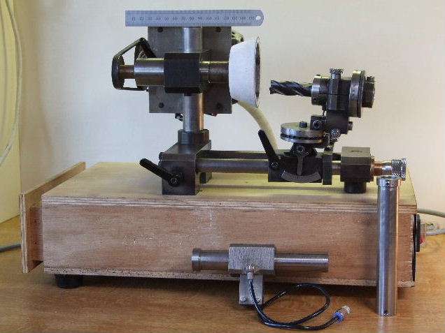

                                                  Scale model of a Quorn tool and cutter grinder
                                                  About 30+ years ago and not being over fond of castings I made my Quorn derivative out of BMS stock. It is also a scale model of the original in that, one sixteenth on the original is one millimetre on my example.
                                                  Since taking this photograph I have done away with the workhead swinging around the front bar. Instead linear bearings and rods now allow the workhead to traverse across the face of the wheel. The tilt mechanism is unaltered.
                                                  This machine gets a lot of use especially now I have downsized my workshop and the smaller machines soon tell you when a cutter or lathe tool are not so sharp.
                                                  While a lot may consider the time expended on the manufacture of tooling to be non productive as regards model making. I consider this tool to be an investment and it has more than paid for itself over the years, in the cost of cutters alone. The best part of this machine is that it did not cost me anything other than work, and work is free in most shops. It also does not take up a lot of room.
