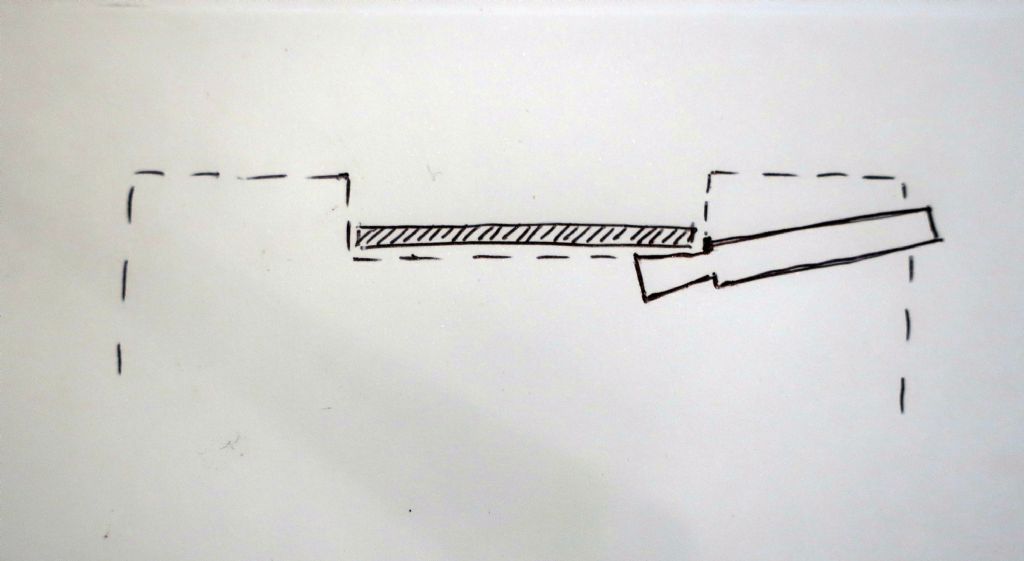

                                          There is an American program called Forged in Fire in which contestants typically make a hardened steel knife from various materials.
                                          Of interest here is the extensive use made of belt sanders for shaping the roughly forged blanks – both pre- and post-hardening. These frequently start with the use of 80 grit and moving on to increasingly finer grades for final shaping and initial sharpening. The amount of metal that can be removed using the coarser grades is very impressive and well worth a look.
                                          Pero
                                          Recommended watching I think. The format is 'Great British Bake-off' except they make knives, swords, and replica historic edged weapons rather than cake.
                                          Much to be learned about forging, and although contestants know their stuff, they have surprising gaps when it comes to ordinary metalwork technique. Watched dozens of episodes and only once has a milling machine been used, though blood is often spilled misusing a pillar drill to widen holes.
                                          Anyway, the hardened steel blades on Forged in Fire are invariably finished with a belt-sander, much bigger than the device linked in Brian's question, and they remove a lot of metal. My small belt-sander is used as a linisher, and I hadn't thought of using it to touch up HSS. Although it would probably work I don't see any advantage compared with a wheel, and there are disadvantages too. A narrow HSS tool would wear the belt rapidly in one place unless it were kept moving side to side, in which case it would be hard to keep straight. Even done carefully, I doubt the belt on a small machine would last long because the layer of abrasive is so thin.
                                          Horses for courses, I'd rather use the belt for linishing and a wheel for sharpening HSS. Both tools are worth having!

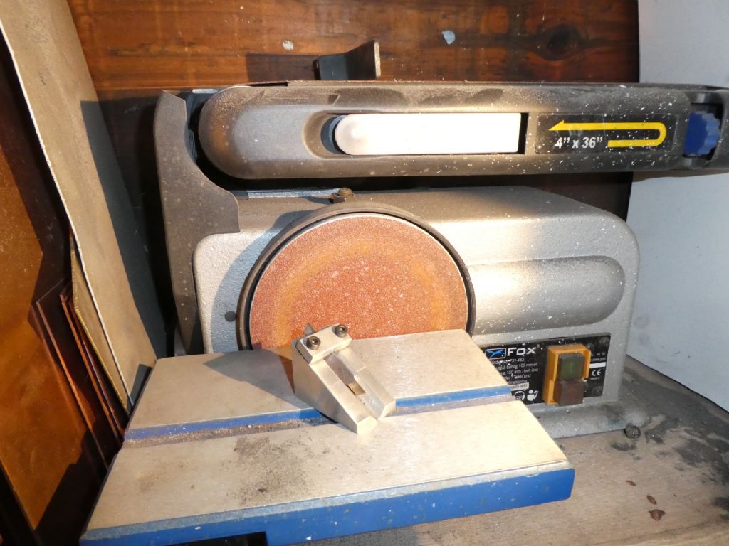

                                              I have a belt/disk combo sander. I use the front facing disk for putting an edge on the 1/4" square HSS bits I use in my tangential tool holder – quick and easy using a little angle jig and the re/sharpened bits cut nicely. Mostly though I use inserts. The top belt I tend to use mainly for "surface grinding".
                                              Rik
                                              PS I forgot to mention and it now seems obvious in hindsight – but please hoover out any sawdust before fettling metal as the sawdust ignites quite easily. How do I know? – Guess! embarrassed

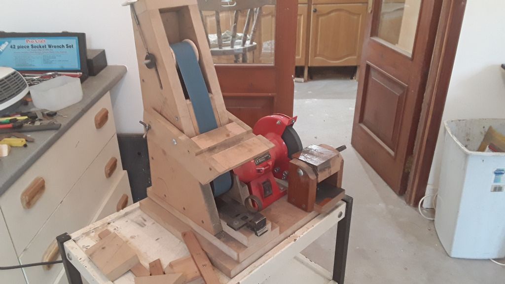

                                                If you want to try before you fork out serious money, here is my version that cost me £15. It does work – wheel for initial shape and belt to refine. Really made it for grinding bowl gouge with a jig but good for all wood turning chisels and kitchen knives also. Now using it for lathe tools would benefit from new jigs for this.
                                                This was "proof of concept" – I will remake something in metal in due course.

                                                  Well thats rather spectacular, as you say you can spend £400 on a semi pro model

                                                    Having used one for forming & sharpening HSS lathe tools, it can be a handy thing to be able to approach the belt-face from some small 'negative' angle behind it on either side – say when creating side relief on parting or facing tools.. ..one of those things that doesn't need to be done that frequently, but essntial when one does need to do it..
                                                    If I'd made a wooden prototype first I'd have saved myself some trouble later…
                                                    #556380
                                                    Andy Thompson 3
                                                      @andythompson3
                                                      Good point about the negative rake. I was going to add a 50mm wide steel plate for the belt to run on, them add a notched platform (but needs to slide in and out to get close to the belt when angle changes). Is there any way to grind a curve on the top of a parting tool? Thought about adding an extra small roller at the top.
