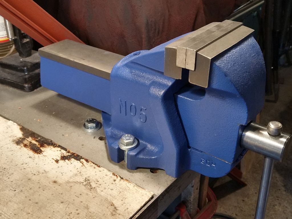

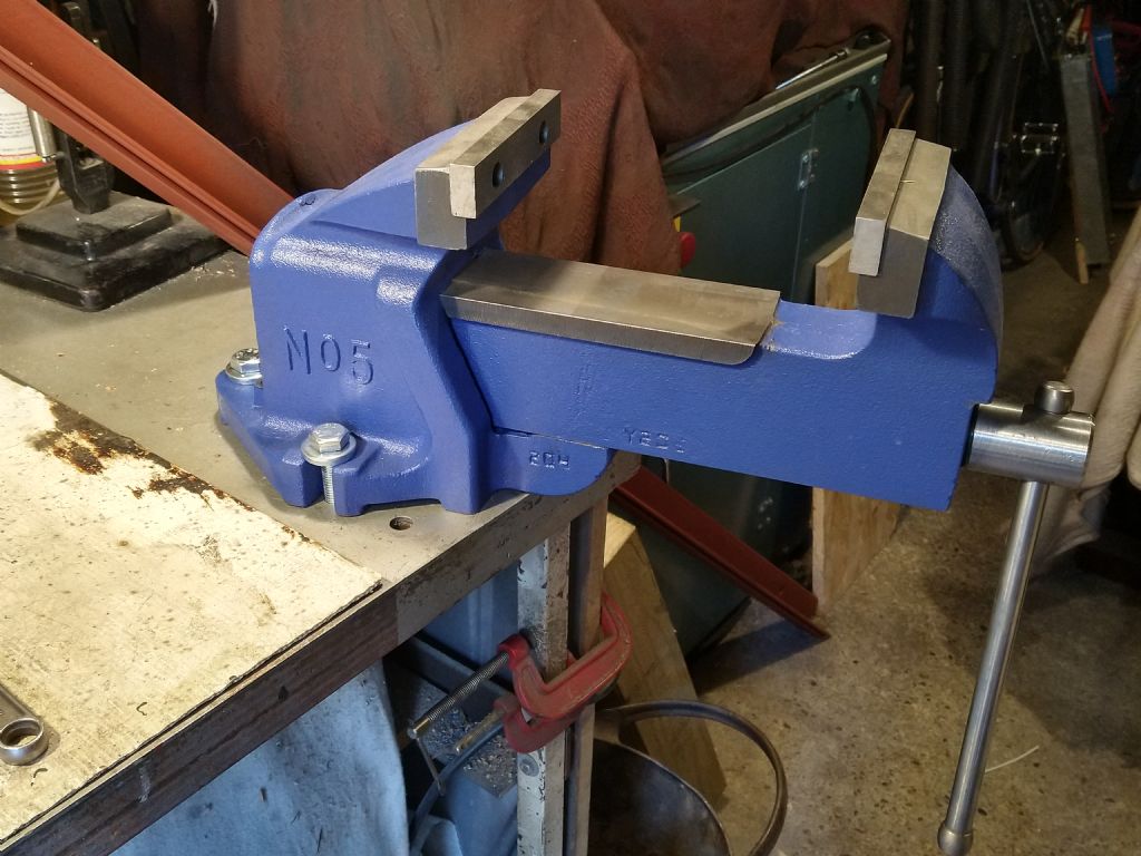

                  Yes the idea was that the left bolt stayed where it was and additional fixings added to my bench to fix the vice at 30 degrees (ish) Nuts welded to a plate underneath the bench top so I would only have to move 2 bolts and loosen/tighten the third. M12 fixings purchased today, bench top all marked out but, I seem to have got involved in re finishing the car wheels!

                    img_20210623_195355189_hdr.jpgFinished last pair of wheels so got to drilling bench top for new vice. It's held down with 3 M12 bolts with a plate underneath to spread the load.
                    Drilled an extra pair of holes so the vice can be swung around it's left foot and bolts dropped in the extra holes. Not sure of the angle but it's such that anything 'long' can stick out through workshop door!
                    Love the jaw opening, a full 7 inches. Have used graphite grease on the leadscrew and nut but so far haven't applied any lubrication to the slideways (not like me, I lubricate everything!) for fear of attracting dirt – what's the general opinion on vice lubrication?

                      The screw and it’s thrust areas need lubricant but I don’t grease the guides although they are generally covered in an oily film and seem to require no more than to be generally oily. Excess lubricant is just going to pick up dirt and be more of a problem than a benefit. I see the design has changed from my version, the mounting bolts now have slots rather than holes on my vintage.
