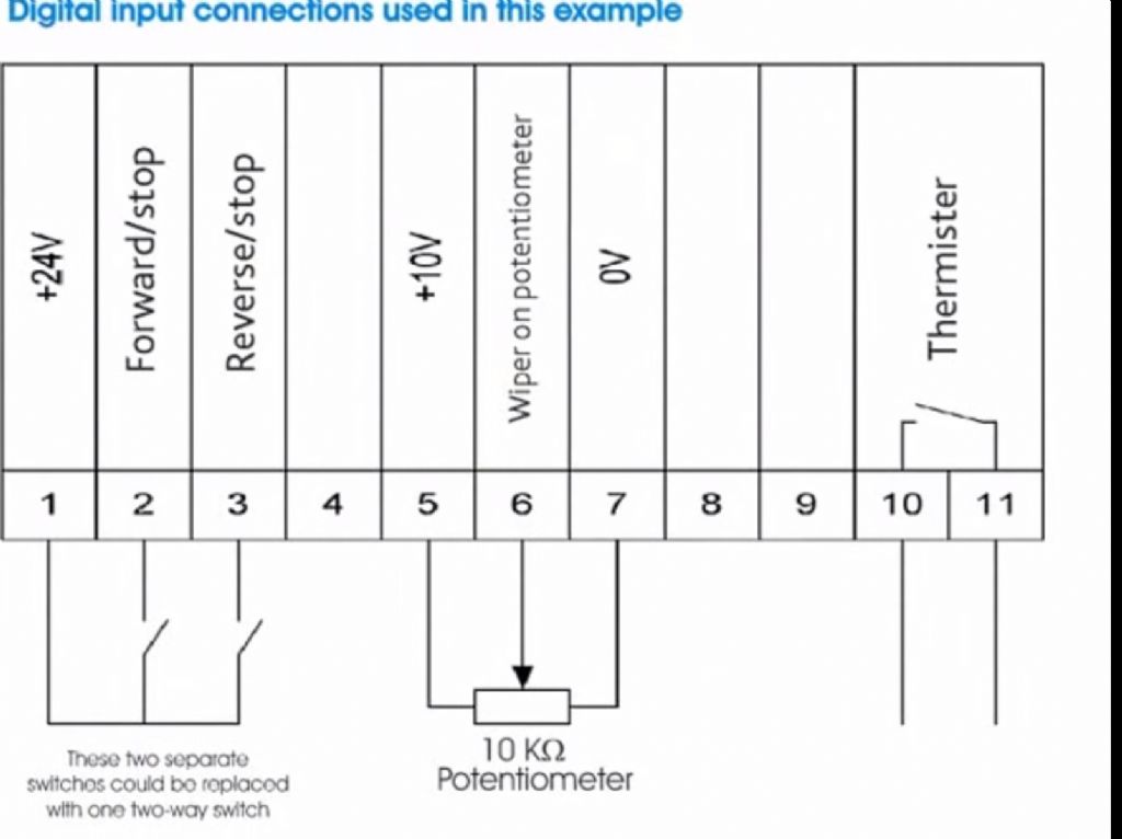

                                  Well I've been on a researching binge and it doesn't look at all difficult so I've gone ahead and ordered an inverter! I went with the invertek optidrive e3. Looks simple, lots of instructional videos on YouTube, fairly inexpensive and it's made in UK! I just hope I haven't overlooked anything?
                                  Motor: Brook Crompton, star or delta wiring, 3/4hp, 50hz, 2.4a, 1425rpm
                                  Inverter: Invertek Optidrive E3 0.75kW 230V 1ph to 3ph
                                  The only parts that looks tricky is the reversing switch, and I seem to have 3 white wires going into the motor? Not sure how I'm gonna know which is which?

                                  Les Jones 1
                                    @lesjones1
                                    You will not be using the reversing switch on the output of the inverter. The three wires from the motor go straight to the inverter output. It does not matter which way you connect them at first. If the forward and reverse are the wrong way round just swap over any two of the three wires. You will probably have to change the links in the motor connection box to change it from star to delta configuration. Post a picture of the connection box and members of this forum will tell you what to change. If you still want to use the old reversing switch it should be possible to use it to control the low voltage control signals to the forward and reverse control inputs on the inverter.
                                    Les.

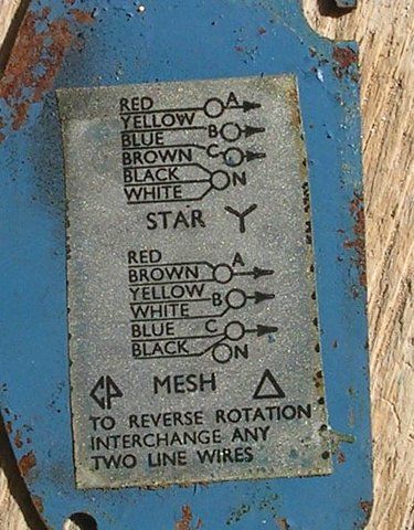

                                    Hollowpoint
                                      @hollowpoint
                                      I understand the reversing switch just wires into the low power controls. It's the actual switch itself that looks a bit confusing (search santon rotary switch) I guess if I play around with a multimeter on the contacts I should be able to work it out?
                                      I think I have the motor delta wiring worked out, there is a diagram on the inside of the cover plate.
                                      That leaves me with the 3 motor input connections (and earth). On my motor these are marked A, B, C, N and all the wires are white. I'm not sure which way these need to be wired into the inverter output? They are marked U, V, W. And ground.
                                      #229361
                                      Les Jones 1
                                        @lesjones1
                                        You should be able to identify the earth one easily either with a multimeter or where it is connected in the control box with the Santon switch. three of them will connect to the switch contacts and one to earth. Here is a diagram of one version of a Santon switch.
                                        This switch was used for recersing a single phase motor but if it is the same as your switch it should help you work out how to connect it to the inverter control inputs.
                                        Les.
                                        #229370
                                        Hollowpoint
                                          @hollowpoint
                                          This is a diagram of the wiring I found. So assuming my switch is similar to the above. I just connect:
                                          No.1 to terminal 3
                                          No.2 to terminal C
                                          No.3 to terminal A
                                          #229377
                                          Les Jones 1
                                            @lesjones1
                                            Yes, That should work. If You want to fit any interlocks or emergency stop buttons then just connect them all in series between terminal 1 on the inverter and terminal 3 on the switch. They all need to be normally closed contacts. I would have to see the manual on the inverter to see if this gave an NVR function. So it does not start up when mains is applied if the switch has been left in forward or reverse. I fitted start and stop buttons with my inverter as well as the reversing switch.
                                            Les.

                                              #229465
                                              Hollowpoint
                                                @hollowpoint
                                                The inverter arrived this morning! Need a little help. I've wired the motor in Delta as below. I now have motor terminals A, B, C but the motor output terminals on the inverter are marked U, V, W can someone tell me which motor to connect to each inverter terminal please?

                                                John Rudd
                                                  @johnrudd16576
                                                  HP,
                                                  If you have successfully wired your motor to DELTA, then connecting to the inverter is straight forward…..
                                                  Connect A,B and C to U,V and W….if the motor runs the wrong direction, swap any of the two phases over……
                                                  Dont connect anything to the N connection.

                                                  Hollowpoint
                                                    @hollowpoint
                                                    Thanks, got it working now! laugh
