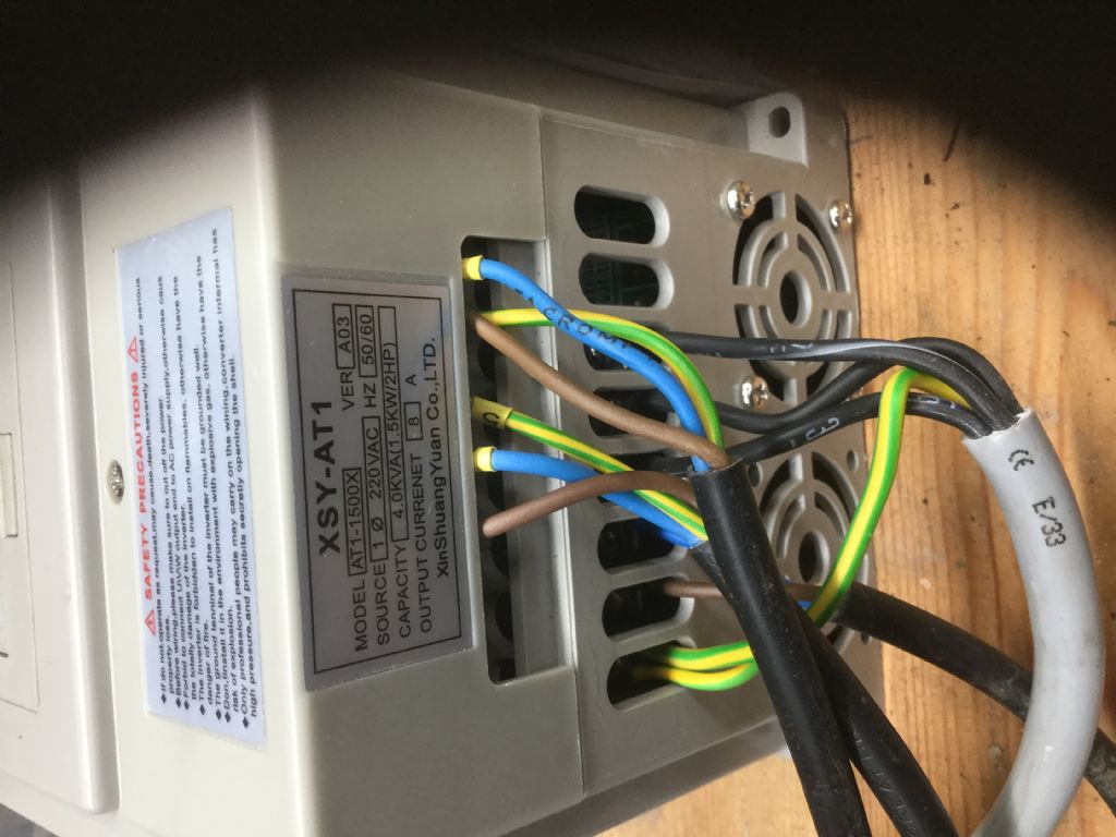

                  Thanks to everyone for their wisdom. All working happily to a max of 65Hz. I realised that there was a parameter not listed on my instruction sheet (P25) discovered whilst watching a youtube video. It sets the number of poles. It is in the inverter and programmable …..just not listed.
                  It seems that this vfd is delivered in several different cases but is basically the same electronics inside.
                  Just for info it is the XSY-AT1 not very expensive, but beware there is no way that the terminals comply to any european (uk) regulations. There are no cable gland holes and the terminals are easy to touch. I am going to mount it inside an IP65 box and gland off the cables now I have everything working from external controls. There is even facility on the VFD to power an external cooling fan. Last job is to get some proper control cable for the pot and the switch, I don’t like using the green / yellow for anything other than earth even if it is only 10v!

                    That's right. Few VFDs are user-facing consumer items. Most need to be enclosed inside an appropriate cabinet, not used out in the open. It's in the same class as the lathe's other protected "don't touch" electrical innards: contactor, fuse-holder, switches and wiring etc. The VFD box is barely more than a dust cover over the electronics. Not suitable for external use, especially in a workshop.
                    Have to undo six screws from a steel cover at the back to get anywhere near the VFD hidden inside my headstock. It's the cable-glanded and earthed lathe that meets Consumer Regs, not the VFD.
