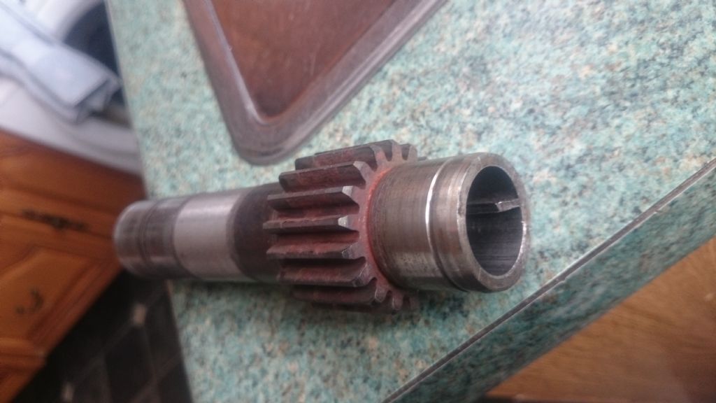

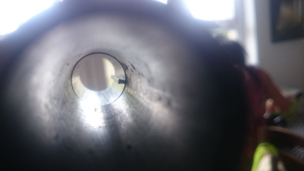

        the apron feed shaft on my colchester triumph 2000 has the typical 1/4" key slot, it passes through a hollow pinion shaft within the apron just like most other machines, this pinion shaft has a bore of circa 20mm and has a key running down its bore about 60mm. What I cant understand is the fact that this male key seems to have been machined as an integral part of the pinion shaft bore.
        i.e. this is not a key slot with a key, but the key itself seems to be one piece with the bore, is this possible, and how could this have been machined.
        On my old elliott lathe it was possible to replace the key when it wore, but in the case of the colchester it looks like the complete pinion shaft needs to be changed. I dread the thought of the cost of this.

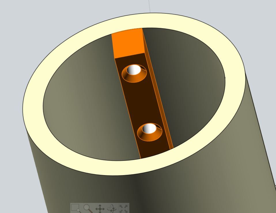

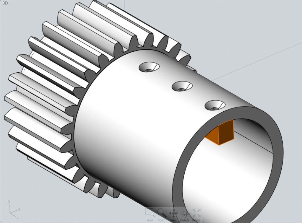

                  Is there enough room to machine away the built-in key and then cut a new keyway in the pinion shaft, securing a new key with pins or screws onto the pinion shaft?
                  Martin.

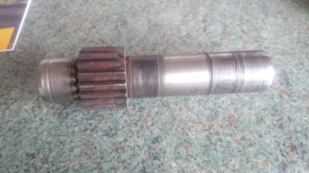

                        Posted by blowlamp on 26/04/2015 13:33:44:
                        Martin.
                        Not really, I had thought of cutting a slot on the outside and brazing a key in, then clean up the o.d, but was worried it may bend like a banana, maybe silver solder ???
                        but the ends of the origial shaft are badly worn around the oil seal area, so I had the idea to attempt to remake the complete shaft including the gear, it does look like it may be in two parts if you see the pic up inside the bore
                        I really dont think this could have been broached, Broaching a female key slot yes, but this is the opposite, a 25mm bore with an integral male key protruding inwards towards bore centre.
                        I have some pics now the key should be 1/4" it is badly worn
                        Edited By GT390 on 26/04/2015 14:44:43
                        Edited By GT390 on 26/04/2015 15:01:28

                          Posted by GT390 on 26/04/2015 14:43:29:
                          If you have to make enough of something then internal broaching is the way to go. Even Myford had broaching machines so more chance of Colchester having them as well.
                          [ EDIT ]  Is it 1/4" on the key ? Reason I ask is on a 25mm shaft 8mm key is standard but to make life easier they could have gone down a size to 6mm.
                          Personally because the key doesn't run the whole 60mm odd in length and doesn't need to if I had to do this as a repair I'd sleeve the oil seal track up at the non keyed end. On the keyed end I'd mill thru from the outside to get rid of the key making a closed slot. Turn the whole of the plain diameter up to the gear down by 1mm and weld the whole lot up in a spiral weld so it grabbed the key as well. Then turn and polish the final diameter.
                          From the look of the gear it's had the usual square head lurgy of an apron full of rusty water instead of oil. They are that renown for this I'm surprised that Colchester hasn't got a patent on rusty water.
                          If it's a standard gear you could buy a gear from say HPC at Chesterfield bore it and make a new shaft and press it into the gear. That is a second alternative
                          Edited By John Stevenson on 26/04/2015 16:15:19

                            Posted by John Stevenson on 26/04/2015 15:58:14:
                            end quote
                            Unfortunately the root of the gear tooth is only 1mm bigger than the shaft diameter, I had thought of HPC, they made gears for the elliott for me.
                            I was thinking of remaking the complete shaft only making it an inch longer at each end, so it will protrude out through the apron either end, then I could make two bigger diameter boss`s with an internal key slot , that could be located on either end of the extended shaft with pins or grub screws.. hmmm ! I am off to the shed to see if I have clearance to do that…
                            Edited By GT390 on 26/04/2015 16:44:47

                                Most of the gear is used and the shaft is fully enclosed in a housing, so I cannot fit a ring.
                                I may have a go at making it from scratch, maybe brazing a key into a slot cut through the shaft before turning to final size

                                  If it were my job to do, I'd certainly consider remaking the shaft and riveting the key into position.
                                  Martin.

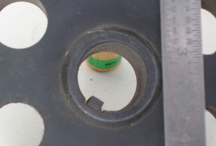

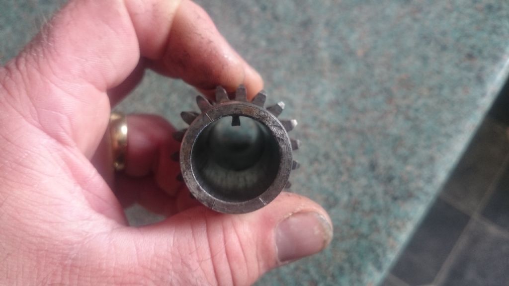

                                    For me, the clue that broaching was used is the view up the inside. The two diameters are not quite the same (or concentric), but the main clue is the axial striations in the bit where the key is, but not the nearer diameter. This is quite characteristic of a broached surface. The slightly smaller diameter at the far end was to allow the broach an easier time in the nearer part, as this end does not contact the broach at all.
                                    I think.

                                    GT390
                                      @gt390
                                      I did find shaft adapters for electric motor drive shafts that had the same type of key, an internal half key at 12 o`clock and external half at 9 o`clock, could not find one the correct size though. The section of the shaft that has the key is much softer material than the half that has the gear, this is evident even by seeing the groove that the rubber lip seal has gouged into the surface of both ends, one much deeper than the other.
                                      I have thrown in the towel and ordered a new pinion shaft and a set of halfnuts for the machine, a painfully expensive experience I must add…….

                                        I think Blowlamp has the answer. I'd be inclined to do the same thing for the repair. Removing all that metal just for a small key section seem to be a hell of a lot of work.

                                          Here's a gear outof my junk collection.
