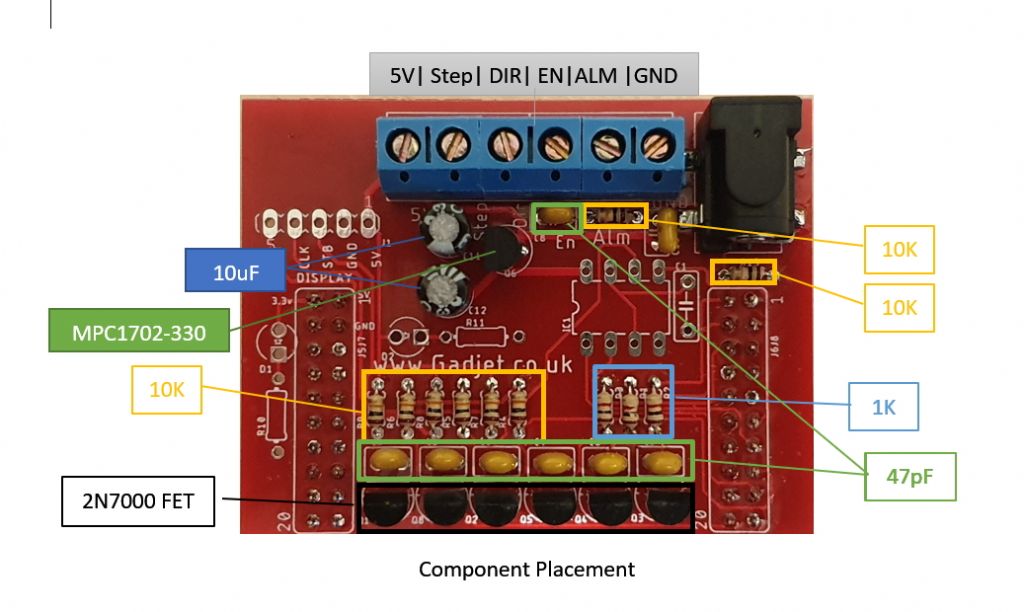

                                            Hi Phil
                                            Can you confirm the order of the screw terminals on the PCB please? I imagine they are the same as Clough42's but I'd like to make sure, I've blown up too much kit this past year getting power connections wrong!
                                            Cheers, Roy

                                              Roy,
                                              Here you go

                                                Hi Phil
                                                Thanks for confirming the pinout, I see the markings on the board now but I wanted to be sure. Good news that it's all working on the bench. Now for the bigger job of engineering the installation. I wonder if anyone has finished their ELS yet and how they got on?
                                                Cheers, Roy
