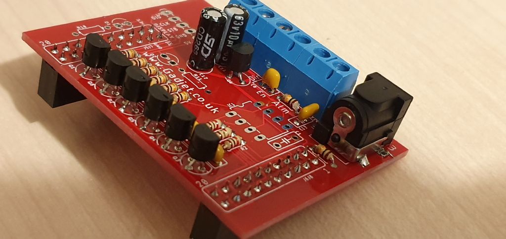

      Here are a couple of pictures of my version of the Electronic LeadScrew project interface by Clough42.
      It is a through hole solution with only the DC power jack being SMD.
      I have used the Album feature of the forum due to some people not being able to see the pictures using a dropbox link.

                                                  Hi,
                                                  Just a word of warning when assembling the PCB components, don't solder in the screw terminal blocks before soldering the SMD power jack in place otherwise you can't access the powerjack solder pads.
                                                  I was just told about this by someone assembling their PCB.
