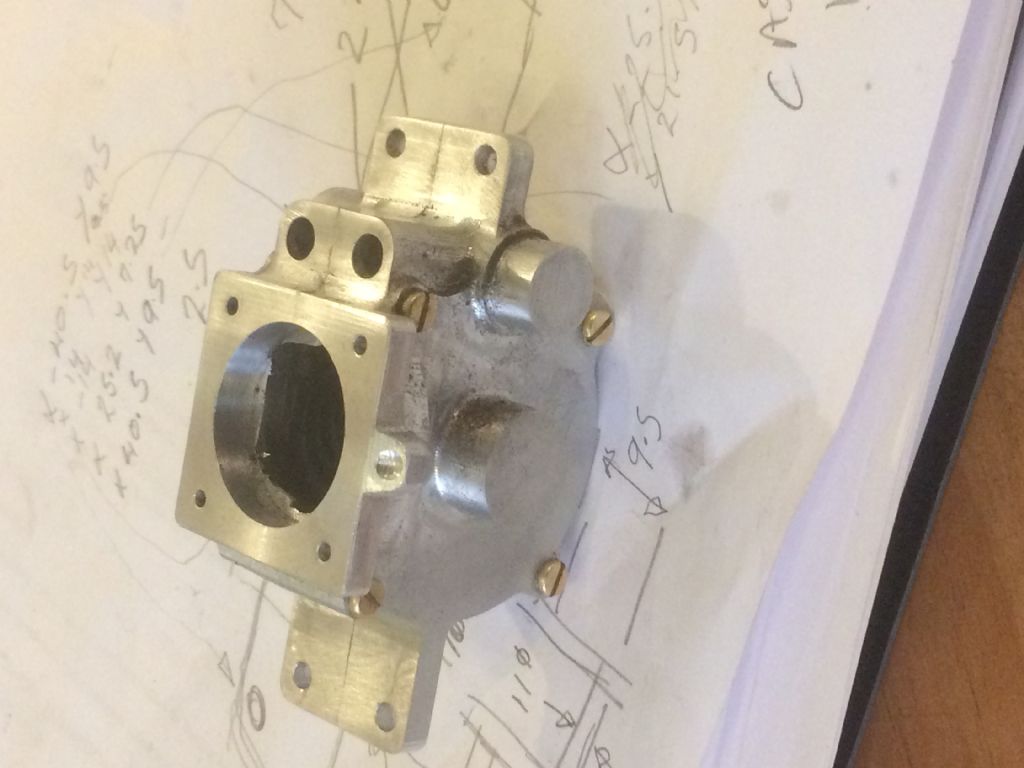

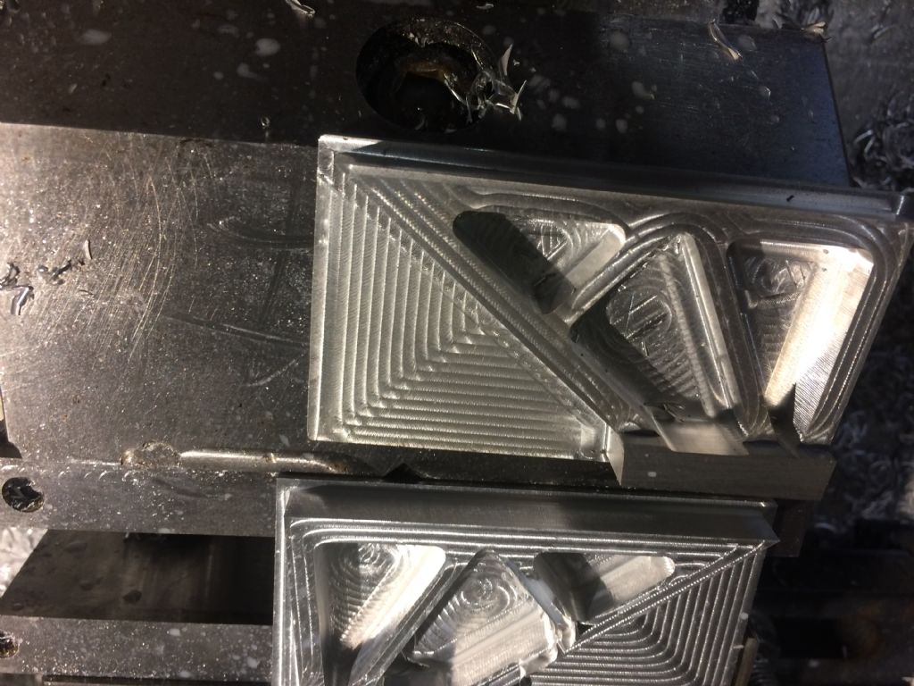

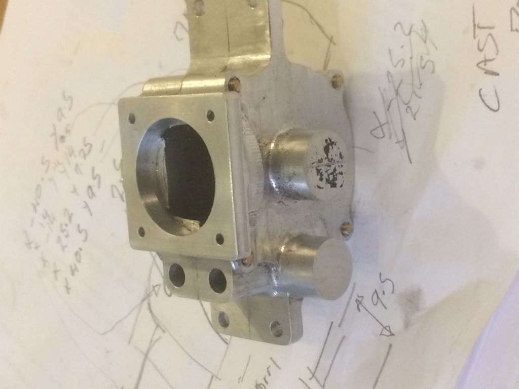

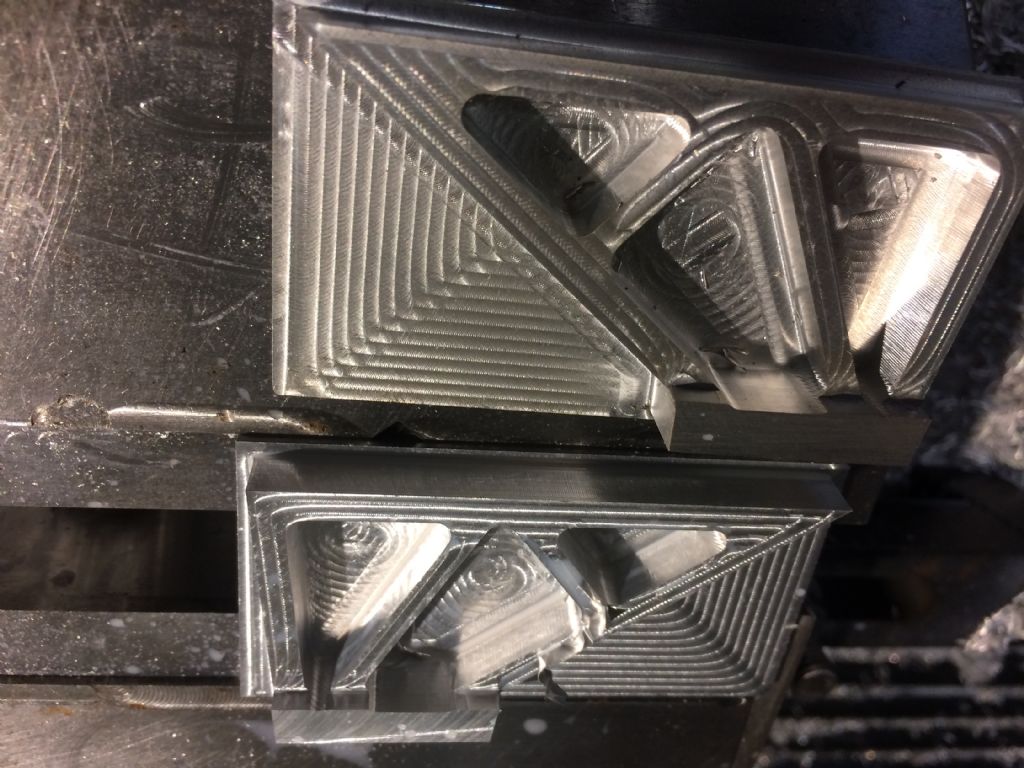

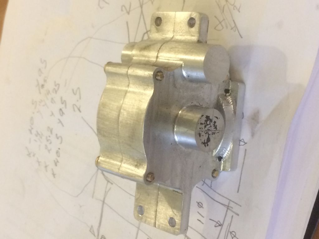

          liked Jason Bs build of the little 36 midget engine and use of of his cnc to machine the parts with a lot of help and many many thanks to him for supplying the original article and drawings and all his cam files here is my build
          made a start today on the engine stand mount brackets will post more as i progress
          Geoff
          #450110
            Off to a good start Geoff, the brackets should look even better once the holding allowance has been skimmed off and interesting to see the different approach of cutting from a solid block rather than the Angle that I had in stock..
            #453259
            geoff adams
              @geoffadams14047
              img_1060.jpgimg_1059.jpgimg_1056.jpghere is the build so far crankcases machined 90% crankshaft machined need to machine journal started on the cylinder and head yesterday spent all day in hospital today back to it tomorrow ,saturday going to Dowton to pick up a bonelle tool and cutter grinder looking forward to playing with a new tool will post more pics as it progressess once again many thanks to Jason b for all his help
              Geoff
              #453279
                Looking good.
