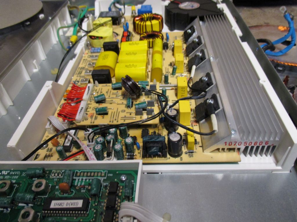

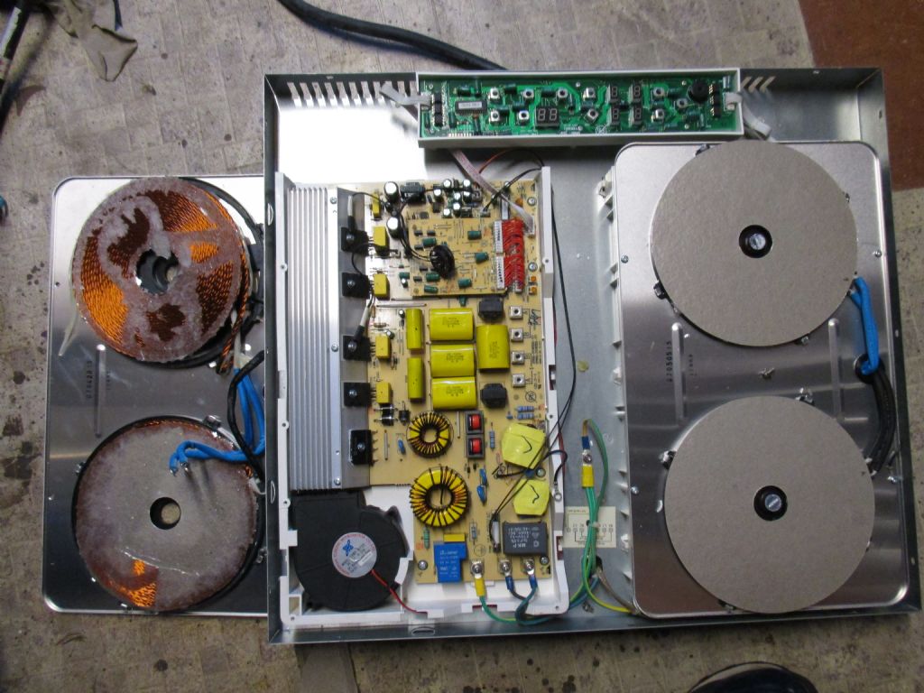

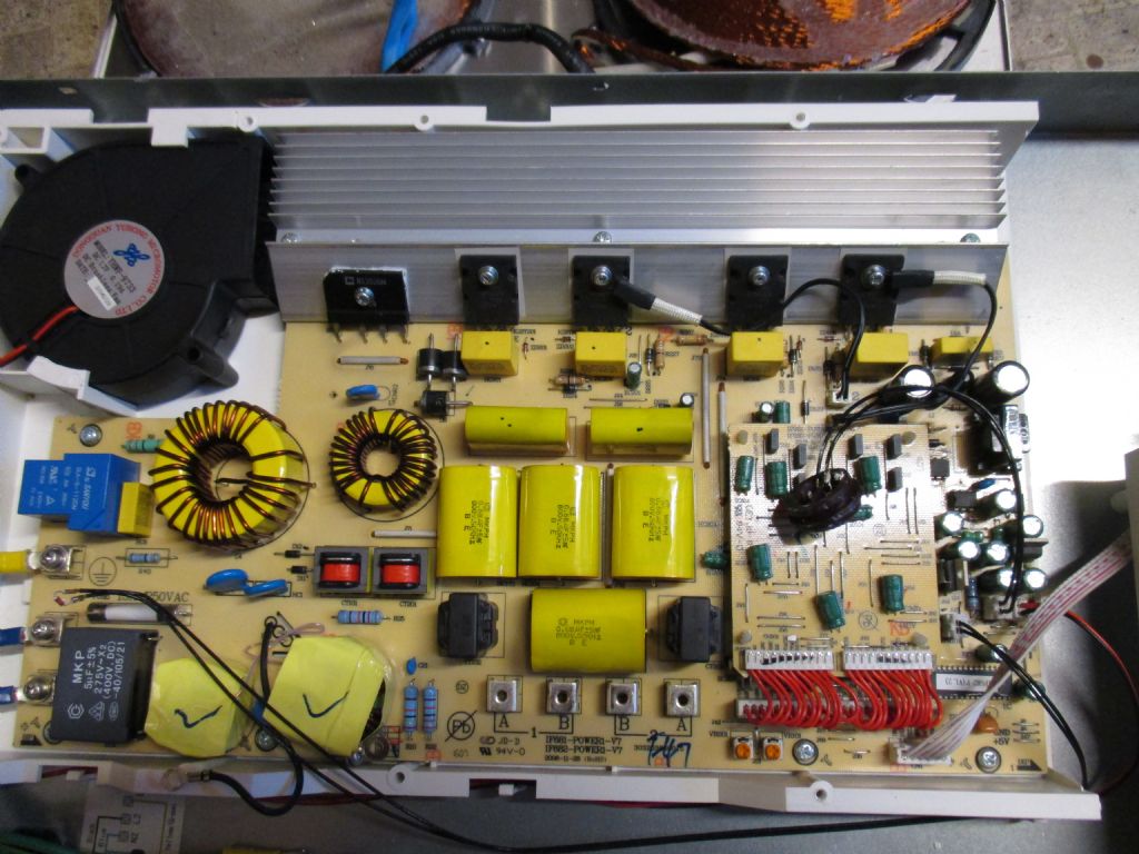

      img_0236.jpgimg_0234.jpgimg_0233.jpgI have just had to replace my induction hob (touch controls no longer worked – seems to be a common issue ) and the retailer I bought a new one from wanted a handful of cash to recycle the old one. Of course, being a cheapskate I declined the offer and decided to have a poke inside to see if there was anything worth salvaging for the workshop.
      Printers and scanners are often mentioned as sources of useful bits, but as I discovered there are some very nice bits inside an induction hob. The electronic bits are big and beefy, there are two huge aluminium heatsinks and some nice sheet aluminium. The glass top looks useful but may not be perfectly flat and the large transistors (mosfets I presume ) look very nice.
      So don't just give all this nice stuff to the retailer and pay for the privilege, recycle it to your workshop. Just noticed a couple of nice 12V fans.
        Doug

                More likely to be IGBTs than FETs, same story in microwaves – usually but not always. IGBTs have a better current density than FETs in the silicon die, so you need less silicon to achieve the same switching capability. Bottom line is that they are more cost effective.
                Murray

                Douglas Johnston
                  @douglasjohnston98463
                  I was wondering if some of the components could be used to construct an induction heater for heating small metal components to red heat. There are some designs on youtube, so I must check out the component values needed and see what I can salvage from the bits I now have.
                  Doug
