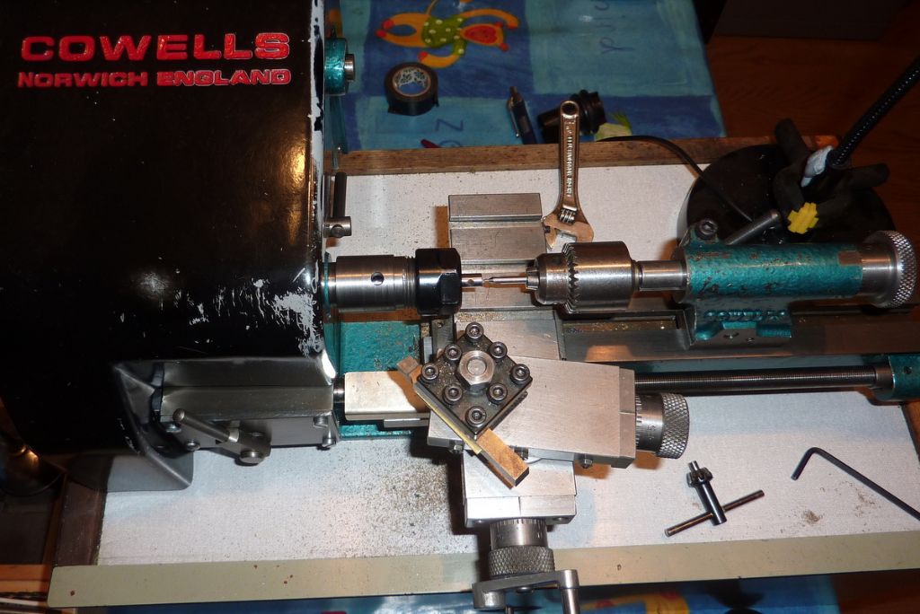

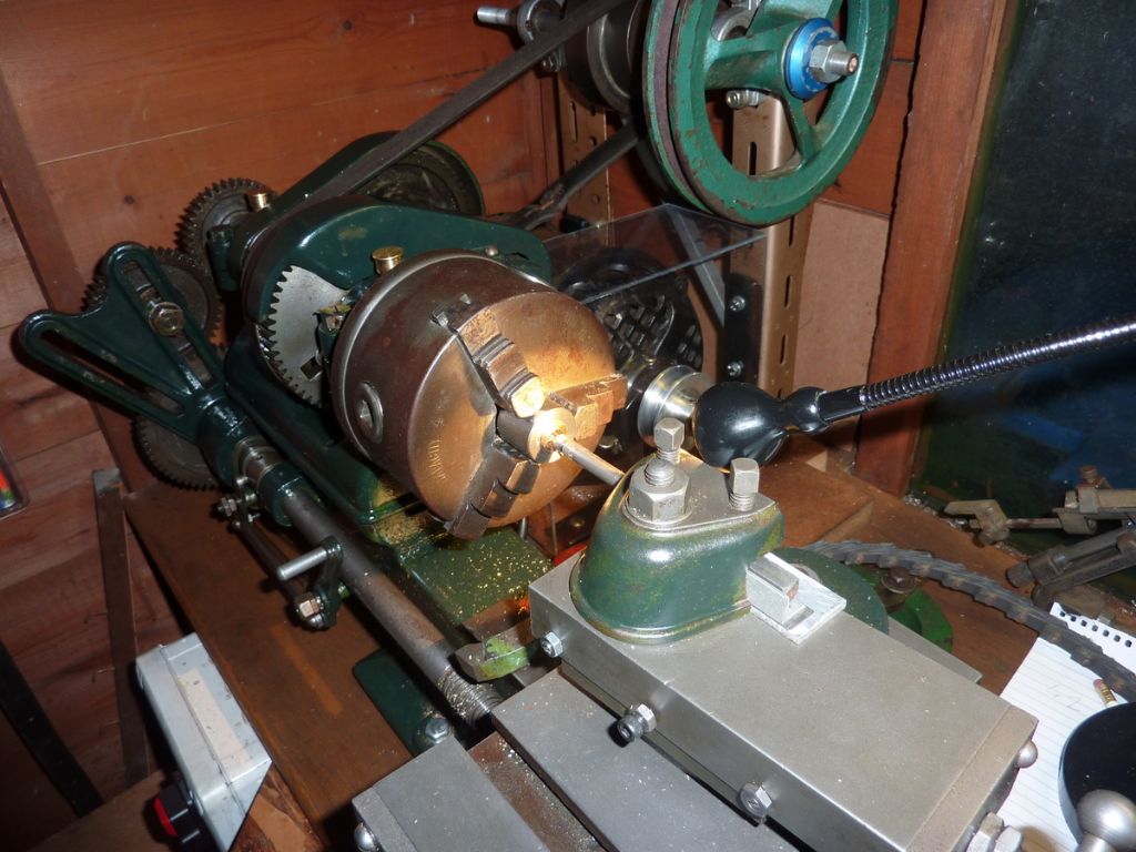

                  Well that went better than expected…
                  A long way from the finished article but the approach shows promise. I had a think and remembered 'The Squire' which came with the lathe when I bought it. I wondered if he could help…
                  I dug out some cheapo chinese 3mm HSS milling cutters and ground up a couple of inserts. Not easy and they both ended up a bit under the correct width but they are not too bad.
                  The job on the lathe…
                  I've made a bush to hold the new cross feed nut in the 3 jaw for drilling, boring and threading. I could have used the 4 jaw but didn't want to squash the job, plus if I'm making several then this way will be less hassle in the long term.
                  The idea was to swap from the short insert to the longer one part way through. The shank on 'The Squire' is 6.9mm and the minor thread diameter about 7.4mm, which means I can only have half the 'stick out' that I need to fully cut the thread.
                  I stopped the job after bottoming out the shorter insert. I've now decided that changing inserts mid-job was a bad idea and I need to make a 'mini squire' that will allow the full thread depth of 'stick out'. I also need to make a proper mandrel handle but turning the countershaft by hand is definitely the way to go.

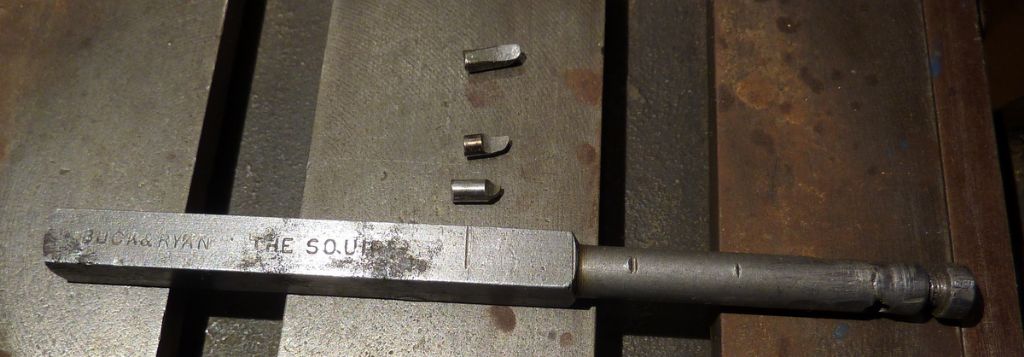

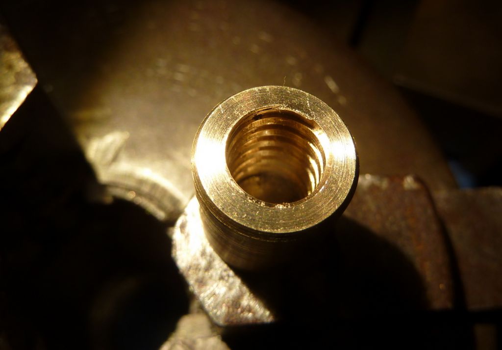

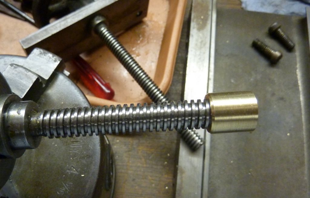

                        This is definitely a learning experience…
                        Got myself a little more 'tooled up' yesterday by making a mini 'Squire' from 6mm silver steel on the Cowells. This fits into the Arc Euro holder that is intended for their HSS boring tool.
                        I also made a handle for the countershaft (which is effective but looks awful so no photos!) and a couple of little gauges from 15 thou brass, one to check the thread width and the other to check the depth.
                        Tonight I had another go at the same cross slide feed nut and proved to myself that I couldn't 'pick up' the thread. No matter… this is a test… I pressed on to the point where the depth gauge just about fitted and the smaller bar and countershaft handle both proved their worth. Then on the final cut the cutting insert came loose from the bar (doh… should have tightened the screw again once it was held in the toolpost).
                        I'd 'lost' the thread again but it was near enough to try. It just about goes on to a not too worn thread but is very stiff. Making a finishing tap should help (still waiting for the silver steel). I also discovered that I'd made a howling error. Can you spot it?

                              Posted by Andy Carlson on 02/07/2020 22:22:07:
                              Possibly getting right and left hand mixed up?
                              #483745
                              Andy Carlson
                                @andycarlson18141
                                Posted by Keith Long on 03/07/2020 17:04:09:
                                Spot on!
                                The cross slide feed screw is at the top.
                                A pretty fundamental incorrect assumption that I've had for so long that I didn't question it…. Oops!
                                No great drama since this is a test and the tailstock feed screw allowed me to do at least some checking for fit.
                                I'm glad now that I'm doing this one step at a time – could have been expensive if I'd gone out and paid for the wrong threaded rod.
                                Incidentally I also thought I'd try checking it on a more worn feed screw. I took the screw out of the 'spare' tailstock… and found that Faircut had changed to 8TPI in the tailstock by the time that one was made.
                                Still waiting for silver steel…

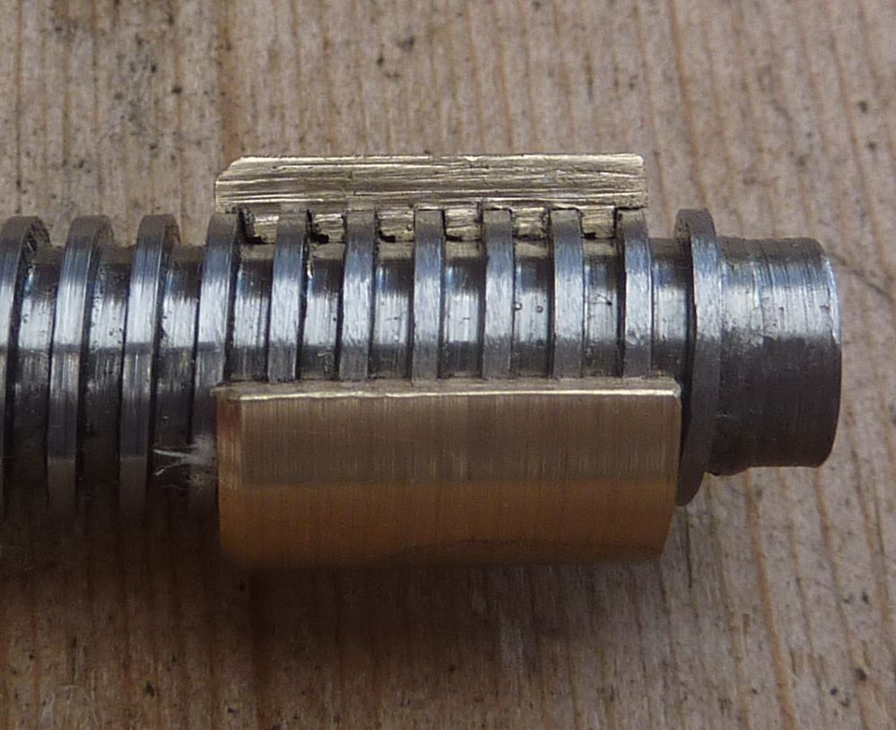

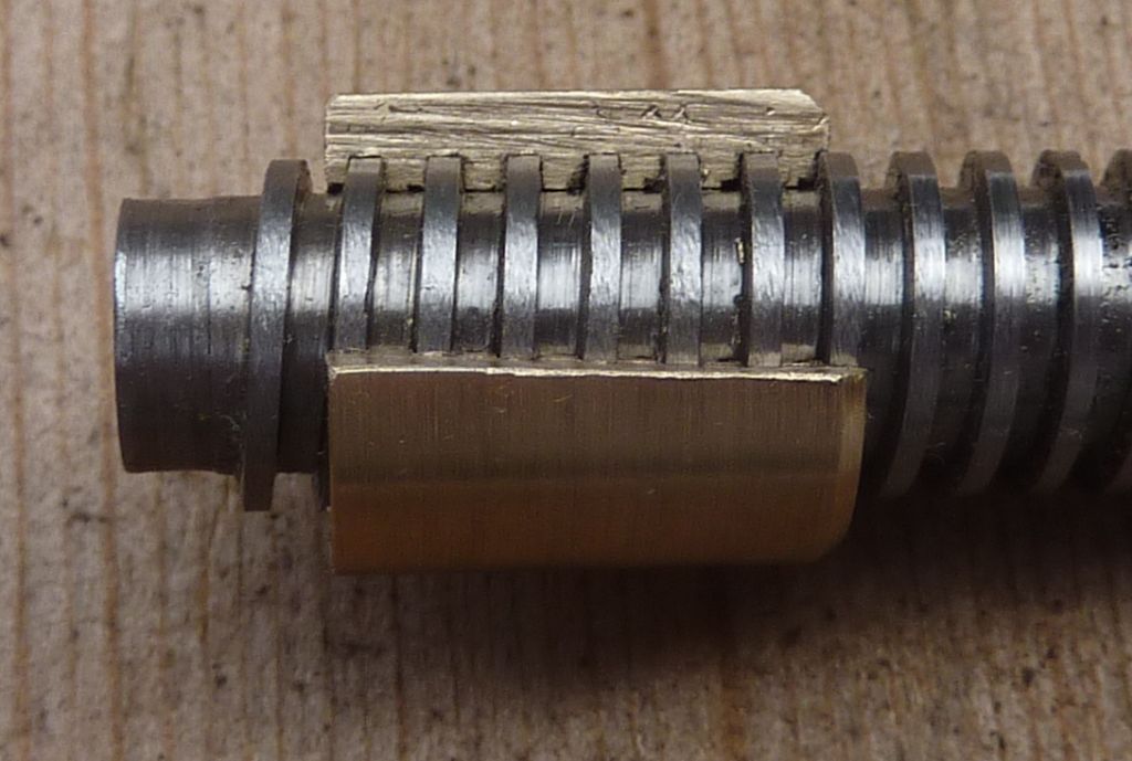

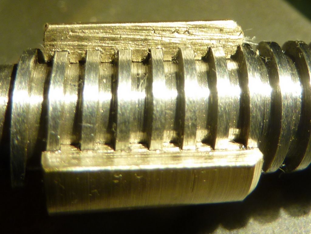

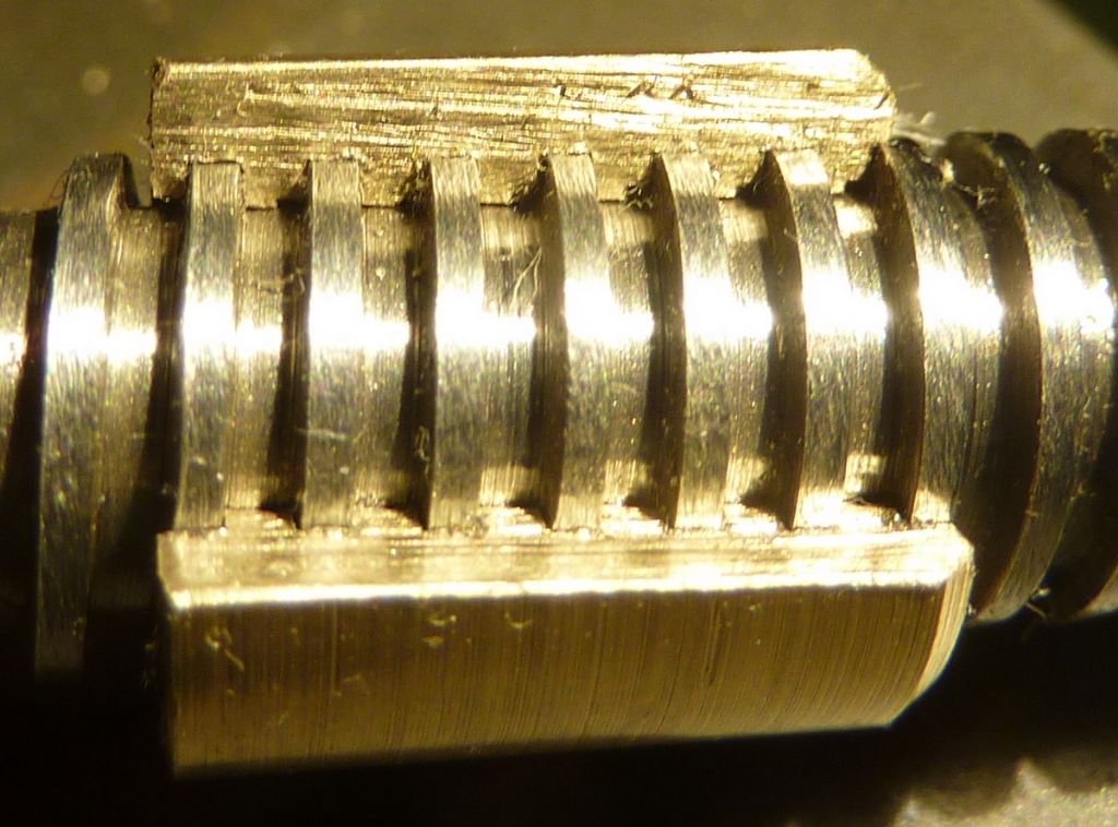

                                            I took Paul's advice and sectioned the left handed nut. I generally find that my compact camera is pretty good at really close up inspection so I took some photos in daylight and artificial light. None of the photos is perfect but I present the better ones here for your personal perusal.
                                            The nut (before sectioning) was very tight on the thread and I could only get it onto the thread by clamping it in the vice. It got stiffer the further I went and I never quite got it all the way through. I got the same result from either end. Had the cutting tool not come loose I was intending to take one more thou (radius) to deepen the thread.
                                            The threads on the tailstock screw measure with calipers at 0.85mm. I think there is wear but it is pretty even along the screw. For comparison the very end thread on the compound screw measures a full millimetre.
                                            The odd 'step' in the thread is because I was unable to correctly 'pick up' the thread for the second session so you have a partly cut thread overlapping the almost fully cut one.

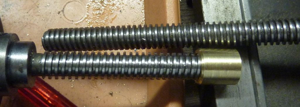

                                              A little update on the cross slide nuts…
                                              I've made a short section of male thread from some 3/8 steel bar so that I have an unworn example to test with. This did not turn out perfectly. Practice nut No 2 went most of the way on with a healthy degree of drag but is quite tight on the last half inch. As far as I can tell this is the result of pitch error. I noticed when tidying up the point where I stopped threading that the tool did not pick up the thread correctly at that end even though the screw cutting train had not been disengaged and the backlash was going the correct way. I can only conclude that the tool was pulling itself ahead of the leadscrew and into the backlash a little.
                                              For practice nut number 3 I made another threading tool from the 3mm HSS mills to 1 thou over the nominal groove width. I was expecting the usual struggle and fettling when I finished cutting but the test thread screwed in at the first attempt. I foolishly allowed myself to start thinking that I was getting the hang of it and moved on…
                                              Practice nut 3 has been cleaned up and pressed into recess in the spare saddle. That put an immediate stop to any impression of progress. Even the worn feed screw would not screw in without a major struggle. Clearly the nut had compressed significantly. My plug gauge would not go in. A quick touch with a tapered reamer allowed the plug gauge in and the worn screw went in after cleaning up a slight wear ridge that was making it oversize. This revealed that the screw was not quite parallel to the slides – an error of about 1mm in 90mm.
                                              I've concluded that trying to make a correct concentric nut, press fit it into the saddle and expect it to work is not going to fly. I've now started making a tap which hopefully will be able to finish cut the nut threads in situ and allow the correct alignment for the feed screw. The tap needs over-width threads and underwidth grooves… so another threading tool was made. Including the rejects I think I've made six so far. I'm glad I'm using 3mm HSS – it would take a lot longer to make six of them from 6mm HSS.
