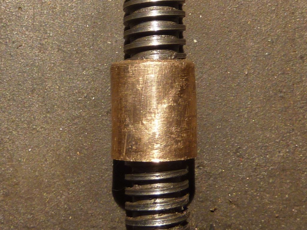

          Andy Carlson
            @andycarlson18141
            Yes indeed… thoughts are turning to making a new nut.
            Materials… I'm sure I've seen plenty of discussion on various forums, not all of them entirely relevant to an 80+ year old lathe. From memory the front running options seem to be brass (on the basis that it will wear in preference to the screw), leaded gunmetal or colphos 90.
            Replacing the screw is also on the cards at some point. If I keep a square thread form then I can do one job at a time. If I was in the US then I'd probably buy some 3/8 x 12TPI LH ACME threaded rod and a matching tap all of which seem readily obtainable over there but not so easy/cost effective to get over here?
            At the moment the plan is to use 3/8 silver steel to make a square thread profile tap (or is it three taps?) to match the existing feed screw. Then I can replace the feed screw as and when the mood takes me.
            I will likely be doing this job several times over so making taps to suit should be worth the effort… if I can do it.

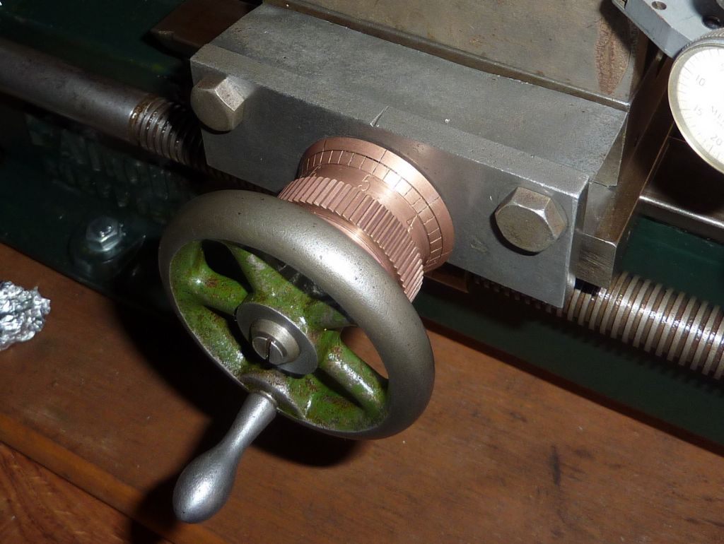

                      Andy Carlson
                        @andycarlson18141
                        Yes I really want to stick with 12 TPI in spite of it being a bit silly.
                        The cross slide (the proper one, not the spare) has a nicely made brass resettable dial using the usual 80 graduation fudge. I'd be really loathe to lose that or make it so that the scale was meaningless.

                          Andy Carlson
                            @andycarlson18141
                            Posted by old mart on 24/06/2020 21:41:42:
                            How do you intend to produce a new nut in 3/8 x 12?
                            I think DiogenesII was correct yesterday. The hole is not concentric so the insert needs to be pressed into the casting and the hole and thread made in situ. So whatever thread I choose will need to be tapped I think.
                            Can I make a square thread tap (or three) myself?
                            No idea but I will give it a go. Worst case I will press the thing out again and go with a different option.

                              To find if the thread in the nut is concentric with the od, all you have to do is screw the nut on the leadscrew and see if it runs eccentrically. I would bet on it being in the same centreline, these big threads have a way of producing optical illusions. What is the OD of the nut?
                              #482174
                              Andy Carlson
                                @andycarlson18141
                                Posted by old mart on 25/06/2020 16:37:09:
                                Good point.
                                So I went and checked… but I think it really is not concentric.
                                OD measured at between 0.505 and 0.511 depending on where I measured it (and that was avoiding the ends and the area around the grub screw hole).

                                  I assume that you took it off because it is so worn that the backlash is unacceptable. When the thread is worn, the wear may well be biased to one side, if there are sideways forces, or even gravity. I realise just from seeing the dreadful design (only an idiot would bore a casting so close to the edge) that you worry about the concentricity, but would it matter if the replacement was made properly?
                                  Don't worry too much about my ranting about the quality, I have seen the guts of a Tom Senior mill, and the quality of that particular example leaves much to be desired in design and the dreadful casting quality.

                                    Yes I was thinking that it might be worth just making a concentric one using single point threading… although even then I will need to make a tool to do a square thread inside a 7.4mm (I think) hole. The front plate on the cross slide is hardly high tech – just a flat steel plate with the hole for the feed screw and a couple of 1/4 BSW fixing screws. The 'aim' judging from the old nut seems to be about 0.5mm left of centre.
                                    Whether an internal threading tool is a sensible idea is debatable. I've seen opinions expressed elsewhere that 3/8 is below the size at which one whould switch to tapping.
                                    I agree the design is pretty odd. I don't think Faircut had really got the hang of the whole lathe thing when they made this but one can't be too critical – mine has lasted 80+ years and is still usable… plus they have provided me with a way to refurb the cross slide nuts – a job that would be a more difficult proposition on a lathe with the threads cut straight into the cast iron.
                                    The nut in the spare is on the verge of a complete thread breakdown which is actually quite useful because I now have no qualms about messing with it. The proper one is not so bad but there is still significant backlash in my cross slide and if I can make it better then I would very much like to do so… after I use the spare for practice.

                                        Yes 12 TPI is an odd number when you put a dial on it but I dont think that the Faircuts were the only lathes to use 12TPI.
                                        The usual fudge is a dial with 80 graduations… which is what my lathe has. It seems pretty well made (and resettable) but some of the graduations are a bit wonky so maybe not a factory item. Anyway, whatever its origins, I like it.
                                        I say the 'usual fudge' but in practice most 12 TPI lathes probably had no dial at all. If one is resorting to chalk marks on the handwheels or whatever then 12 TPI is probably not a big issue.

                                              I want to keep the existing dial so I will live with the 80 division oddity (if I can manage to make a new 12TPI nut anyway)
                                              TBH it is not a big issue for me. If I want to know how much cut I am putting on it is perfectly fine for that. If I want to turn down to a size then I get the mike out anyway. Quite often the job is metric in any case.
