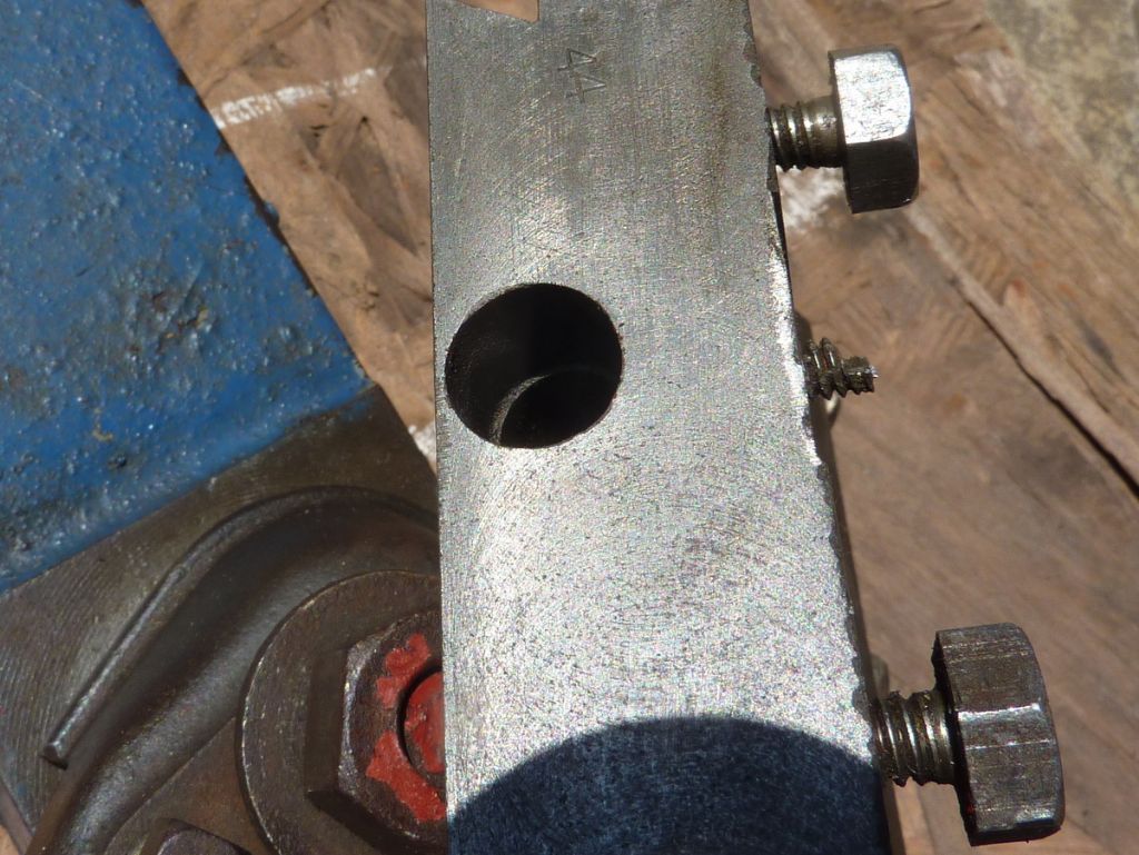

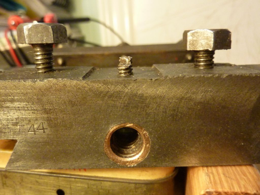

      I'm not sure if Faircut used a design similar to other lathes but so far my searching hasn't turned up anything similar. The nut is a non ferrous insert into the saddle (the compound and tailstock barrel have a similar arrangement).
      A slotted grub screw bears on the insert. I've got the screw out (it broke a bit) but I'm not much wiser. A straight pull with the leadscrew showed no sign of shifting it. The lack of concentricity on the cross slide insert suggests it may be threaded but getting anything to turn it will take some thinking. The compound insert doesn't show such noticeable eccentricity.
      I can speculate on how to shift it (or drill it out) but I'm hoping that someone has seen something similar and can give me some clues.

          At a guess, it is merely pressed in. You should measure both ends just in case there is a shoulder, otherwise some sort of puller should be made, or use a press if you have one. If you are still concerned about the possibility of it being screwed in, then either turn up a piece of metal that just fits the bore nicely, with an end the same size as the interface between the bronze and cast iron. That would prove the presence or absence of a thread. You could also measure the interface diameter at several angles to see if it is round or not.

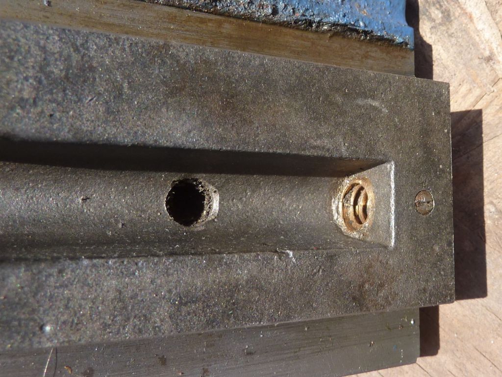

            The other end is quite deeply recessed in the casting so it's not possible to do any useful measurements there (same on the compound).
            The cross slide insert is pretty convincingly non circular… which would suggest the start of a thread but the situation with the compound is not so clear.
            I have a theory that Faircut liberally borrowed ideas from other lathe makers so I'm hoping that someone will say 'ah, that's exactly like the XYZ lathe'.

              Hi Andy , Your insert is so close to the bottom of your cross slide ,Just like mine was at the top which was why I made my replacement the way I did fear of breaking the top of my cross slide , Yours very little room to play with i will watch this operation of yours with interest. I wonder if this has just been pressed in does not like this could have been screwed in . Before i had a lathe. I had a small pulley made for a motor when collected was told this will not fit your motor shaft . Put the motor in the freezer for 24 Hrs Then push the pulley on do not use for 24 Hrs . This I did and it ran for years without any further problem the machine was eventually scrapped with the motor still OK
              Good luck Brian

                It was upside down when I took the photo but I take your point
                If it is pressed in then I struggle to see why it would be worth having a grub screw but who knows.

                  You mention the deep recessing of the other end, I would then expect any threads in the cast iron to be visible. The only time I have seen nuts like this in threaded housings is if there are two in the hole and there is backlash adjustment. The Smart & Brown model A tailstock has screwed in nuts to Adjust the backlash. There are slots in the outer nut to turn it.

                    ..well, if iti helps to provoke discussion, maybe they fitted plain slugs and secured them with a grubscrew, and then spotted the thread-centre through the leadscrew brackets after they were fitted-up, in order to ensure alignment.. ..wouldn't be odd for them to come out a bit off-centre..
                    If they are pressed in, they'd still have to be positively located by a screw/pin/collar to resist the thrust of the screw causing "creep"..
                      If the hole is blind I'd pump it full of grease and wind the screw into it. If it's a through-hole I'd wind the screw right in then punch it out with an aluminium drift against the end of the screw.

                        Posted by old mart on 23/06/2020 20:39:44:
                        Edited By old mart on 23/06/2020 20:40:12
                        That's a good idea. At the moment it's all darkness and decades of crud on t'other side but I shall give it a clean and see what turns up.
                        I doubt there is anything so clever as backlash adjustment going on here.

                            Not blind. It will need a shouldered punch making up I think. The surviving threads in the saddle insert are paper thin and wont take that sort of force… but no point beating away at a punch if it's threaded so I need to be as sure as I can on the answer to that question first.
                            Happily both the cross slide and compund screws are 3/8 inch so hopefully I only need to make one tool.
                            BTW, the saddle in the photo is a 'spare'. The one that belongs to my lathe should have less wear but I'm not intending to mess with it until I know that I can make this work on the 'spare'.

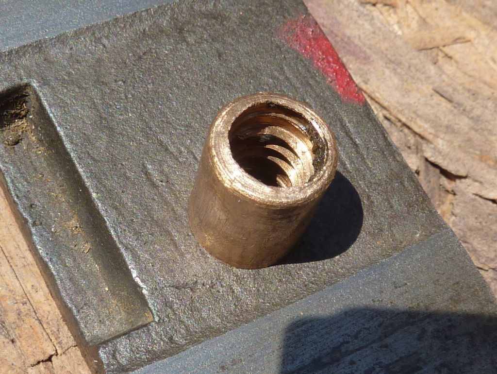

                                      Thanks. A close inspection (…or as close as I can get) of the less accessible side of the inserts is definitely on the agenda for today. Hopefully it will help me to figure out whether the thing is threadded or pressed in.

                                              The edge of the casting adjacent to the bush at the 10:00 to 11:00 position looks like it is proud of the surface like the start of a thread being pushed out. This might mean it is threaded. As this is a spare I'd suggest a semi-destructive investigation. If you have a mill start to cut away the end of the bush at it's thickest point. Use an end mill bigger than the thickness of the bush but less than half th diameter. It should be obvious if there is a thread as ou will hit cast iron. A drill or even slitting at an angle with a hacksaw blade (with the height reduced by grinding) would also do.
                                              When removing by whatever method, applicatin of heat will help a lot. A paint stripping type hot air gun is a useful heat source and safer than an open flame.

                                                You mention a load of crud in the recess; are you sure the insert wasn't pulled in rather than pressed.
                                                i.e. a bit like a top hat bush, with the grub screw just to prevent subsequent rotation??
                                                Maybe screw in the leadscrew itself, almost all the way, and tap the end with a suitable hammer and a bit of copper to protect the screw end.

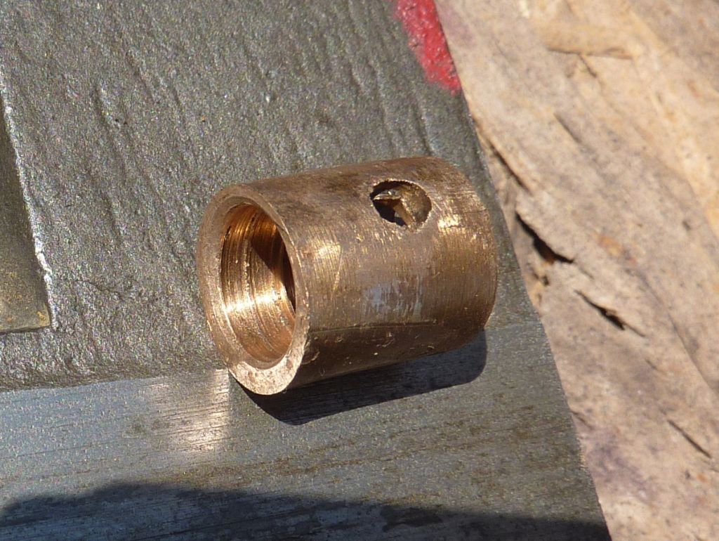

                                                      After a good clean of the less accessible side of the insert in the saddle it seems that the hole behind the insert is 7/16 ( a good deal smaller than the front face of the insert) and there is no sign of a thread.
                                                      I decided that I was looking at a pressed nut and tried some cautious exploratory hitting on the end of my 7/16 brass bar. To my pleasant surprise it started to move before I chickened out.
                                                      So now it's out and pretty much undamaged I call that a result. Thank you for all of your input. Definitely a case of several heads being better than one.
                                                      The hole does indeed have a stepped recess.
                                                      I've miked the outside of the nut and (avoiding any potentially deformed areas) it reads between 5 and 10 thou over 0.5 inches… quite a wide range.
                                                      The compound will need a bit more thought because having cleaned out the crud it's clear that instead of a stepped hole the casting just overlaps part of the rear of the insert. I will need to make a custom punch to shift the nut but I'm not planning to mess with the compound until I've made some progress on the saddle. The saddle threads are pretty much trashed but the compound still has some life left in it.
                                                      For future reference I'd press the insert out or use the puller idea rather than hitting on the end of a brass bar but we will gloss over that for the time being.
