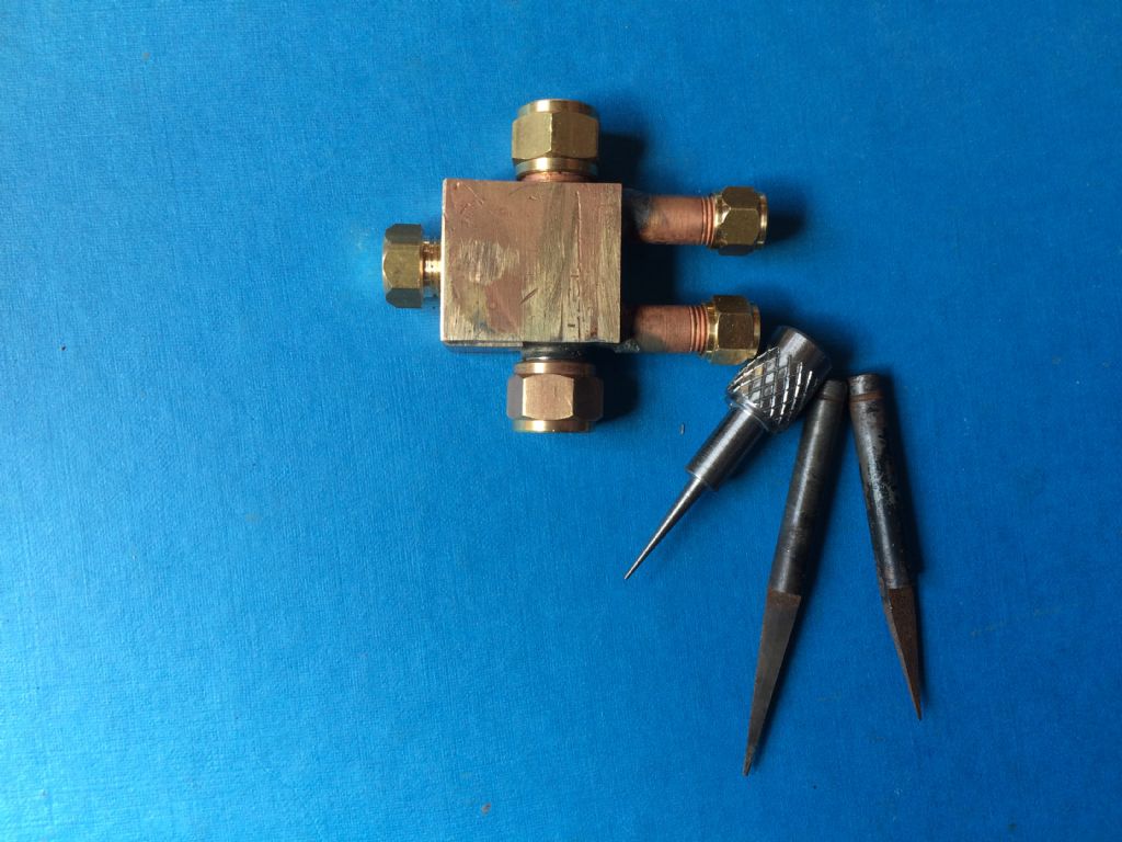

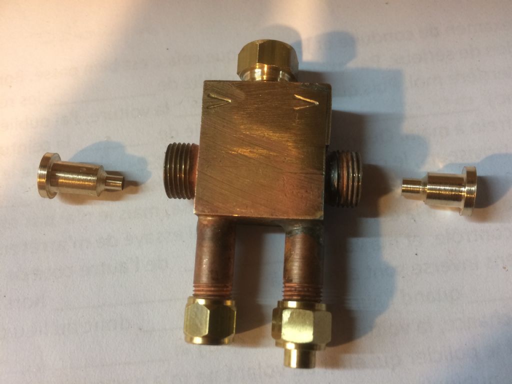

                                  Here is my first attempt at one of Peter's injectors for 5" gauge loco. The 'D' bit tapers seem to work OK. They did need quite a push to make them cut. Drilling the small cone holes – snapped a couple of the number 65 drills before discovering that I was drilling PB102. A change to a softer bronze made things easier, pecking the drill every 1/16" more or less. Just need a boiler to see if it will work. Ps I marked the body to indicate steam flow.

                                    If you had to push hard on the D bits it indicates they are blunt sharpen them up by rubbing the flat along a smooth hand stone they should be sectioned just a couple of thou over the centre line.

                                      Just been in contact with Peter and he points out that the overflows shouldn't be threaded with a pipe connection, it needs it to be a free flow a short pipe.

                                        Thanks Stew, I only threaded it in case it needed extending, which I could do with pipe larger than the overflow pipe I guess. The bore of the pipe is 3/16" as to plan.
                                        I need to make a I need to make a check valve which follows the injector now – Always something to do!
