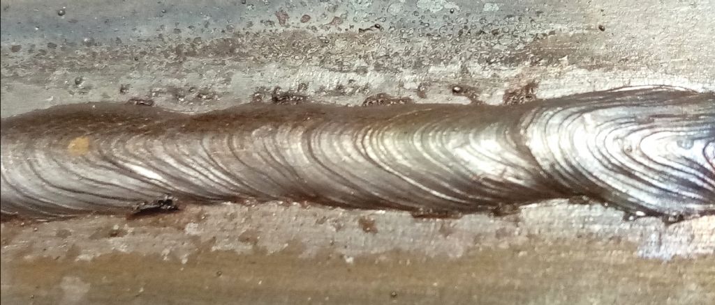

                A close up picture of a weld from this morning which I thought not too bad, it's a bit neater than I thought I would get though it could be better I know. The driving seat I am going to build will be 1 inch x 14swg box so have ordered some 2.0mm and 2.5mm rods as I think the 1/8th rods I have will be too heavy.
                #547763
                Ady1
                  @ady1
                  Nice weld but the flat straight ones make us think we're getting good
                  Then we try a vertical or a corner….
                  2.5mm was my preferred size because it just laid enough metal, 1.6 and 2.0 rods don't last long at all
                  I got fed up cleaning slag off, half my time was spent cleaning up welds
                  The cheap gasless mig on the other hand arcs instantly and only leaves some soft dust which can be brushed off
                  Edited By Ady1 on 30/05/2021 10:08:23
                  #547766
                  Nicholas Farr
                    @nicholasfarr14254
                    Hi Ron, 1.5 or 2mm should be large enough for 14 SWG steel. You weld isn't so bad, but the profile should be much flatter, you may have it a little too cold and thus getting a build up of metal, your ripples should look more like a bracket shape like this (((((((((( so you may be moving too fast as well. But don't give, practice will help just keep trying different settings and different electrode sizes.
