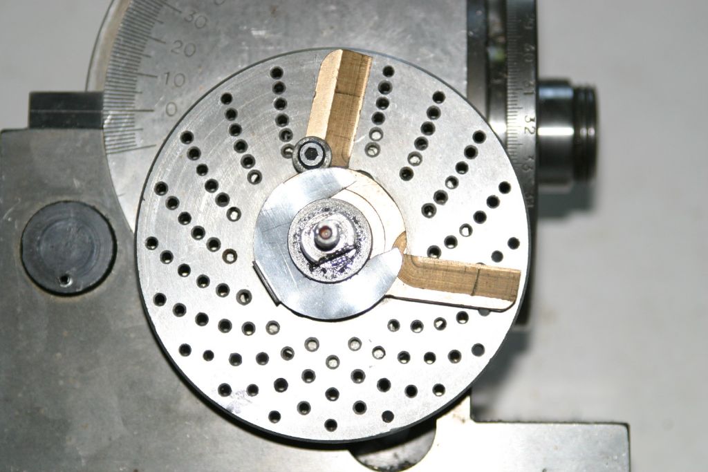

      Hello, I am new to the group today so will be heading to the "introduce yourself" page shortly. I find myself here because I am about to use an old dividing head for the first time but immediately ran into a problem.
      The brass indexing arms fit over the centre shaft but there is nothing to provide any tension/friction to keep them in place. The shaft has what could be a circlip grove in it approximately 1mm out from touching the arms, so I am assuming there is a brass? washer type piece that presses against the arms to stop them spinning freely.
      Could someone tell me what pieces are missing please. I.E brass shim or spring or something I haven't thought of?

          There should be something to provide some friction so perhaps a wave washer and circlip are missing.

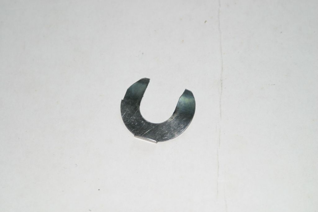

              There should be a thin, spring steel "washer" (For want of a better word ) that fits into the groove and presses onto the two arms, to provide eniugh grip to stop them moving by accident.

                I suspect you are missing the part shown in the photos below. It is a dished half washer and fits in the groove you mention to apply some tension on the arms to keep them from moving but still able to rotate to position them. Should be easy enough to make something suitable.

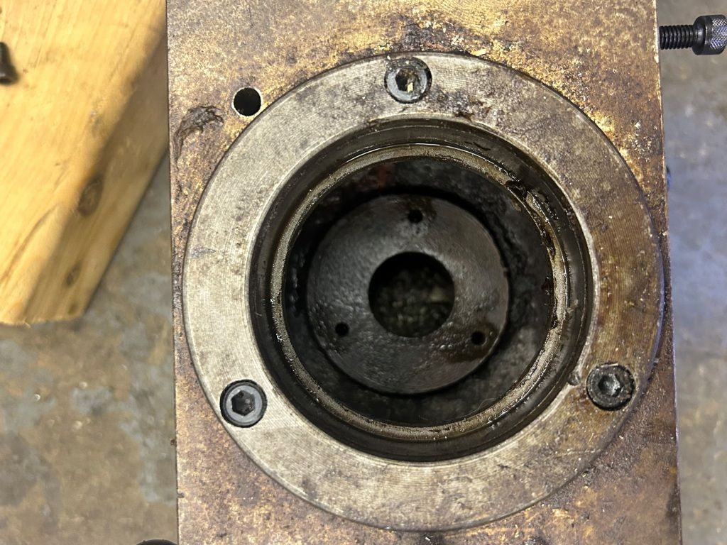

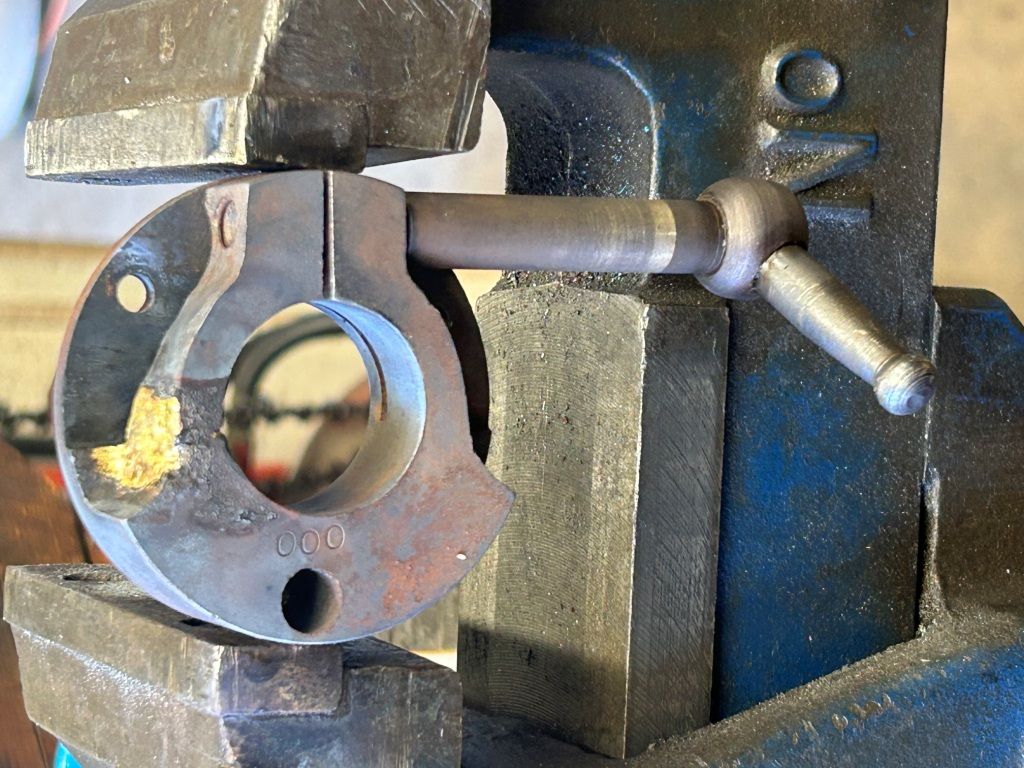

                  Due to its age and not having been used for at least 25 years, and to clean it all up so I can use it, I decided to strip it. Unfortunately I found the "brake" is broken. Without a makers name, how would I go about getting spares?
                  I have brazed it just now but not sure how strong it will be. Sorry for the almost certain incorrect terminology.

                              being pessimistic, have doubts about bthe stregth of the repair.
                              BUT, if you use your lathe to make a new one, the brazed D H lock might last long enough for you to complete the machining, and so be able to fit a replacement locking device.
                              It might even be worth extending the machining on both sides a little further towards the holes.
                              FWIW, I would suggest making the bore as close a fit on the mating part as possible, to minimise the bending of the arms. It might be worth extending the depth of the slot until it intersects the solid part of the clamp, to make the arms more flexible and to move the point of bending.
