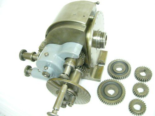

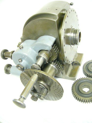

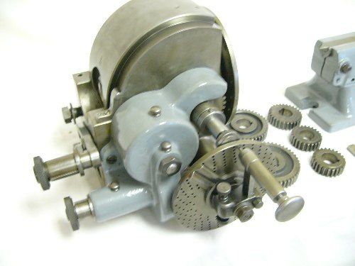

                              Posted by Anthony Rhodes on 20/06/2010 04:01:20:
                              Speaking of indexing, I would like to get a comprehensive set of photos of Ivan Law's home built Universal Spiralling and Differential Indexing Dividing Head which was featured in MEW a couple of times and probably in ME as well. Large format would be ideal, no file is too large!
                              This was made between 10 and 15 years ago. It's a semi-replica of a Brown & Sharpe original but scaled down to 50% or lese of the original size. I have some info on the original B&S heads and a small amount of info on Mr. Law's but photos from various angles would be extremely helpful. (If anybody happens to also have size info, that would be extremely helpful, things such as center height, DP of gears, spindle taper, etc.)
                              Please, if you have something useful send it, don't presume somebody else will take care of it.
                              Thanks.
                              Anthony
                              anthrhodes @ aol dot com
                              P.S. I was going to insert a photo of a B&S version but I can;t figure out how.
                              Quoting myself above, here are photos of the type of B&S dividing head of which I was speaking:
                              I'd really like to get a design for this type of dividing head with a center height of 2.0" or less.
                              Anthony

                                Me too … 'though I would use it with a stepper

                                    I appreciate the suggestion but taint the same thing. I'm interested in inclusion of the differential gearing for divisions not available with the standard division plates and the ability to gear the dividing head to the feed screw on a mill in order to do spiraling work.
                                    Anthony
