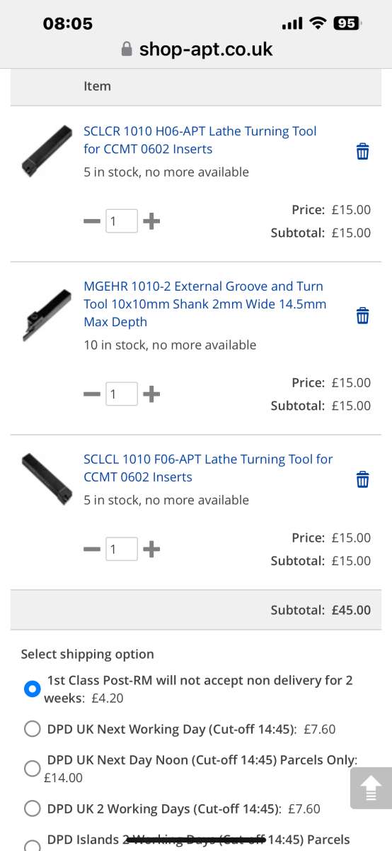

          patgas
            @patgas
            Basket so far, can’t find a 1.5 version of parting as suggested anything I may add to get me going .IMG_3786

                Add a couple of CCGT inserts to your basket, APT sell them in twos for hobby use, these are the ones I use.
                APT only do the 1.5mm holders with big shanks, you will probably have to take pot luck with one of the far eastern market places to get them with a smaller shank. Though ground inserts in a 2mm width may be OK on a Myford.
                What sort of diameters do you see youself parting off? The MGMN are limited on diameter and also a bit weaker, the blade type I posted will go deeper so larger diameters can be parted. Or if you are only doing small work then there are 1mm inserts and holders, I use thes e alot not just for parting but things like piston ring grooves and the undercut at the end of a thread.

                patgas
                  @patgas
                  Would that parting tool be ok ?
                  Im only making spacers,washers general bits for restoring motorbikes etc nothing big or of any length
                  #753256
                    As a tool it is fine, I have the 12×12 (cut down to 12×10), My lathe is a bit bigger but there are plenty of others who use the 2.2mm wide GTN style inserts on Myfords so should be OK and some non ferrous inserts are always an alternative.
                    With all of them check 10mm will fit. That is not what fits the toolpost it is what fits at ctr height as some toolposts won’t go down low enough to allow 10mm tooling to fit.
