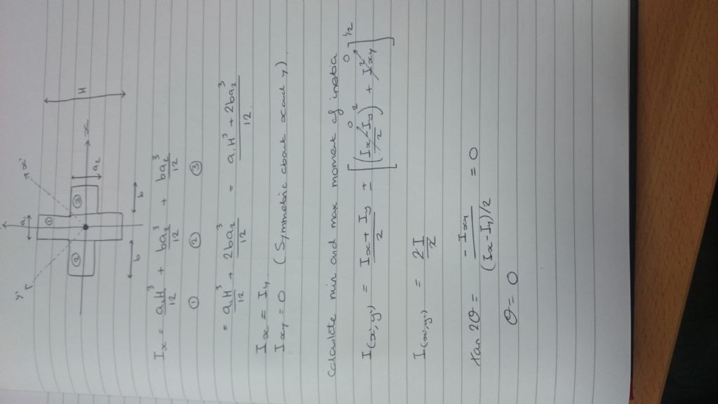

                          I just did a quick check of a 50x5mm steel tube when filled with concrete. The maximum increase in stiffness (ignoring differences between the tension & compression sides) is only 10%. As mentioned above, the best way to significantly increase its stiffness would be to put it inside a bigger tube or get a solid bar.
                          Incidentally, a bar in the shape of a cross has the same stiffness in any direction. So a + and a x that would fit in the same tube would be equally stiff.

                            This second statement is incorrect as the second moment of area of the cross (taking moments about the same plane) will change as the cross rotates about its centroid.

                                    Posted by Michael Checkley on 07/06/2015 23:22:47:
                                    This is a common misconception, which is why I mentioned it. For a shape such as a cross with equal leg legs, the second moment of area is the same at any angle: do the math for a "+" and a "x" and you will see!

                                          Got me on this one, but a good exercise smiley. I was looking forward to drawing a Mohr's circle but it didn't get that far!

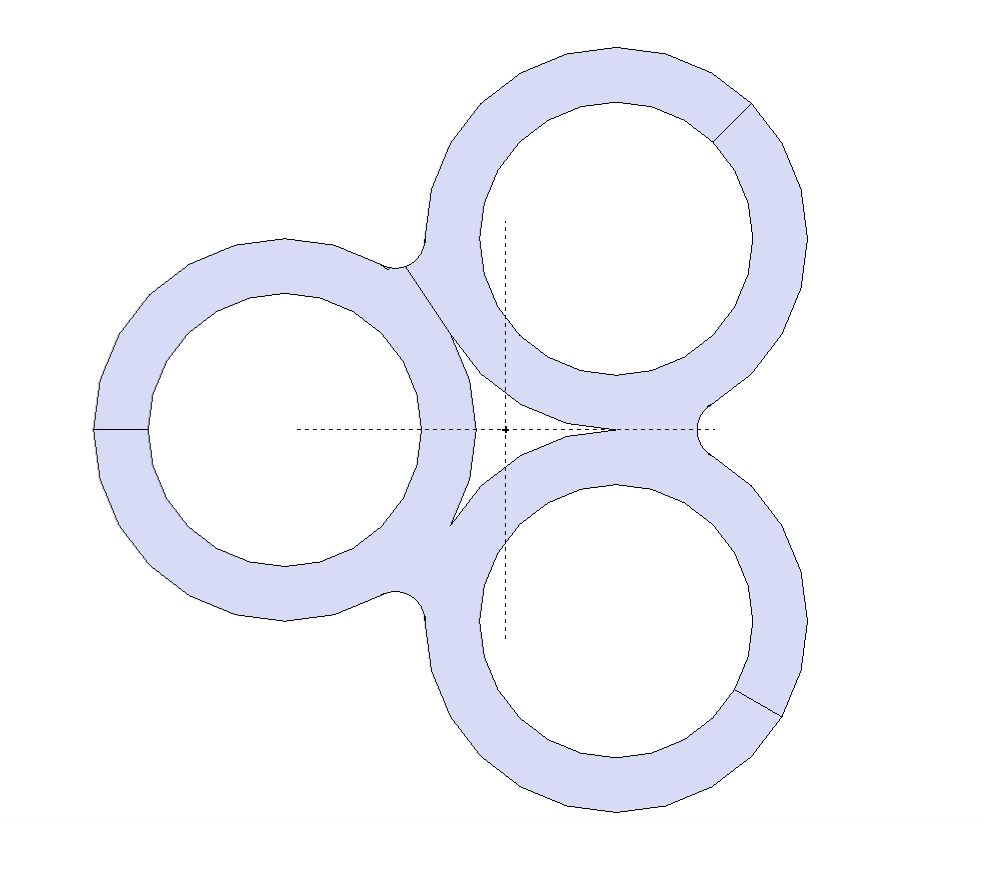

                                            Given this Shakespearean accusation from our Moderator, and no comment from anyone else; I wasn't going to bother posting … but it may useful to someone, sometime:
                                            According to the SketchUp plug-in [mentioned above]: the welded cluster of three tubes [*] is approximately 8.4 times stiffer than the single tube.
                                            [*] 35mm O.D. x 5mm Wall

                                              Hi Michael, I had also thought of using three tubes as per your drawing, although my first thought was to use seven tubes together which would be more circular but of course would be much more bulky and be very difficult to weld them together with total success.
                                              Regards Nick.

                                                On the subject of welding [of which I know very little] … I think it would be quite adequate to 'stitch' the joints instead of using continuous welds.
                                                Note: The main stiffening purpose of these welds is to prevent the tubes sliding along each other.
                                                  Impressive, clearly a good way to go if you only have small tube, and stronger and more compact than a tube of twice the diameter.
                                                  A tube three times the diameter (i.e. with the same amount of tube in it as three smaller ones) would be 27 times as stiff.
                                                  I would be keen to see Ady make up a triple tube accurately enough for a yoke to move up and down it smoothly, though

                                                    Posted by Neil Wyatt on 14/06/2015 17:02:50:
                                                    It obviously depends upon the quality of the original tube [tolerance on OD and straightness] but the beauty of this arrangement is that it is 'self-jigging' [for want of a better term] … Try putting a tie-wrap at each end of a cluster of three similar tubes and you will see what I mean.
                                                    Again though; I must mention that Ady's original question was conceptual, not specific to the drill pillar.
