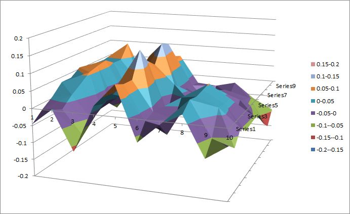

                          Andrew Entwistle
                            @andrewentwistle
                            Hi Joe,
                            Here is a typical result on my machine from mesh bed levelling (10×10 matrix over about 200mm x 220mm) using a touch probe.
                            The probe itself is repeatable to better than 10um depending on speed. My machine has a single z-axis leadscrew on one side, driving a carriage based on delrin v profile wheels running in extrusions, so the limit on flatness is a combination of the aluminium bed flatness, perpendicularity of the z axis carriage and the y-axis which runs on a single linear bearing rail.typical bed topography.jpg
                            Edited By Andrew Entwistle on 05/05/2020 13:35:38

                            Roger Whiteley
                              @rogerwhiteley62172
                              Someone is a master of Excel smiley – I've never bothered trying to measure the flatness of any of my print surfaces – whilst I'm sure having a map in the mainboard and slicer might help, there are generally other more important things to worry about, like getting prints to stick. Which brings me onto…

                              Andrew Entwistle
                                @andrewentwistle
                                Hi Roger,
                                The map is just because I can, the bed is levelled manually well enough. The value of the touch probe is that I can swap between bed surfaces without having to change the z-offset value. Even with >100C bed temperature and having an enclosure I have never been able to print anything larger than about 10cm in ABS without the edges lifting, despite coating the surface with ABS dissolved in acetone first.
                                Andrew.
