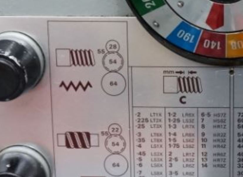

      I am trying to cut a thread with a 2mm pitch on a Colchester Triumph.
      It has a 6mm pitch leadscrew, so I thought it would be straightforward.
      I have set all the levers for 2mm pitch – C LR1Z, if I remember.
      The thread that is cut is a bit off. I tried it on a long piece of stock and measured it to be 1.928mm pitch.
      When I try a second pass, using the same number on the thread dial, it usually cuts in the wrong place. Not surprising, if the pitch is off.
      I have carefully checked the change gears and they are as shown on the plate – 28/55 and 54/64.
      I have also checked that the thread dial has the correct 16 tooth wheel installed.
      Does anyone have any ideas what I am doing wrong?

          #547320
            Try it with the 28 driving the 54 and the 55 driving the 64 which is what teh front plate shows

              Many thanks. Cross slide and compound handles have sliding sleeves on the dials for dual units.
              Here is the thread dial. Units are all mm, so would seem to confirm metric leadscrew.
              thread dial
              I shall have a look for a manual.

                  Interesting point. Diagram is rather ambiguous. I shall try.

                      Brilliant, Jason! Turned the idler around and I now have perfect 2mm pitch threads. And of course you can engage the half-nut anywhere.
                      Thank you so much.

                          Glad you got it sorted. With that ambiguous drawing on the lathe front, I'll wager you were not the first to fall into that trap.

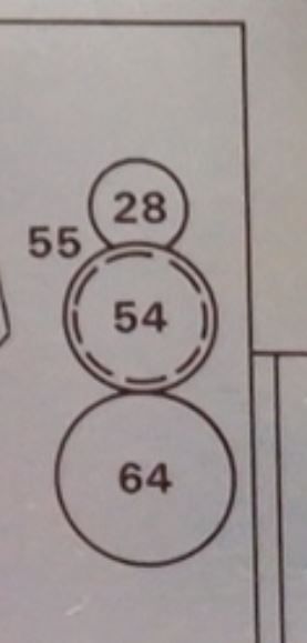

                            Why do you say it's ambiguous? Do not just glance at it. It clearly shows that the periphery of the 64T touches the 55T and the periphery of the 28T touches the 55T as Jason pointed out.
                            #547362
                              Not quite what I said look closer KWIL the 28 goes behind the 55 and touches the dotted 54. But should be clear enough to anyone stood in front of the machine unless the plate is badly worn

                                Trendy mid 1960s graphic design … Gears shown with no teeth, just pitch circles

                                      The lower gear train is for cutting Module and Diametral leads on the Colchester Triumph lathes.

                                        Thanks for the education ‘D’ yes
                                        So … is the graphic supposed to represent a worm, or what ?
                                        #547452
                                        D Hanna
                                          @dhanna35823
                                          That is it MichaelG. Also the chasing dial gears supplied on the metric 2000 : 14, 16, 18, 20 and 22.
                                          #547458
