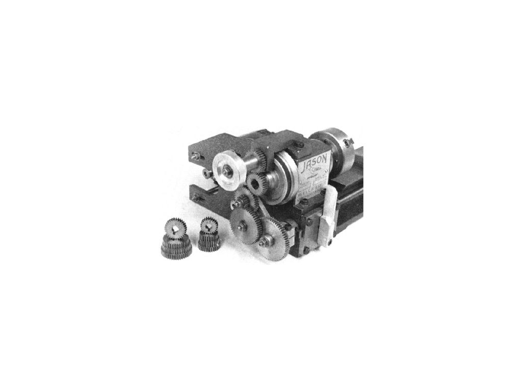

      I am well-aware that I could draw the item from scratch, in less time than it has taken to compose this post.
      I set myself a little challenge, and I have failed … so I turn to the forum for guidance.

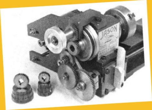

      So far as I am aware, the only available picture of the ‘screwcutting attachment’ for the Jason lathe is here:
      **LINK** http://www.lathes.co.uk/jason/
      I want [want, not need] to fit that image to an Isometric Grid … but no matter how I ‘transform’ the perspective, I cannot get it to align in all three isoplanes at the same time.
      Now: The object has lots of 90° corners, and we know that the movements on a technical camera could square things up [*] … so why can’t I fully ‘de-perspectivize’ the photograph ?
      [*]  **LINK**
      https://www.properproof.com/largeformat/Guides/CalumetDigitalGuide1%20(2).pdf
      Edit: Here, for anyone who wants to play, is the photo … re-sized and put on a large ‘canvas’

            Could the image you are working from already have some distortion or have been tweaked by a camera? May even have had the format changed at some time.
            There is also the problem with draft angle on what looks like a cast bracket so your 90deg corners may well be 93 or 87

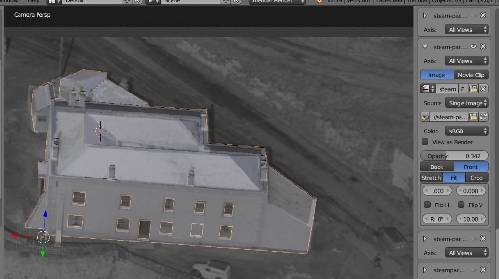

                    I've tried something not entirely dissimilar when trying to find dimensions for railway vehicles and buildings that are no longer with us.
                    My first attempts involved measuring the photo and trying to use trig to determine the unknown dimensions from the one that was least uncertain. I thought it should be simple but I could not make it simple or get it to produce sensible results.
                    My approach now is to take advantage of the fact that I need to make a drawing anyway and then create a 3d model in whatever tool, export it to STL and then import that to Blender. With Blender I can then guess the relative position of the camera and the subject, guess the focal length of the lens and attempt to reproduce the perspective in the photo. The photo can be imported as a background and I can move the opacity slider to compare the two. The same model can be used to overlay multiple photos from different angles if you have them.
                    Blender takes time to learn but overlaying a photo onto an existing STL is using a tiny part of its features so you only need to learn those parts.
                    See below for an example of a building. It's the Steam Packet Inn in Hayle and was demolished in the 1960s.
                    I have not tried to use isometric projection as an interim step TBH.

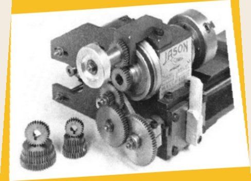

                      This is tweaked, I haven't spent a lot of time on it so it could be done better.
                      It was rotated 3° to get the verticals correct then pinched about 10% to get the parallels more parallel followed by a 105% vertical stretch.
                      Martin C
                      PS. I think a about -10% vertical perspective adjustment should have been done to get the verticals parallel but forgot that bit.
                      Edited By Martin Connelly on 02/06/2021 08:50:30

                          This is with the vertical perspective tweaked. The problem is as you adjust one thing the previous changes get put out slightly which is why some experiment is required to get the best overall result.
                          Martin C

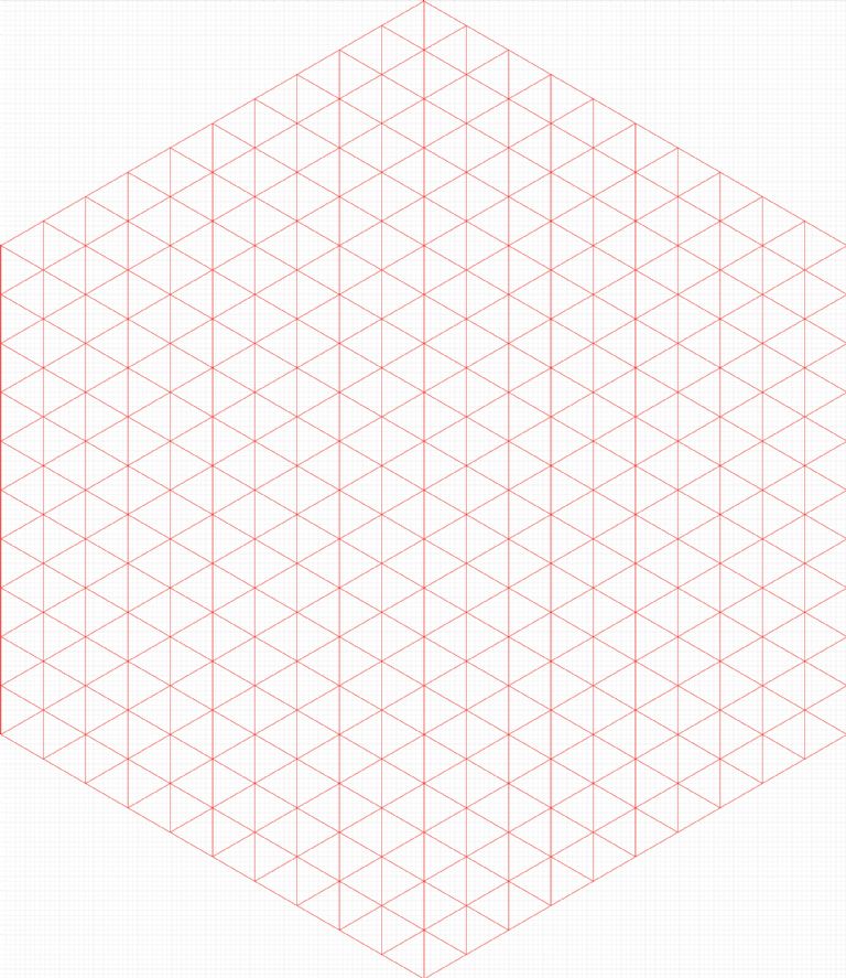

                            Thanks, Martin … we’re on the same track
                            But have you compared the resulting angles with an isometric grid ?
                            In true ‘Blue Peter’ style … Here is one I prepared earlier:
                            Edited By Michael Gilligan on 02/06/2021 09:21:13

                              I didn't go that far but once the various edges are parallel then a bit of tweaking of the vertical or horizontal scale and the rotational angle should allow you to match it up. It may need some skew to get the various angles all matched to your grid. It will not be possible to get a perfect match to a symmetrical grid since the original picture was probably not taken from a suitable position. As pointed out light does not go round corners so if the picture was taken from a position to the left or right of the line at 45° to the spindle axis (I think left in this case) you would probably better off using an asymmetrical grid and save some headache.

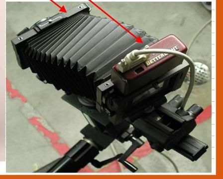

                                Another tricky problem from Michael!
                                This shot from Michael's first link suggests why the answer is hard:
                                The type of camera that may have been used to photograph the Jason is adjustable in all three planes, and is positioned and tilted by the operator relative to the target to control perspective and lens distortion. He adjusts images by eye so they look good, rather than them being geometrically correct. Getting back to isometric means first undoing the unknown camera corrections, and then removing perspective and lens distortions; the lens is also unknown.
                                Problem is still difficult even if an ordinary camera was used. The camera sees a perspective image because the object isn't flat. Big cow far away and model cow close up are the same size, making it possible to take photographs like this, which I think are impossible to lay on an isometric grid and recover the dimensions.
                                In the Pisa example, in translating a 3D image of the tower and girl into 2 dimensions the camera has lost the information that tower and girl are on entirely different scales. Although the Pisa example is extreme, the effect also applies to smaller objects like the Jason. It's easier to work with flat photos and stereoscopic pairs than a single photo of a deeply 3D object.
                                Martin's on the right track, and as he says 'some experiment is required to get the best overall result.'
                                The camera never lies? Oh yes it does…

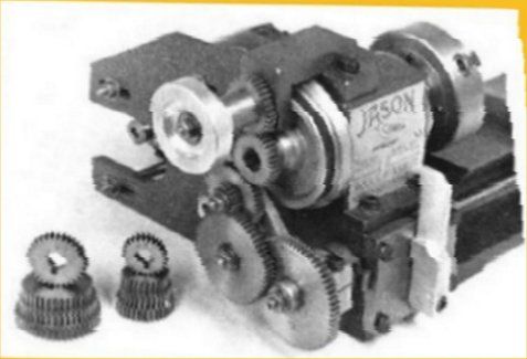

                                  Martin Connelly
                                    @martinconnelly55370
                                    Here is the effect of rotating to even out the angles and skewing to bring the verticals back to vertical. Then stretching the width to get shallower angles. The quality of the picture just decreases with every geometric adjustment.
                                    Martin C

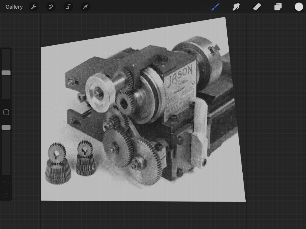

                                      For general info.
                                      This is what you can do [quickly and interactively] with ‘free transform’
                                      This is a screenshot from Procreate; but the functionality is available in Photoshop and other software
                                      ‘Get your eye in’ and you can see that as a rectangle on a tilted plane.
                                      The result should be directly equivalent to using swing/tilt on a technical camera.
                                      But the little Demon on my shoulder is whispering : Does it also replicate rise/fall ?
