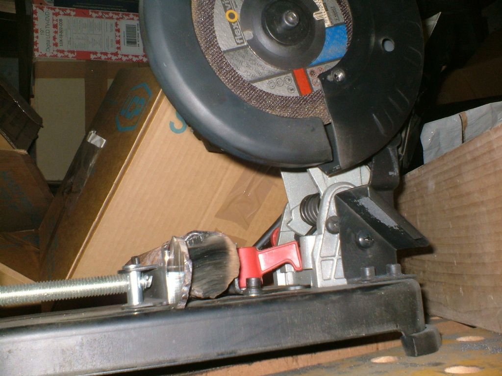

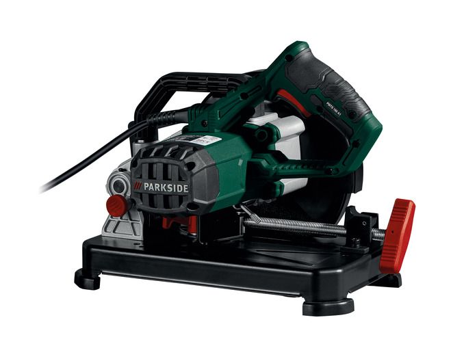

                    Bought Lidls fixed angle grinder yesterday and I thought I'd share
                    The main reason I'm posting on it is its portability and adaptability
                    Behind the electric cord is a second black lifting handle so you can lug it outside like a toolbox and put it on an extension outside or in the garden(away from the carrots etc of course).
                    When I got it I stuck a bit of 40mm rebar in and set it off, and away it went
                    and went
                    and went
                    At first I thought "oh dear me I've bought a lemming" (or various unprintable words to that effect)
                    On closer inspection the metal cutting disc was probably too thick, even a 1.6mm disc has to do 60% more work than a 1mm disc, which is my preferred hand held angle grinder option
                    I cant find 1mm by 175mm discs but I've ordered 150mm ones, I only use stainless steel cutting disks, 115mm from blue spot have been really good for me
                    #342575
                    Ady1
                      @ady1

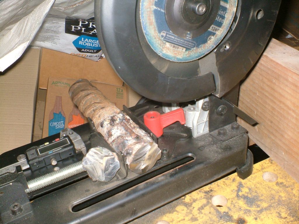

                      So I took out the parkside disc, stuck in a 115mm blue spot, the grinder spindle is a standard 22mm affair, removed the internal stop to increase the cutting depth to about an inch and a bit and went after my rebar again
                      Pure doddle, took 5 mins to do 3 cuts on the 40mm rebar with an undersize disk, turning the bar between cuts
                      The cuts took seconds, most of the time was spent lining up between cuts

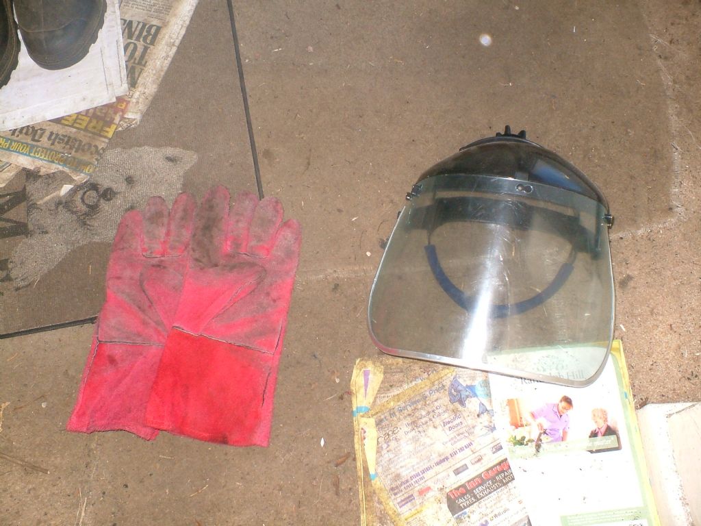

                        It gives you a nice fast and very portable alternative to hacksaws and is rated to 50mm
                        Apart from my fluffy cocktail dress and high heels I use welding gloves and a full face mask as recommended by the chaps in here(in this thread actually)

                                        At last a subject that I know something about. In the past I have built two steel sailing boats therefore an angle grinder became a tool of necessity. Here are a few things that experience taught me.
                                        Wear overalls, steelcap work boot with leather laces (they don't melt like the normal laces), cotton socks same reason as the laces, leather welding gauntlets, hat, full face mask and a cotton neckerchief (grindings get everywhere).
                                        Make sure that there is nothing in the surrounding area that is combustible (that includes carrying a paper tissue in the top pocket of your overalls).
                                        Grindings will fall off your clothes into places where they will cause trouble for you (toilet bowl, sink and shower tray).
                                        Crunchy sandwiches and gritty tea, ah happy days.
                                        So take care a angle grinder is a great tool to have and use, but it needs a lot of respect.

                                              Got the 150 x 1mm discs this am
                                              They cut a max of 40mm with the stop removed in 60-90 seconds, so 3 inches if you come in from each side
                                              Not even that noisy, Wish I'd done this years ago
                                              (The garage does smell like the hoose is on fire though)
