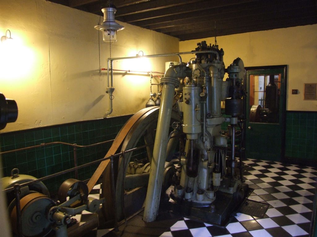

                  Posted by Howard Lewis on 15/01/2018 12:49:18:
                  If you want to see an example of Dr Rudolph Diesel's engine, made by Sulzer in 1913, visit The Museum of Internal Fire, near Aberystwyth. If you are lucky, they may even set it running, (takes about 10 minutes to build up air pressure for starting and injection).
                  Gentlemen,
                  I used to regularly volunteer at Internal Fire Museum of Power and have an amusing tale about the Sulzer, when Paul Evans was setting up the Museum he was approached by an Electricity Company who asked if was interested in an old water pump at one of their sites so he went along to have a look and found that they were offering the Sulzer as the old pump, Paul couldn't believe his eyes as there are only a couple left and his is the only one in the UK.
                  As already stated it takes a while to get the compressed air up to pressure to start and then there is a lot of lever pulling before it will run on its own but its a lovely engine.
                  The Museum can be found in the village of Tan y Groes half way between Aberystwyth and Cardigan.
