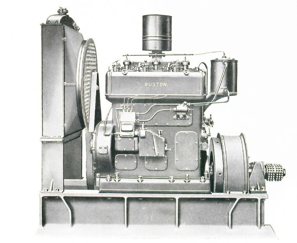

                  I should have provided a picture, this one from the Ruston-Bucyrus literature. This engine was developed around 1940 and was supplied for the war effort. For itrs primary application it was required to run at its rated speed 950rpm for a full working day, being started at clocking-on time, revved up to its working speed and kept there conmstantly unti kn=bocing-off time.
                  Reliabilty was the name of the game.
                  I have much of the currently available data about this workhorse but as some of you have remarked there are some difficult items to produce, especially the fuel delivery mechanism.
                  Thanks Phil for the ME Index. I will implement a search.
                  Jerry
                  #336593
                  Monoman
                    @monoman
                    Here is the picture –

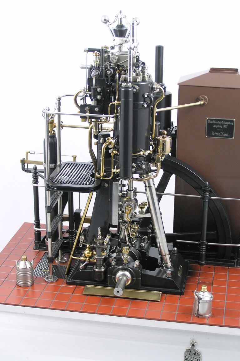

                              I don't think the lister in George's video was running as a true diesel as he was using model aircraft fuel and got it going as a compression diesel.
                              Our forum member Johan Van Zantan has made a very good true diesel and I think the injector runs at something like 150bar, it was featured in ME a few years back
                              There are some more photos in his album
                              Edited By JasonB on 14/01/2018 17:43:34
